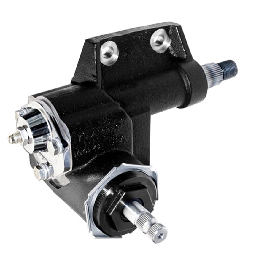

Hi everyone my 70 cuda resto project came with a manual box was thinking about going with the quick ratio box does anyone out there have one in their car and do you like it . I have a 67 B body with stage 2 power steering and do not like it wish I went with stage 3

I assume you know there is no quick ratio box without power steering & the quick ratio was a longer pitman arm

I have a MP 20:1 manual chuck in large spline (C-Body/B-Van) factory box on my Challenger.
With a 440 in front, you plan your 3 point turns. Underway it's fine.
Biggest problem is the there is a select fit for one of the internal bits that minimizes the dead center - if not size on size you get a bit of slop even with the sector adjusted correctly. IIRC it had something to do with end play on the chuck itself.
I think they are or were not available when I did mine.
I'd be tempted to go to a Borgeson but I wish it took the standard slip coupling.
