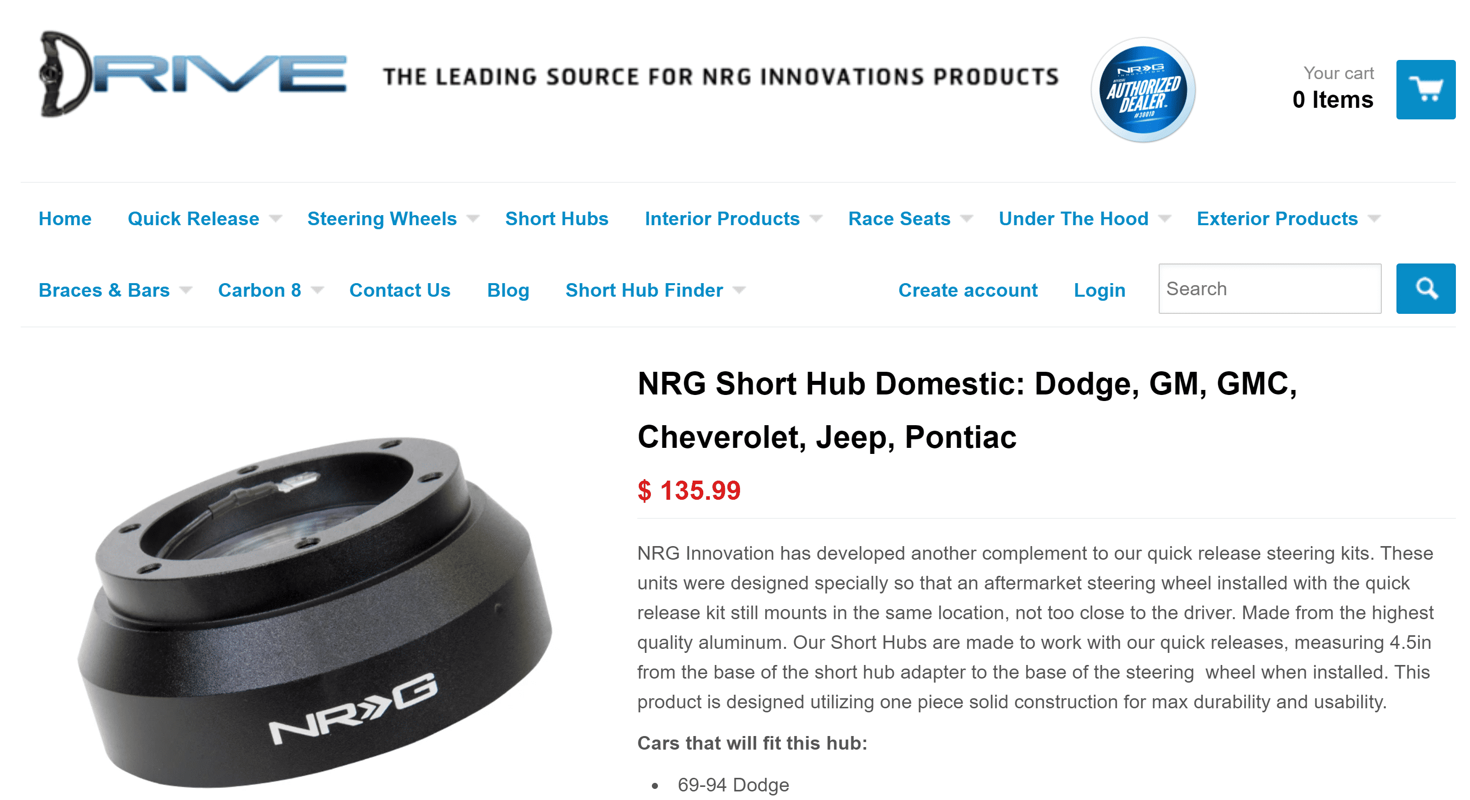

Missmopar70 - Check out the NRG short hub adapter. I recall that NRG uses the same 70mm six bolt pattern as Momo, so this short adapter may be your answer.

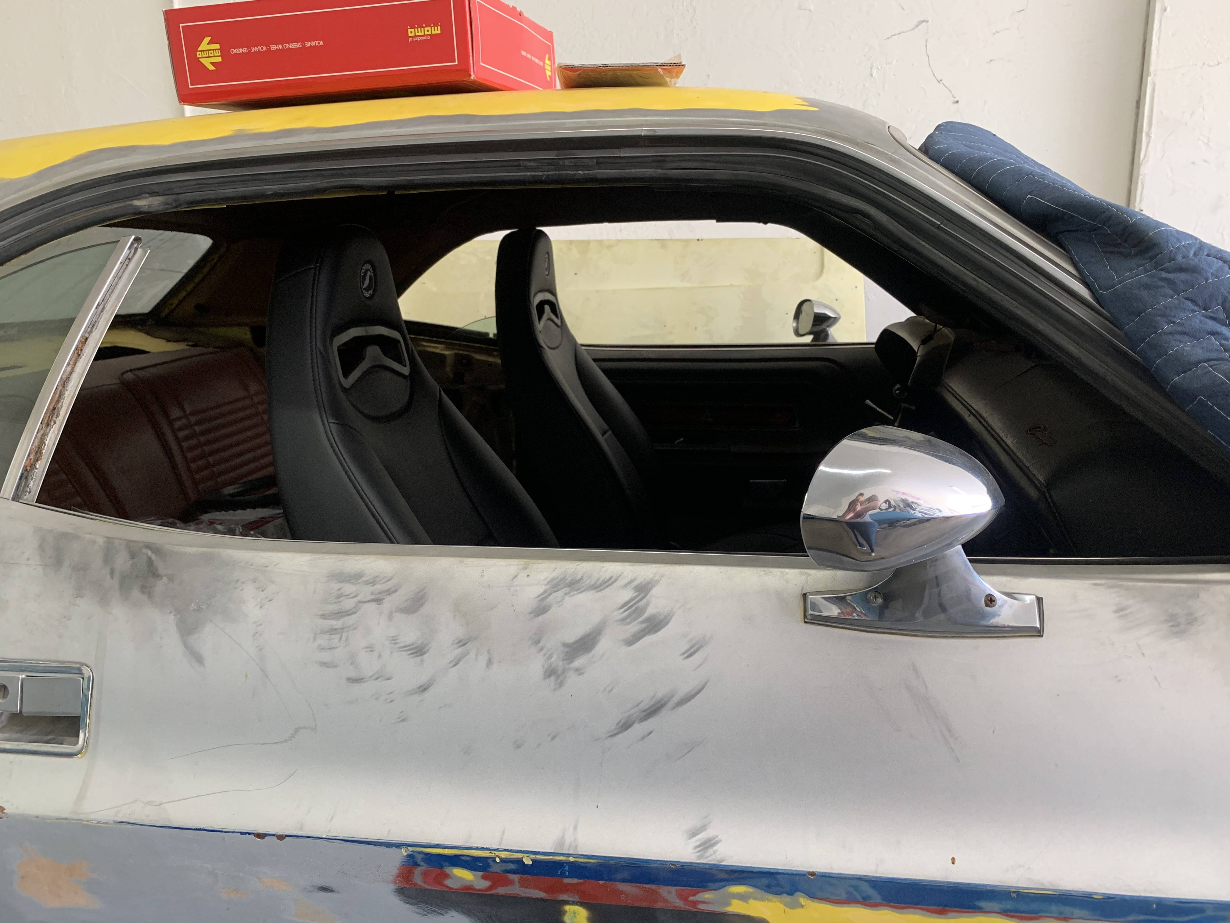

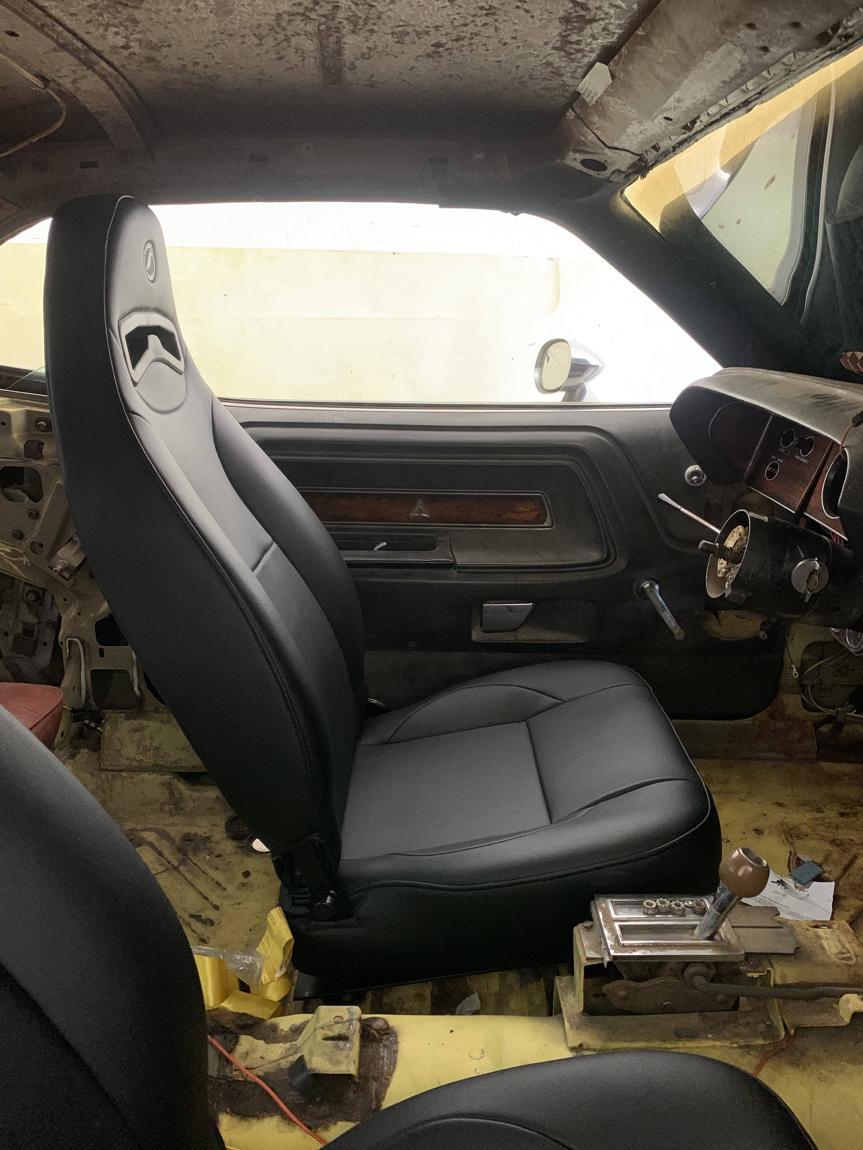

Here are the seats in the car. She’s obviously a work in progress! 😬

The Corbeau seats look great in your car! Of all the aftermarket seats I have researched, the ones made by Corbeau seem to have a shape that is closer to stock and look better than most of the other choices.
Every car is a work in progress if it is owned by a person who enjoys modifying and improving it. My Cuda has been a work in progress for as long as I have owned it, and that is now 44 years. The problem is that I need time, space and money, and never have all three at the same time. And, if I gain one I lack, I lose one of the others.
Did you decide on an adapter for the Momo wheel? Will the NRG adapter work?

I stumbled upon one from forever sharp that I’m going to install next weekend. I will post a picture when I do. Thanks again!
