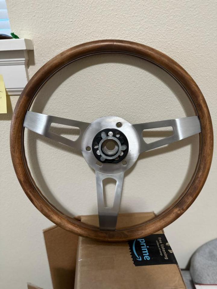

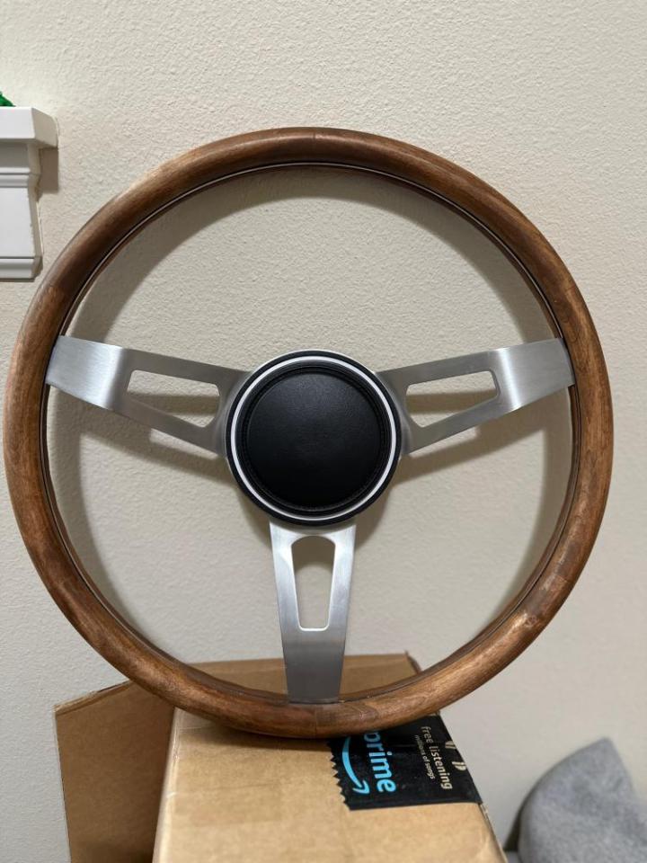

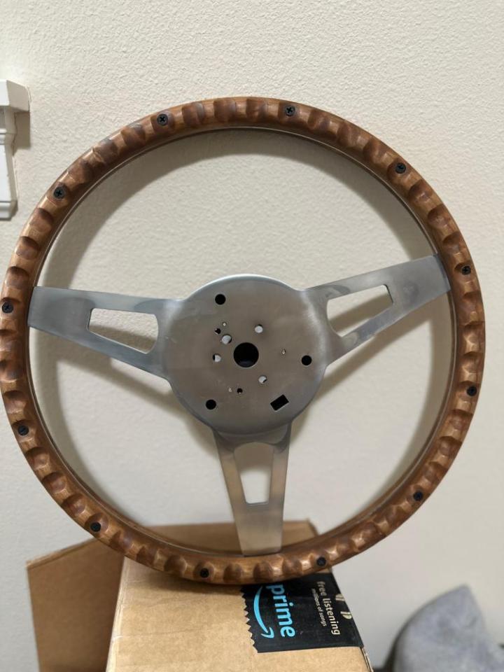

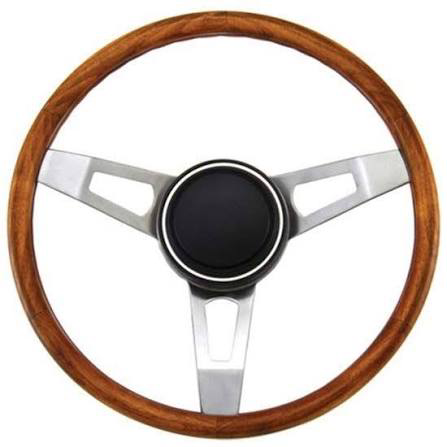

Is this a 15 inch wheel? Nice looking wheel.This is the Grant 246 wheel. It fits without modification to the E-Body crush collar "studs" and uses the factory acorn nuts.
View attachment 154092 View attachment 154093 View attachment 154094
Yes, the Grant 246 is 15" diameter.Is this a 15 inch wheel? Nice looking wheel.

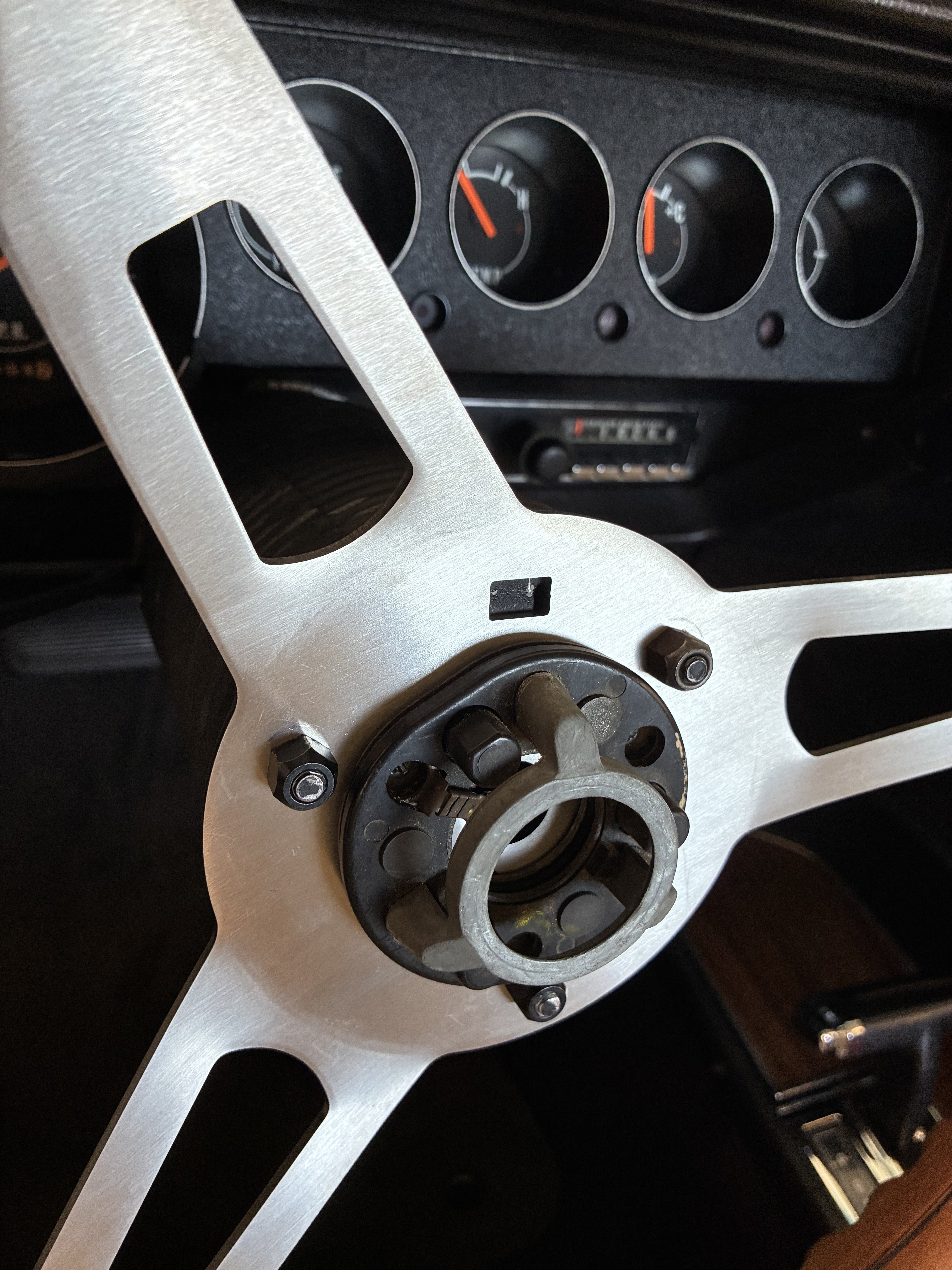

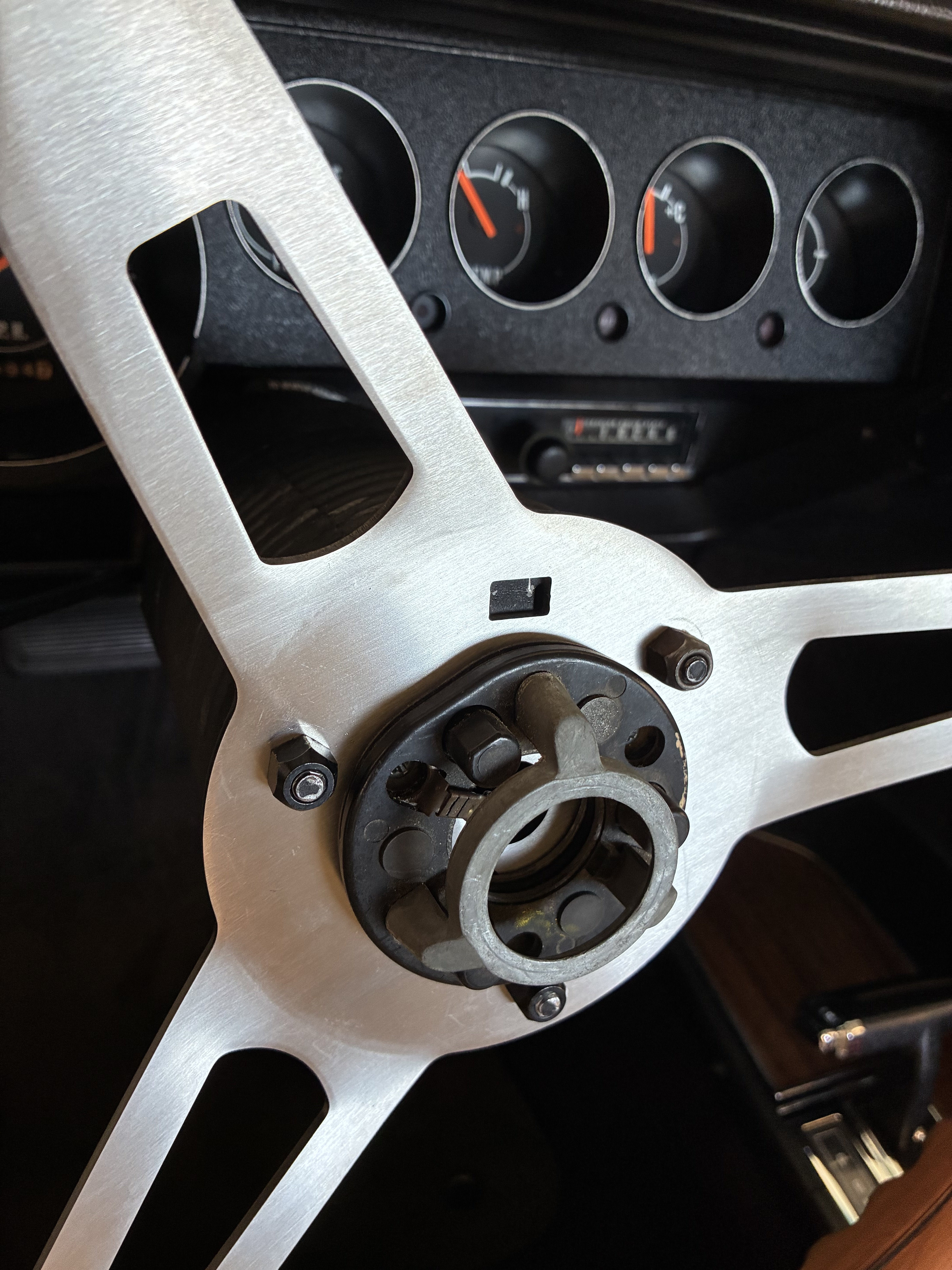

I have the same wheel but I can’t get the horn cap to fit . I have the original horn switch . Did you use a different horn switch ? I do have a crush can ThanksThis is the Grant 246 wheel. It fits without modification to the E-Body crush collar "studs" and uses the factory acorn nuts.
The three nuts should have the beveled portion going into the wheel spokes.I have the same wheel but I can’t get the horn cap to fit . I have the original horn switch . Did you use a different horn switch ? I do have a crush can Thanks
Thanks. Didn’t realize I had the nuts backwards. I’ll try the old cap.The three nuts should have the beveled portion going into the wheel spokes.
Are you using a factory horn cap?
The Grant generic metal center cap will not work. You need the factory center cap for 71-74 B/E bodies.
