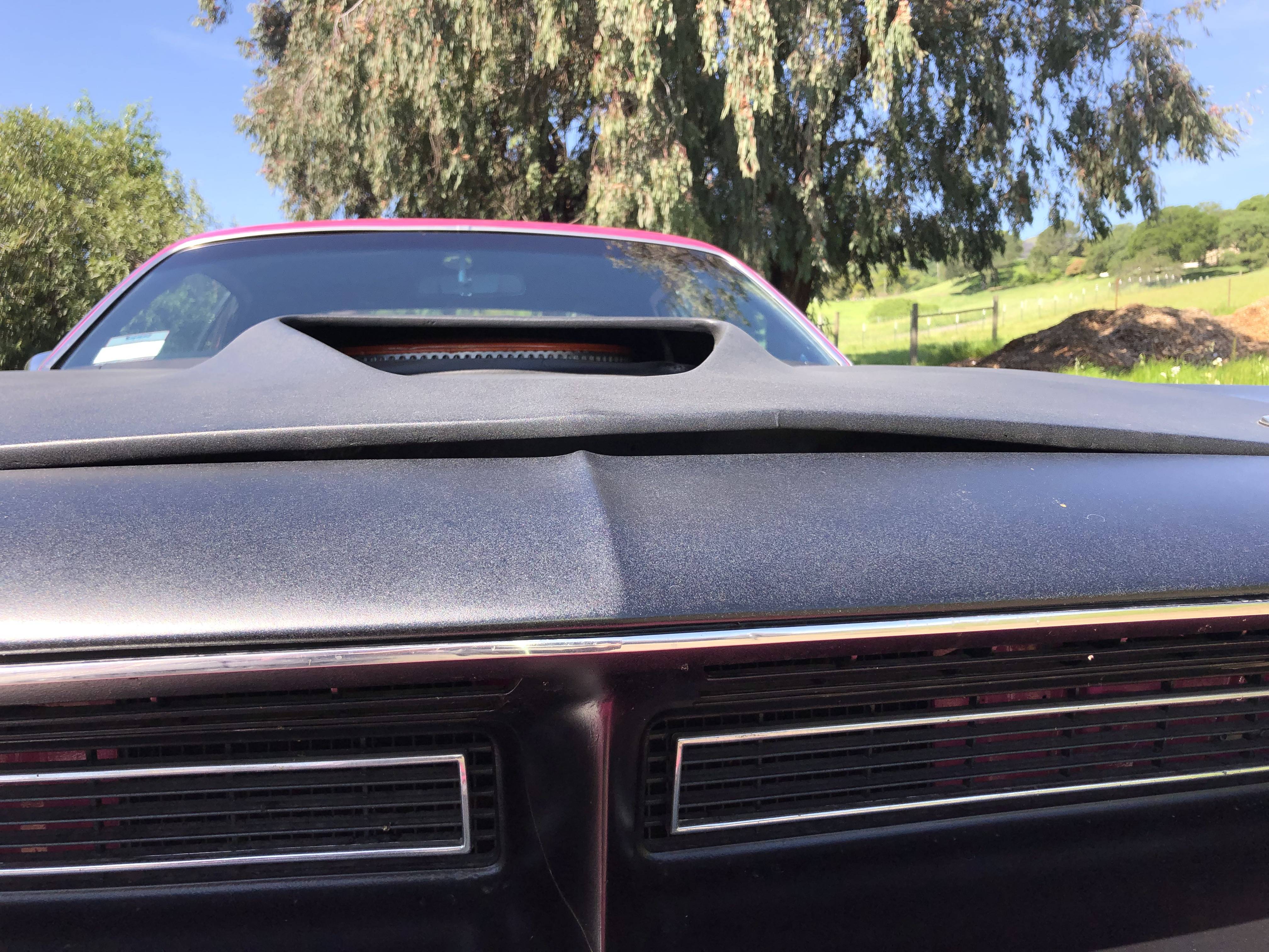

Dumb question, but what is the best way to remove the hood popup spring without destroying the paint around it? I bought my 70 Barracuda with a good Moulin Rouge paint job already in place. It has a YearOne fiberglass AAR hood which warps badly in part because the hood popup spring is constantly pushing up in the center. I started trying to remove the spring but caused a couple chips in the paint and decided to stop trying until i can consult the experts here. What say you?

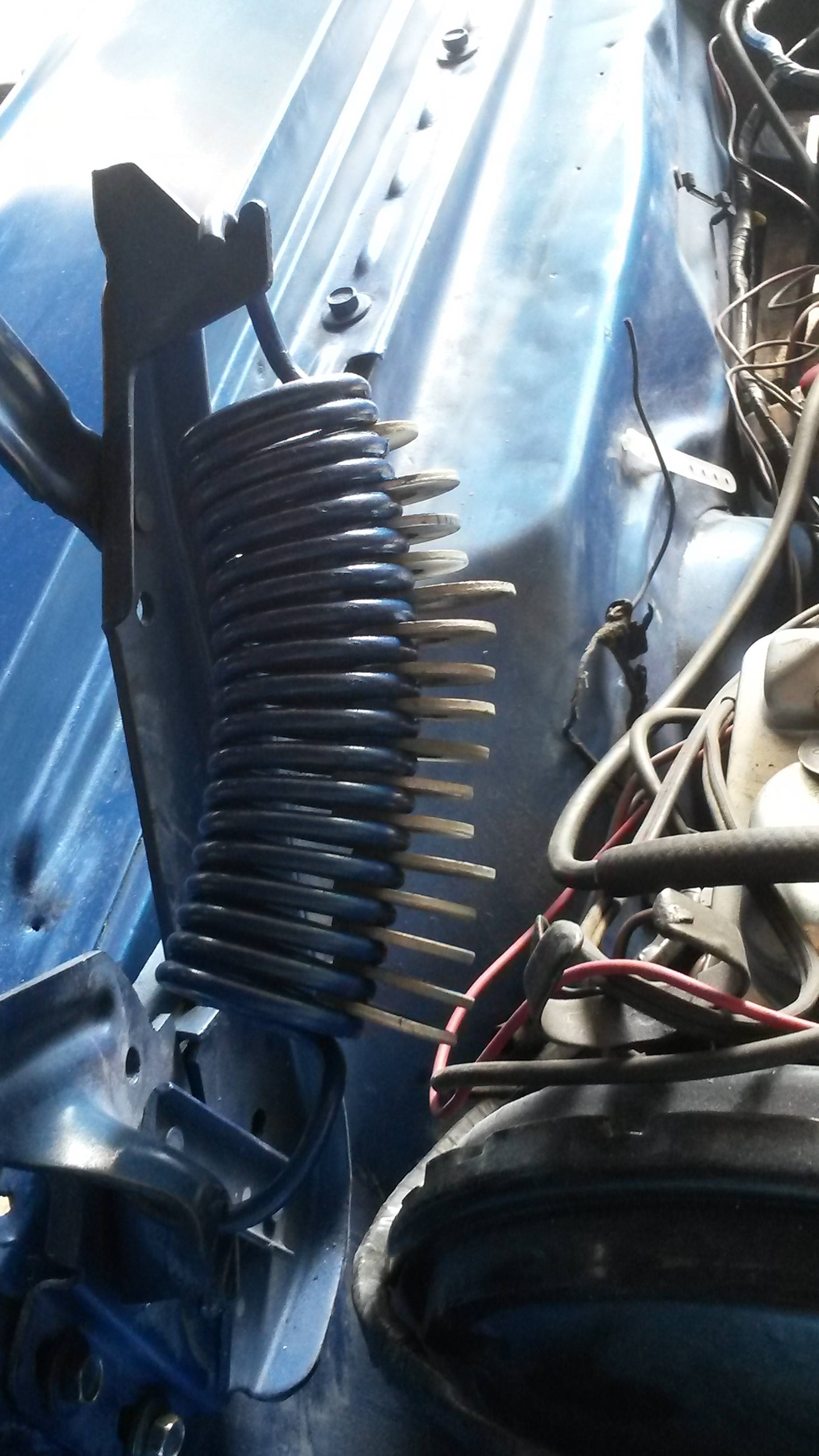

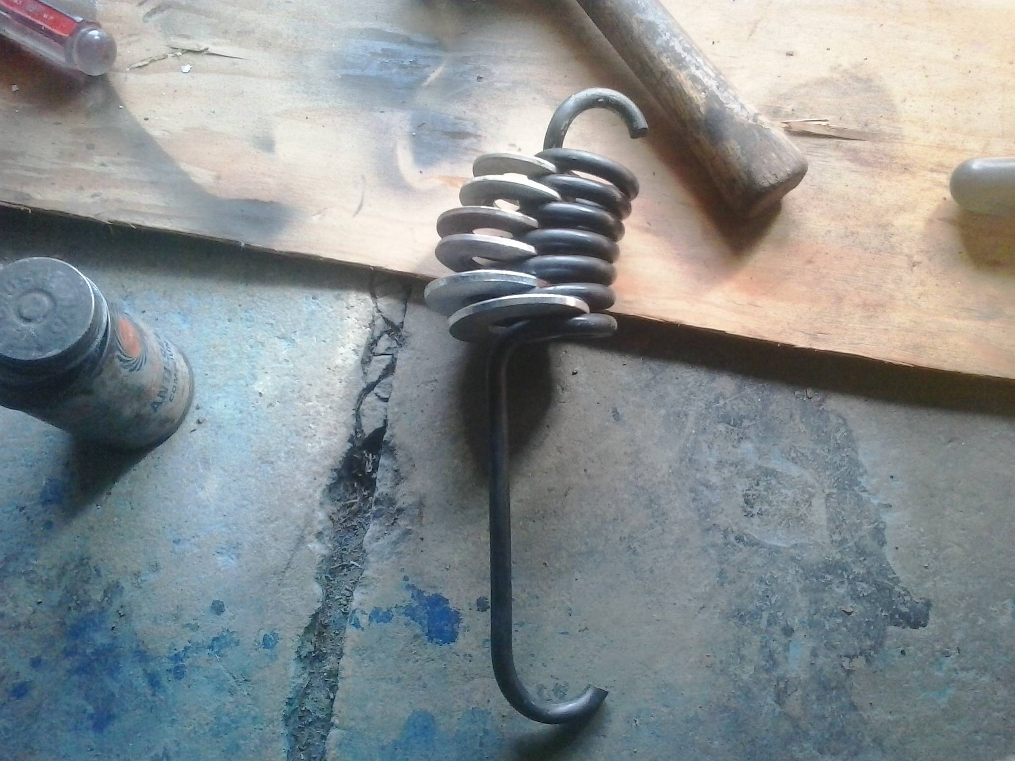

I used a hooked rod and pulled it off. remember to catch weight of hood if still on.And used vise grips. 1st picture used 16 washers and floor jack to put hood hinge spring back on.I had an after thought of open hood a little bit,spring would be expanded.place a washer and slide a rod or screw driver through each washer. when you put it back on and close the hood they fall out like loose change.
Did the same for the clutch spring.

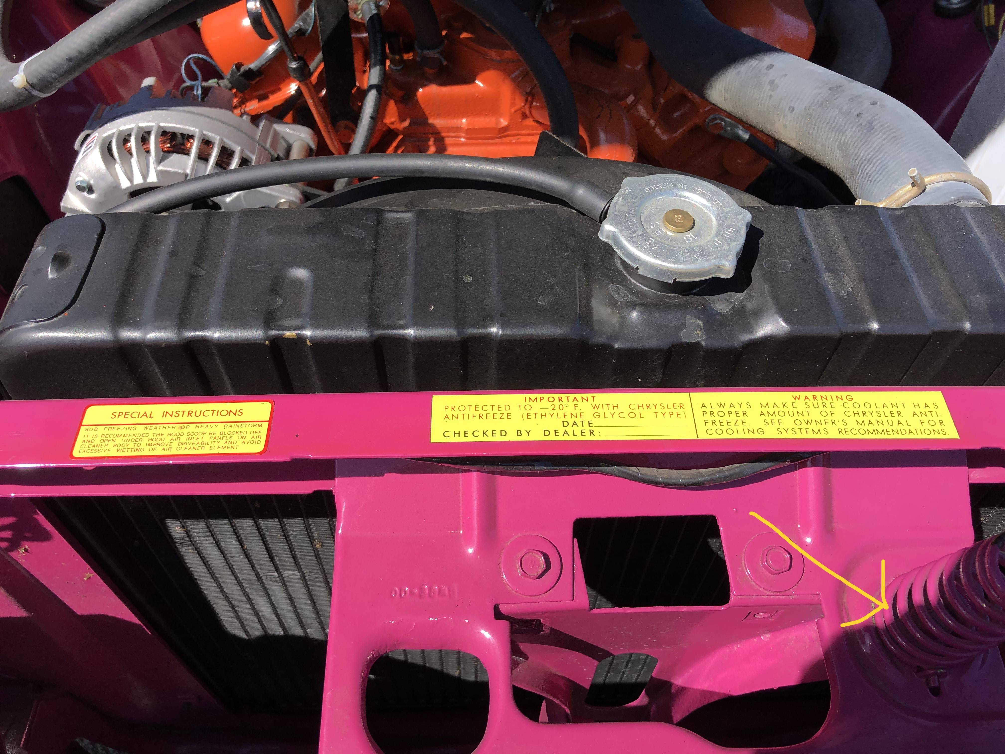

this is the spring I want to remove without damaging the paint further.

Yeah my bad.thinking of the hard thing to do.I do not see or know of any way of doing that with out flaking the paint. There is a technique I use for save paint or clear finish.Use a razor blade or knife and cut the paint.You might minimize damage.Is the paint original paint.Spring being painted?

Look down inside the spring to see the tab. you may need a dab of paint on the tab when done. Why dose the spring have to come off?

I like that idea, but I think just the current spring pressure alone is warping the hood. The top of the spring is only causing minor damage to the under side of the hood. I could deal with that if it didn't warp.

Due to the design I don't think you will do it without taking some paint off.
Bend the little tab up and go.
Pencil touch with a small brush.
