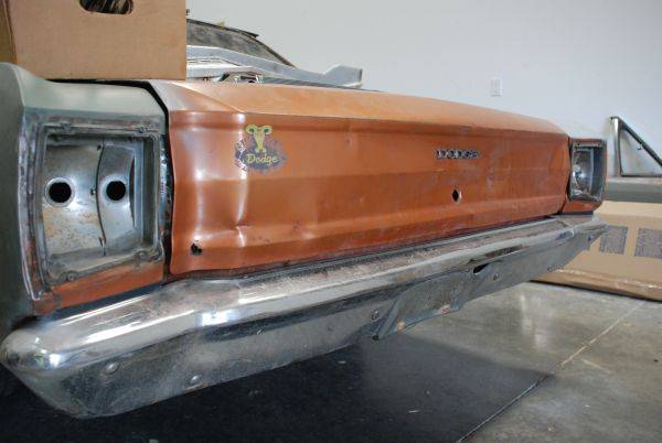

The car has a Mr. Norms decal (old been there for years) on what looks to be the original paint. The decal is located on drivers side trunk lid.

The sticker on the trunk is a good sign but not a 100% thing.

I'm going to give Larry (cant remember last name) a call and see if it was a Mr. Norms car and if he has any paper work. The decal is very aged as if it was original I will post a pic.
