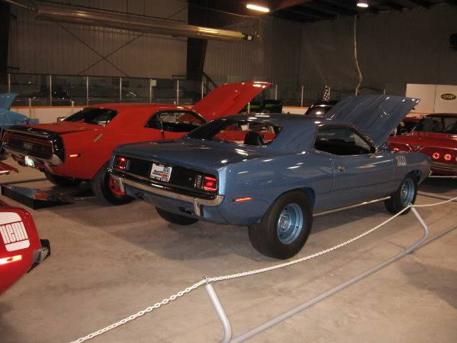

Question:
Will 295/65/R15's MT Drag radials on factory cop car wheels fit under the rear of a factory 1970 Cuda? If not what are the largest tire size that will?
I am assuming there is only one backspace for these wheels, I believe they are 4.5?
I am guessing everything is stock on the car. I would say most likely. Your springs could be dropped a little if they are original, etc. The best way to know is to try them on.
Yes, at this time everything is stock.
Are you referencing sagging springs?
The plan is to try them on.
I would be surprised if the 295/65 fit with stock spring location and stock cop rim. Test fit and see. Check both sides. Tires will likely rub somewhere. I also think the cop rims are too narrow for the tire.
I have 295/65 with springs moved in 1", the wheel well lip massaged a bit, cop rims widened to 8", and custom offset. Still snug, but no rub.
