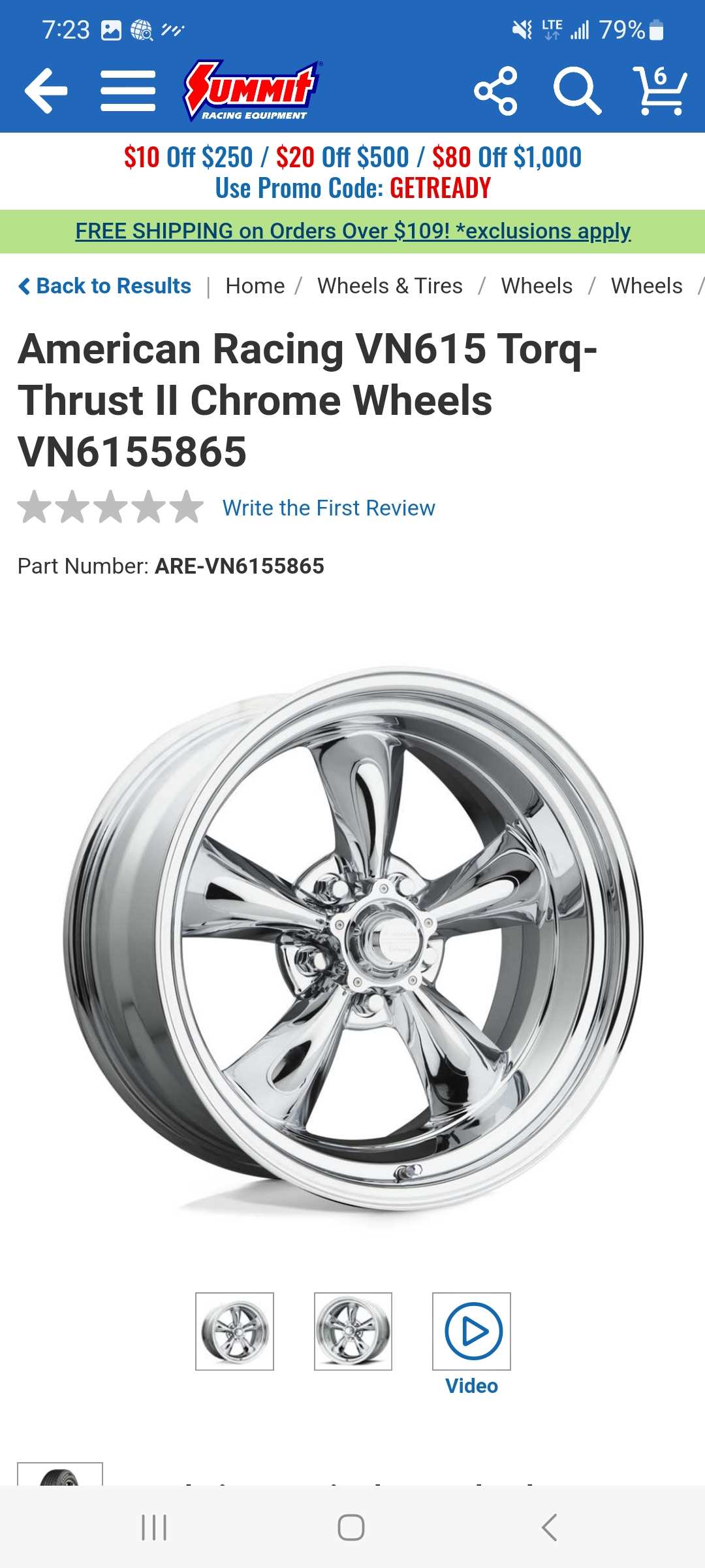

I'm trying to order new wheels and tires for my 70 Challenger, but the rear seems to be fine, but I'm concerned about the front wheels and tires.
The wheels and tires you are trying to install are
・American Racing VN615 VN6155865
15×8
Backspace 3.790 in
VN6155866
15×8
Backspace 4.50 in
Tire size 225/60/15
If I install either of these wheels and tires and move the steering wheel left or right, will it interfere with the frame or chassis?
The front brake has been upgraded to a disc brake.
Please let me know your opinions.

The 70 Challenger wants zero offset, so VN6155866 would be the correct wheel. The VN6155865 might rub the outer fender.
225/60R15 tires will work fine on the front.
245/60R15 tires might fit the 15x8 wheels better.
Also, if you would like to put bigger tires on the back 255/60R15 tires would fit easily.
