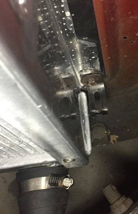

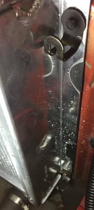

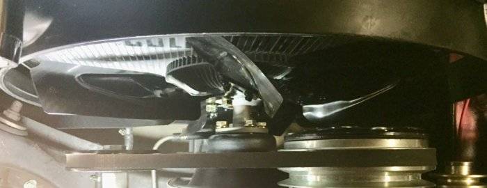

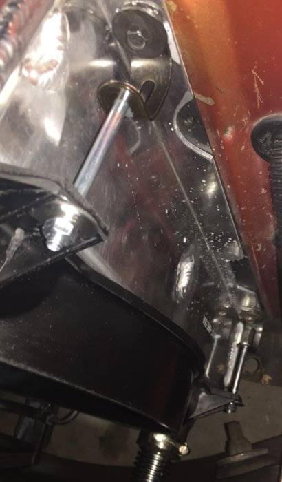

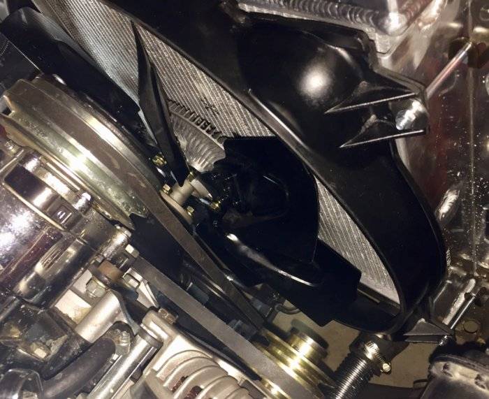

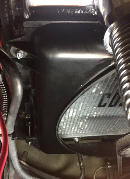

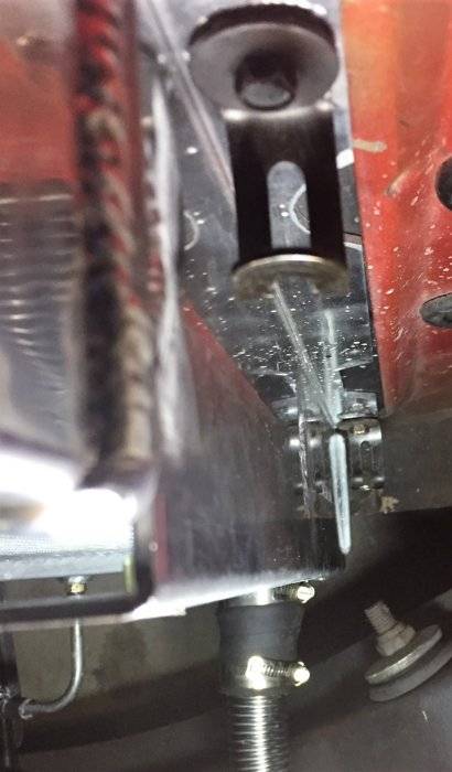

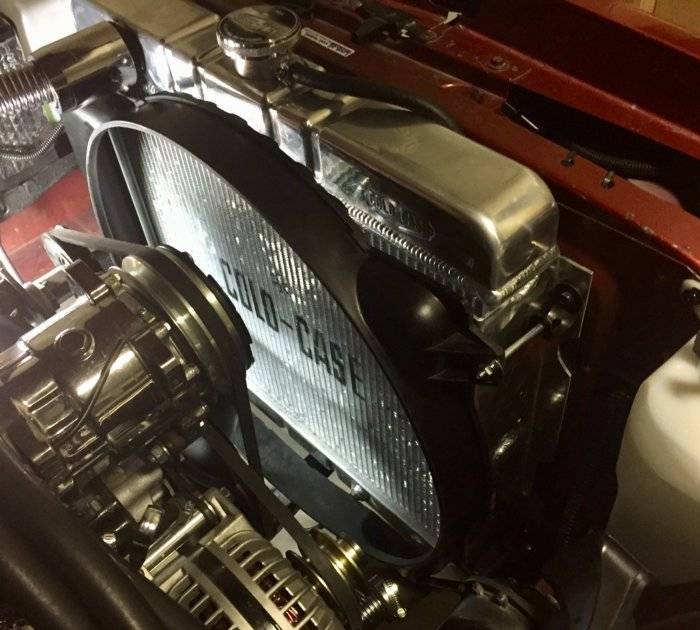

Tightened a leaking return automatic transmission cooler line and now figured out how to install an OEM fan shroud to my Cold-Case Radiator.

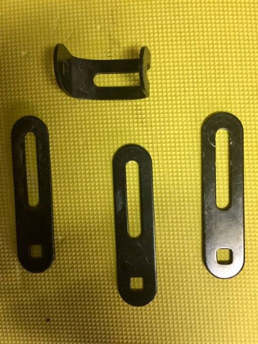

Customized brackets from a Wink Mirror, four 3.5" bolts and installed OEM fan shroud. Depending on brackets, bolt size would vary of course. Longer brackets would eliminate bolt use to screw use instead.
Here is what I did and for the moment very satisfied with it.
Maybe Cold-Case can use this for some ideas.

That's impressive! I think what we'd do in the future is add a wider flat stock bracket so the shroud can bolt directly into the radiator all on one plane.

I knew you would say that and it makes way more sense LOL LOL Plus would look as it should.

We have one of every available Mopar fan shroud coming in. Over the winter, one by one, we'll be making sure our radiators will be able to use the factory fan shrouds.
