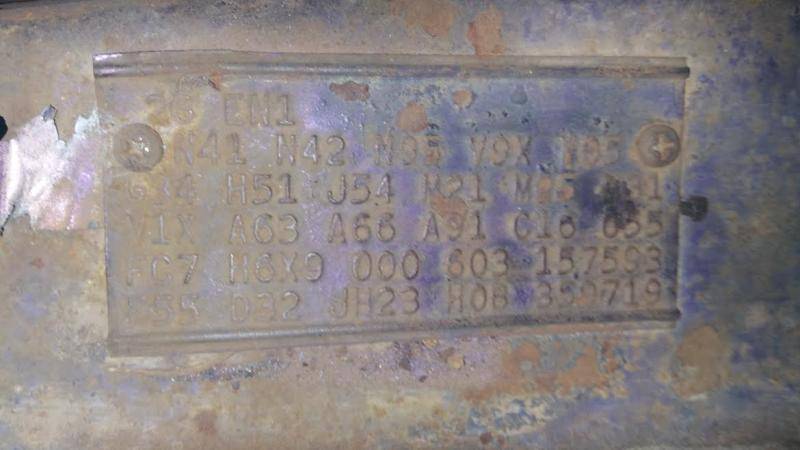

WSS 340 Challenger ....fender tag
Post a pic of the fender tag.
wss340challenger
Aug 13, 2015
62
1
camarillo, cal.
any thoughts on the piece of aluminum poking out from the left side of the tag ? there are numbers on it but I need to go back and read them

V9X is a black transverse stripe aka bumblebee or rump stripe and A63 is a moulding group and doesn't denote that it's an SE.
