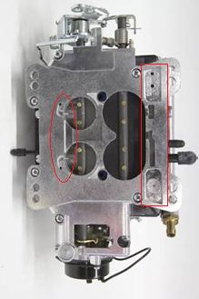

The factory 340 cast iron intake manifold is a square-bore and used a a Carter AVS square-bore carburetor. The primary bores in the intake manifold are 1.44" (just over 1-3/8") and the secondary bores were 1.69" (just over 1-5/8"). The Holley Street Demon 1900 is essentially a three-barrel having two primary throttle blades and one large "goggle" secondary throttle blade. The Street Demon primaries are 1.375" (1-3/8") which will clear the intake manifold primary openings but the secondary "goggle" valve diameter (see photo below) is 1.747" (essentially 1-3/4"). This larger secondary diameter will not clear the factory intake manifold opening of 1.69" if the carburetor is mounted directly to the intake manifold.

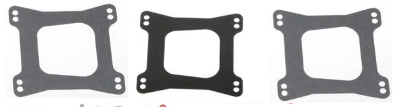

Holley's Street Demon comes with two thin gaskets and a thin steel sealing plate which are required to isolate the idle-air circuits by covering air/blow slots on the base (red oval and rectangle below) and reduce heat transfer from the manifold. Holley Video on Street Demon features
A thicker carb base gasket (5/16") or a thin open plenum spacer (1/2") may raise the carb enough to allow the throttle plates to clear the intake manifold bores AND allow the electric choke housing to clear the intake manifold's factory exhaust-heated chokewell. The electric choke on the Street Demon might clear the 1970 manifold's chokewell but check it to make sure. Either way you will need additional gasket or spacer height for the Street Demon secondary throttle plate to clear your factory 1970 square-bore intake manifold.

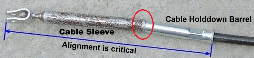

Otherwise, you will need to use a throttle lever adapter to attach your factory throttle stud for your factory accelerator cable (now misaligned) and your throttle pressure linkage (also somewhat misaligned). Your factory throttle cable bracket is not tall enough to get the geometry in line so you may need to bend/extend/tweak the bracket (angled upward) to correct the misalignment. The factory cable is finicky at the junction of the cable sleeve to cable holddown barrel (see red oval in photo below). Good alignment is necessary for full-throttle actuation and proper operation of the throttle pressure linkage.
