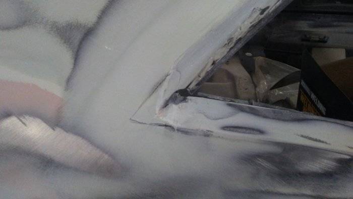

this the area I refer to, with the pencil marks.

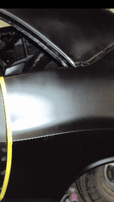

The drip rail does not recess into the body. The body work just follows your pencil line. Here is the only pic I have, but it is with the drip rail in place.

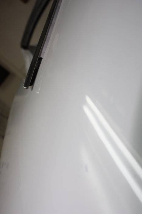

The drip rail actually stops short of the corner of the window. I attached a pic of my car without the drip rail chrome attached. If you zoom in you can see it pretty well. Hope it helps.
