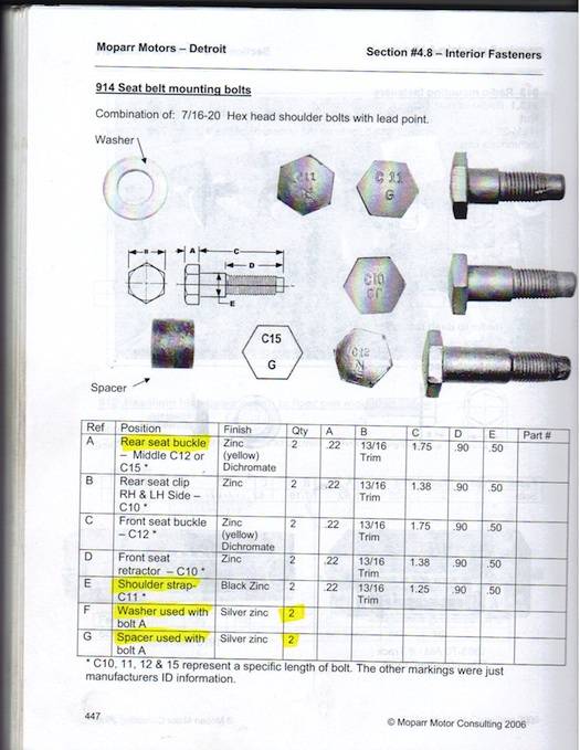

We need to know which part of the seat belts you need bolt(s) for - the retractor or the buckle side. The retractor side uses a C10 bolt while the buckle side uses a C12. see chart for sizing...

So you need 2 C10 bolts and 2 C12 bolts. Not sure what level of condition you are looking for - there are plenty of originals available on Ebay. I know I have extras but not sure what sizes I have. I will try to look in my shop tomorrow to see what I've got...

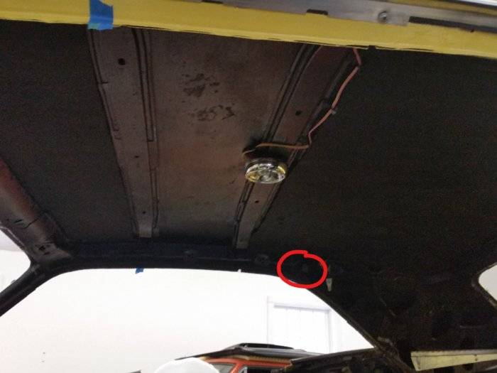

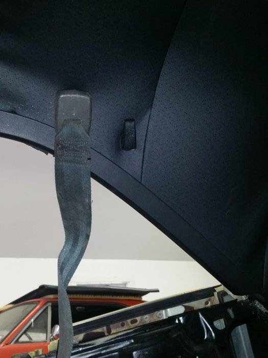

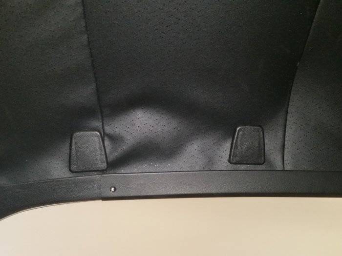

Does anyone have a photo of where the shoulder harness bolts to the roof area without a headliner? My car has the headliner installed so I'm afraid to cut in the wrong place, also need to know the prober way to cut it without causing a tear in the headliner.
Grady Cain
Mar 22, 2014
882
455
NW Connecticut

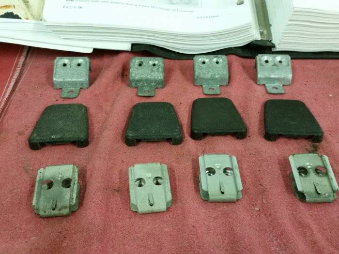

Not the greatest photos but you should be able to get the idea. Just feel around with your finger for the hole which is very close to the coat hook. Once you locate it, use a sharp razor blade to cut a small "x" through the headliner over the hole opening. If your car never had front shoulder harnesses and you want to put stock ones in place, you will need the brackets that hold the shoulder harness up along the roof just above the windows.
