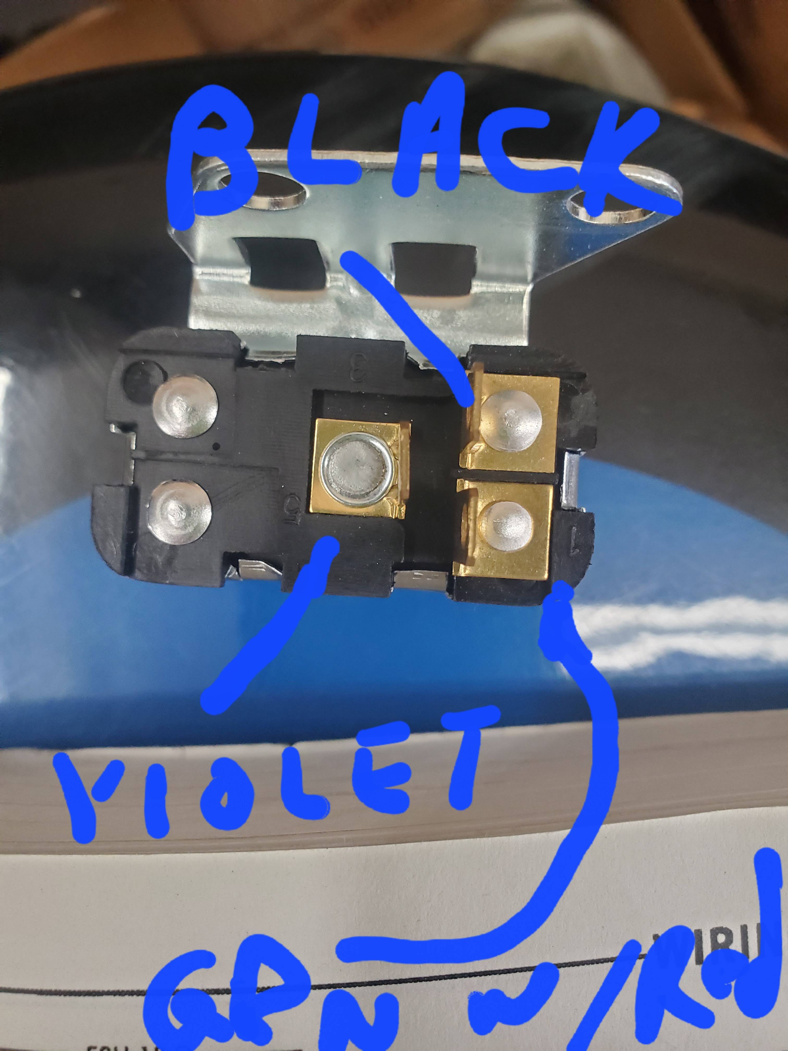

My repro harness has a different style horn relay than my original. Don't know if these wires are correct or not. Here's a pic of what I have going to the relay. Any idea if this is correct?

I don't have the manual here to check the original wiring layout but I suspect that is where the issue is .
Ok thanks. I'll try to call M&H and see if they can help. There is a G on the terminal the violet wire goes to. You would think the back ground wire would go there.

If your car is a ‘70, I think all the reproduction under dash harnesses use the ‘71-up style fuse block. They moved the horn relay off the fuse block in ‘71. This may be where your issue is. Maybe they mis-wired the horn relay connector. Maybe check a ‘71 wiring diagram.

There must be a loose wire at the fuse box . I've been testing wires and moving wires around and now it's working.
