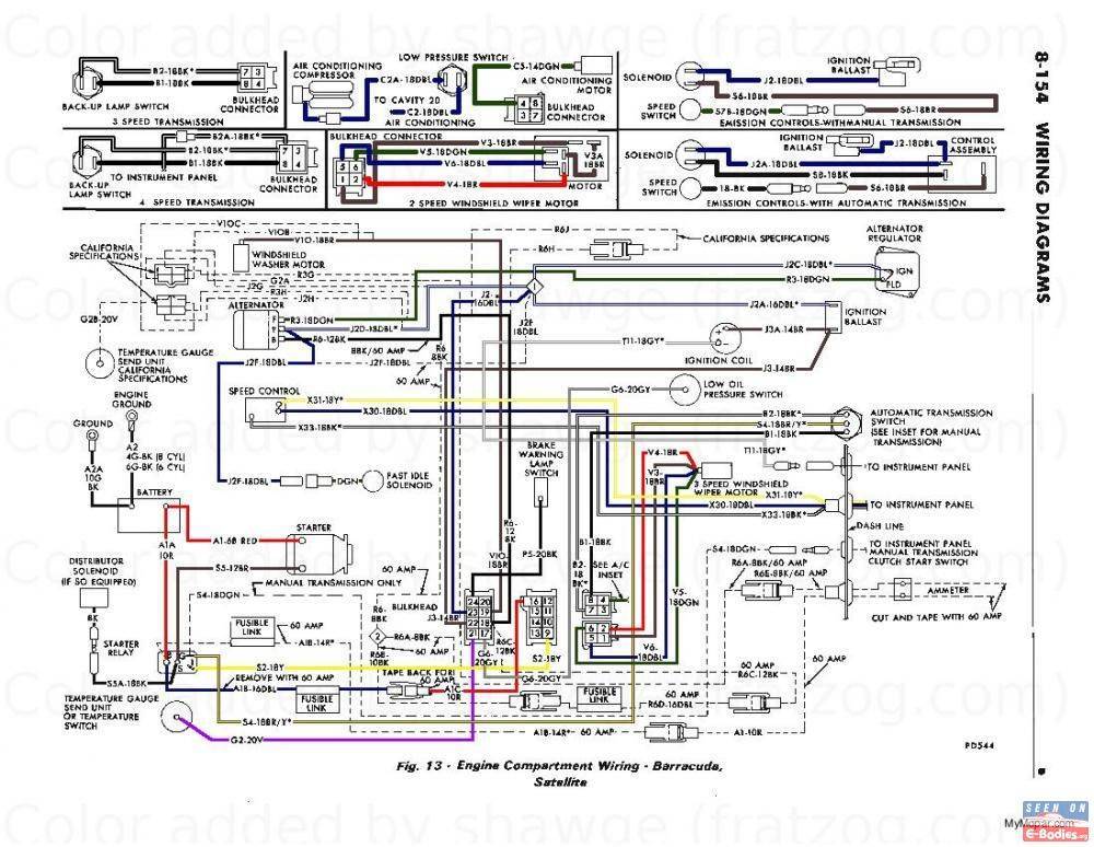

Does anyone know of the 72 Challenger came with a clutch-starter safety switch? (like a neutral safety switch on an automatic tranny).
Mine was converted from an automatic and does not have a clutch switch, causing some safety questions.
Thanks
Look at yellow number 9 connector and follow.

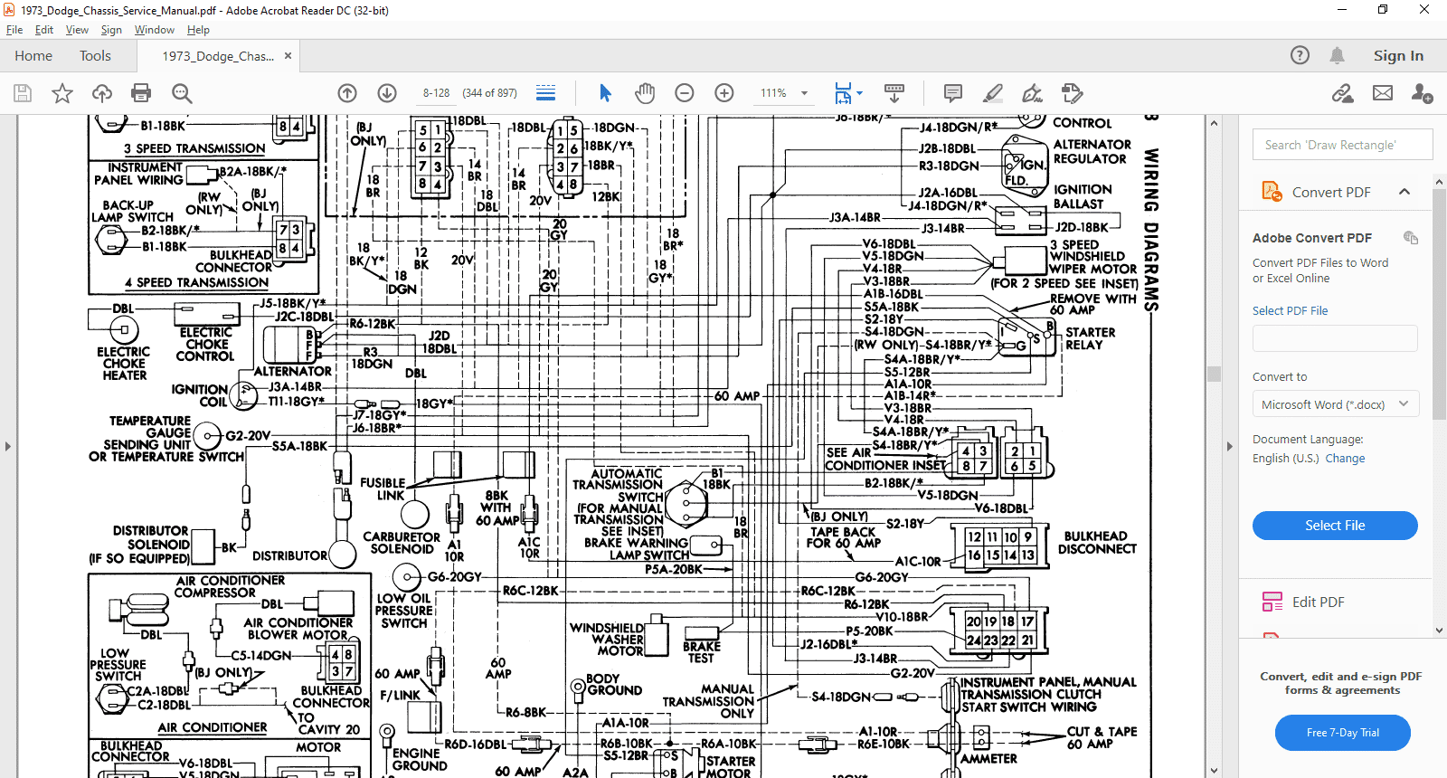

Clutch safety switch interrupts start circuit. If you have a standard trans you can make do with out it.just start in neutral or clutch in. look in bottom right to see manual trans application.

Really simple, depressing the clutch completes the grounding circuit for the starter relay. Without the ground, the relay won’t work which prevents current flow to the starter.
