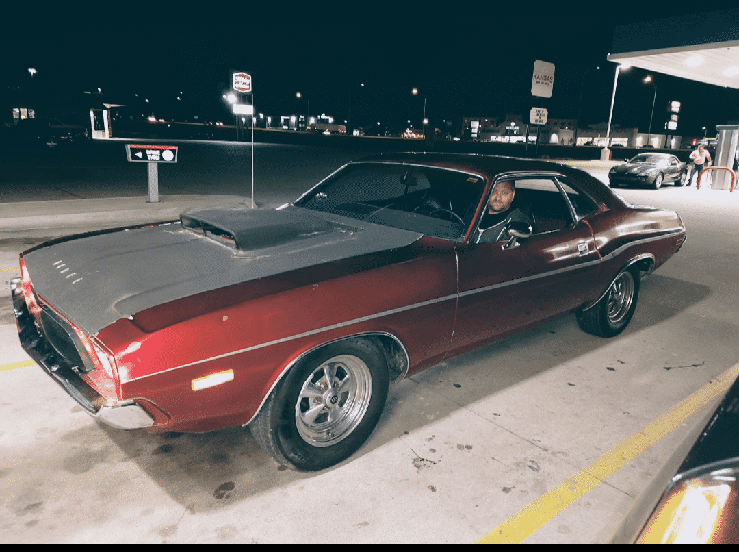

Bought a 74 Challenger. Was originally a 318 4 speed, converted to 360 with 727auto. Want to put a 440 and a833 in. Any advice is appreciated. What issues might I run into?

Nice looking Challenger.
Good luck with your BB conversion.
