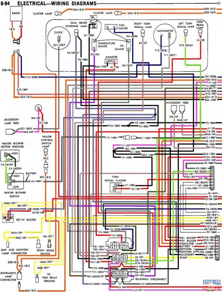

Move on to a headlight relay upgrade. Start getting the parts. The dash light get the ground from the mounting screws. Dash lights a Brighter possibility Check fuse in fuse box.

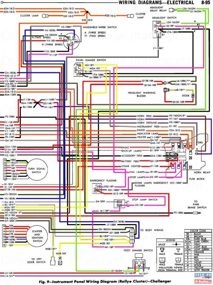

Headlight sw in top right of diagram. See if you have power there. L1-16BK is the feed from splice one. If you don't have it there there's a problem before Splice 1. Then check L7-18BK Don't forget about grounds.

The Cuda* single-headlight version of the relay upgrade.
*Side markers and front parking lamps are 1970 Cuda.
