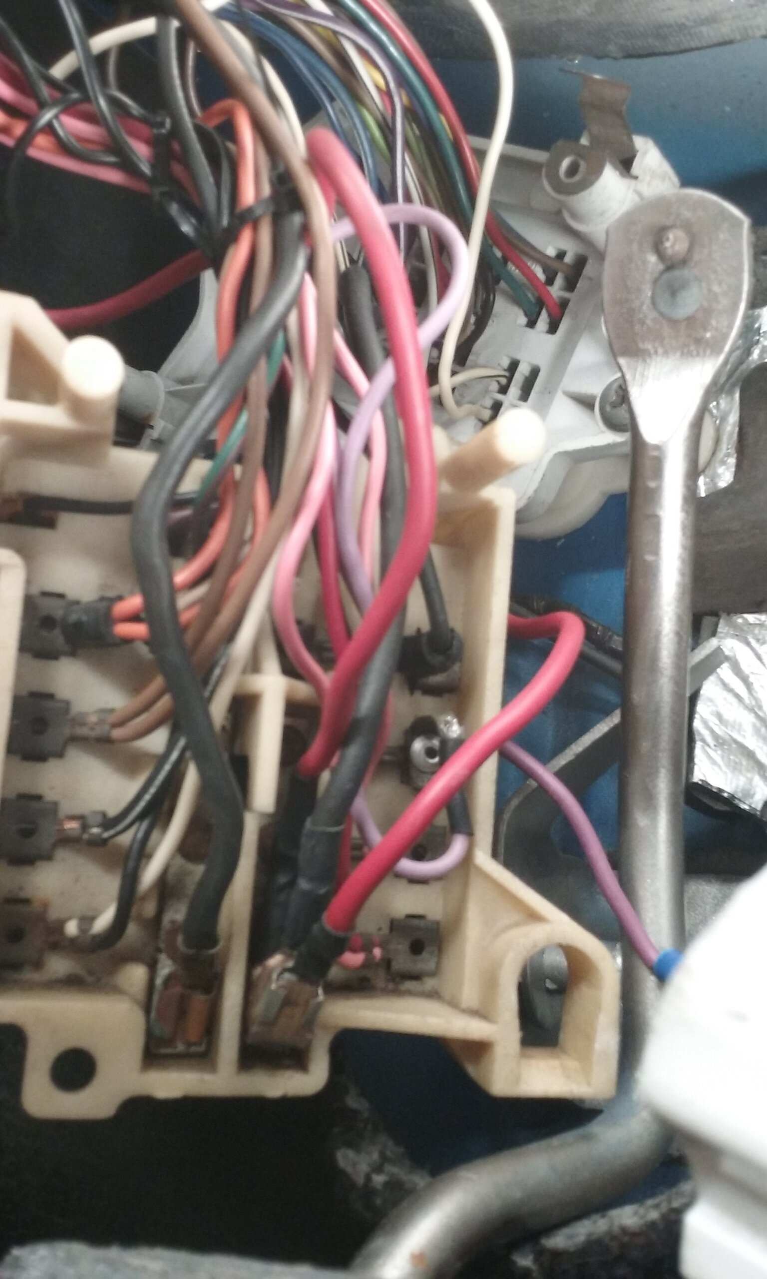

Here is the back side. the orange wire is feed from the tan wire on the same side check for connections.
Tan wire from dimmer sw feeds it. Did you turn the dimmer up. or dimmer is bad. Look to the top of diagram for dimmer. Here again remember the grounds.
