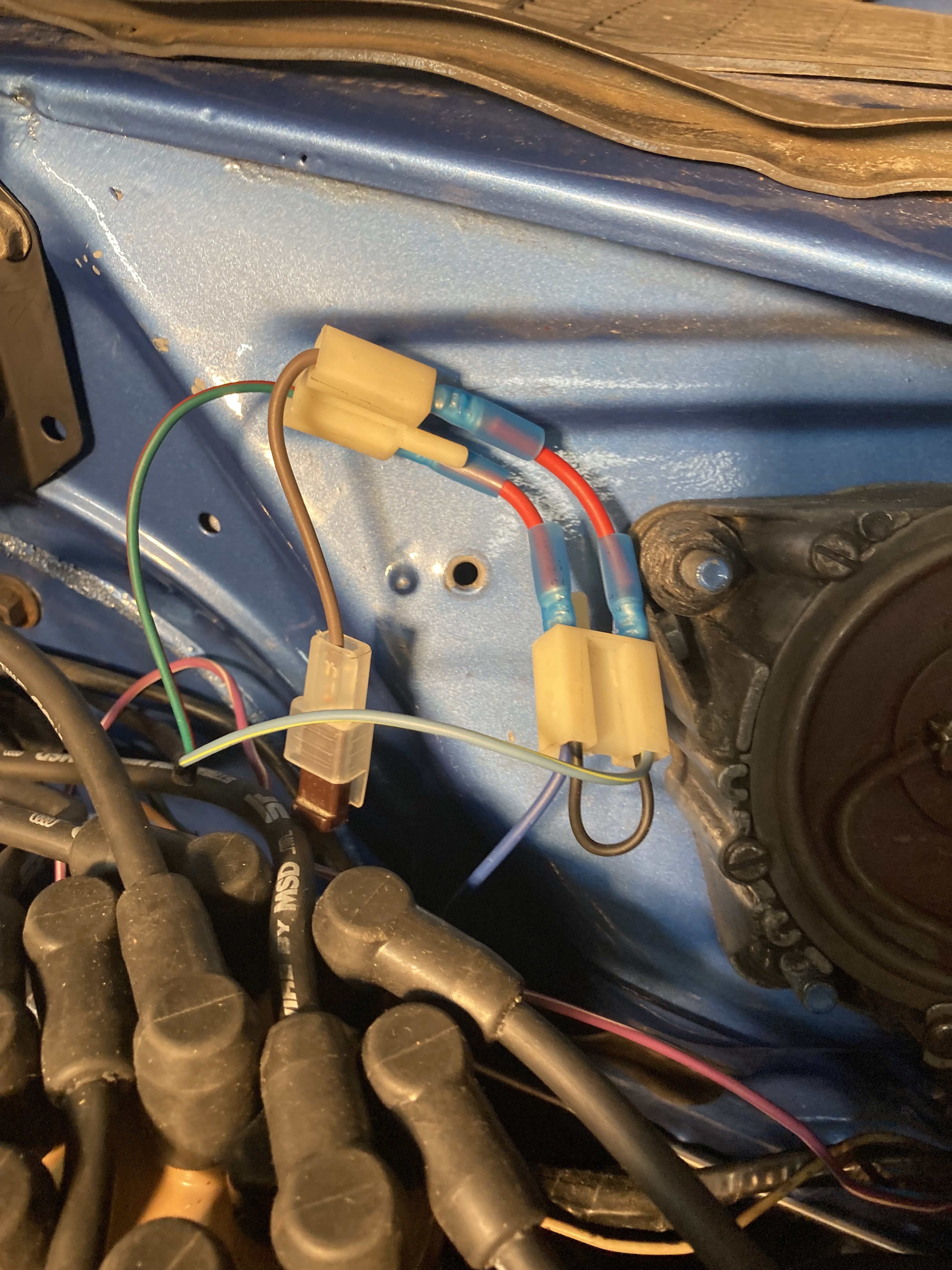

no spark to plugs. change to non ballast resistor ignition---kept blowing 4 prong Bal resistors car was running prior to change. new distributor, new ignition module, new ignition switch--new non-ballast resistor coil... all wires are in the correct position all fuses good. new ignition mod is a 4 pin--green wire not used-----old unit 5 pin what did I miss??????? 71 challenger w/electronic ignition
trying to start car. Was running. had problems wit ballast resistors. so, went to a non ballast resistor coil--car was running....had to replace ps box and pump.....today tried to start no fire to coil.....seems to trace to ignition switch-------do have a problem there. fan stays on when key is accessory position,,,,,,
So your are still there.
Can you explain what you found the fist time around and this time too. The same as the first? Meaning using a test light or meter to check all connection point for power.
