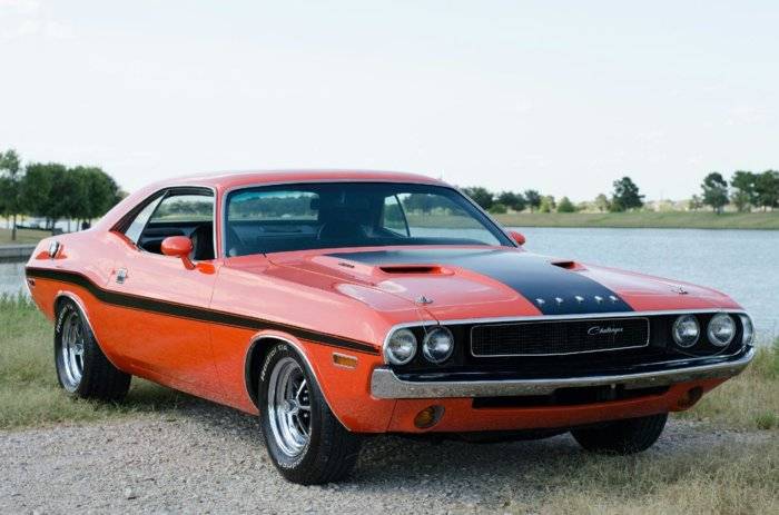

I'm more of a '69 guy but I think the '70's are about the same on the fusible link. It should be a Dark Blue #16 gauge wire that is connected to the "Battery" terminal of the starter relay and then feeds into the bulkhead connector and on into the interior of the car. It will have a rectangular plastic "tab" on the wire before it enters the bulkhead connector. This is the main power feed to everything inside the car and many things outside as well. I'll try to remember to check my '70 Challenger tomorrow for exact location of the FL. BTW, very nice looking Challenger you have there! :)
