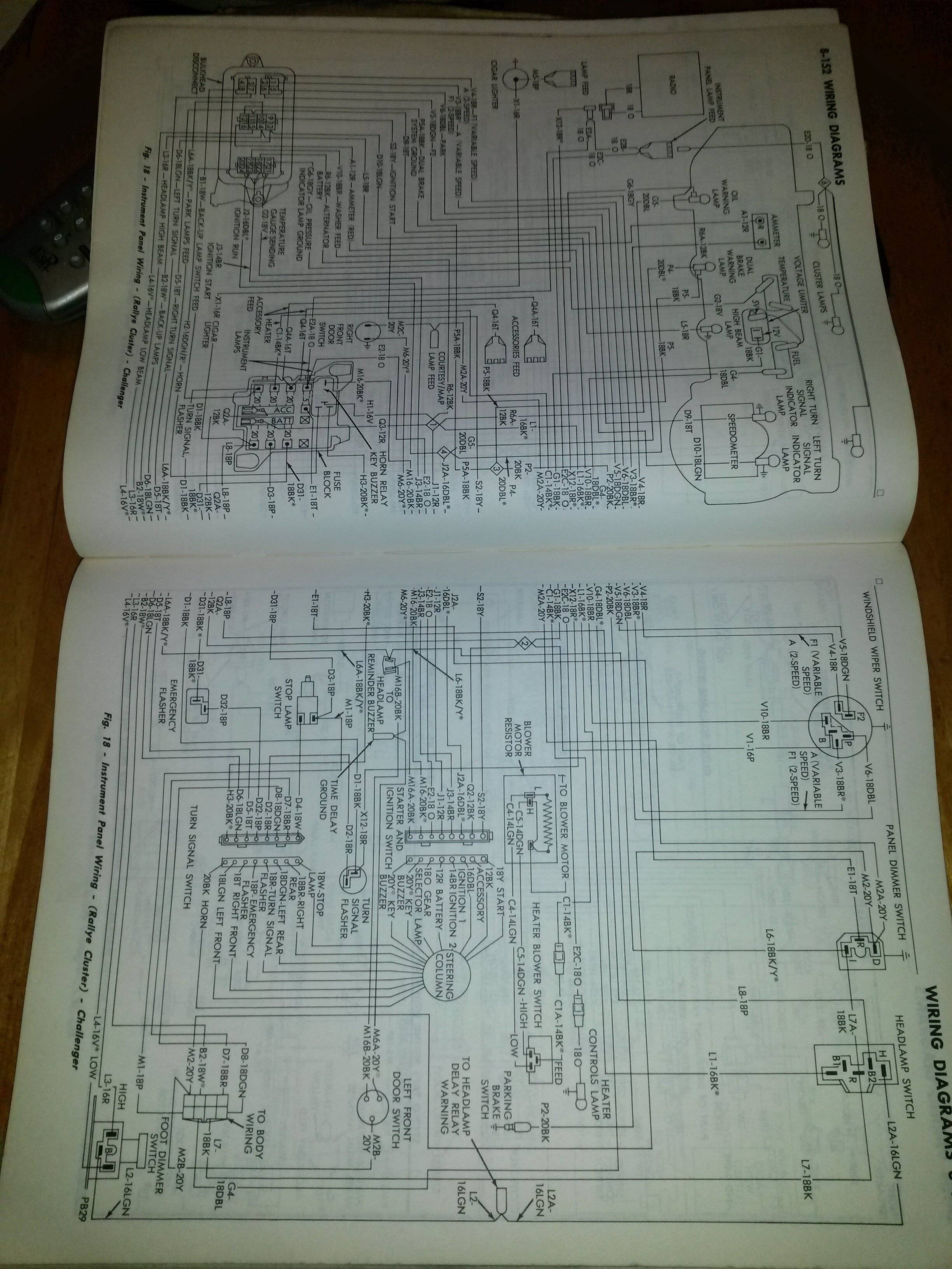

When ign is on and jump starter relay,does it start?Remember there a two ing circuits. start and run. also two power feeds when motor running,alt and battery. black alt feeds into fuse box acc side,red battery feed. make sure steering column connector is connected. I remember it is a tight fit.wiggle and squiggle push and pull twist and turn.check the simple thing first before you condemn. I believe that is the a picture of turn signal plug. but just want to give you an idea what to do.
