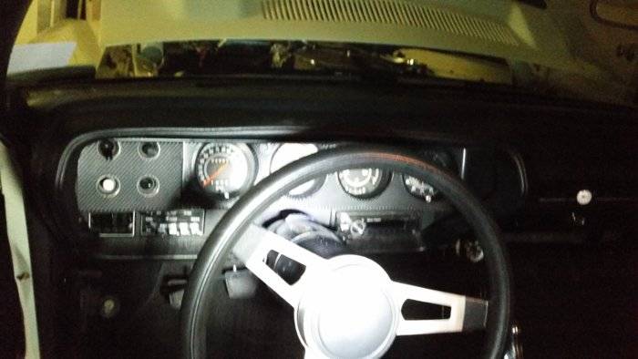

See photo in post #18 of my dash project thread. I don't believe you need an AC dash frame. I think they already have holes cut for vents. See rear view above glove box. This frame is non AC.
You will need to cut the dash pad, but I'd be really careful if the dash pad is in good condition.

I looked at the back of my dashes and it does indeed appear to have the holes cut out in the metal where the vents should go. I did call vintage air a while ago, but they where not the most helpful. The sales rep told me to go talk to my local dealer. as far as the price, I need a dash pad anyway, and a AC dash cost the same as a non-AC. The real cost is if I try to use OE vents. The price for those, if you can find them in nice shape, is pricey to say the least. The only option would then try to use some the optional Vintage Air sells, and put them in the stock locations. Since my car is a resto-mod, it would not be a bad choice. I just need to find a set of factory vents to measure to see if they have something that fits.

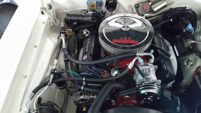

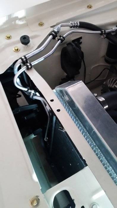

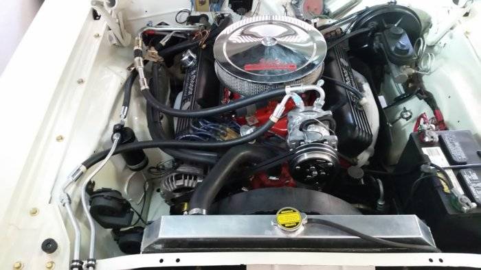

Hi, I just got my AC completed. My inside dash is all stock and refurbished. I designed my own under the hood system. An automotive AC system is not rocket science. You purchase the items that you need to build the system and then assemble. I bought all of the items off of eBay, mocked up the lines, installed the dryer, the compressor, the condenser, had the lines crimped vacuumed it down, it held vacuum and I serviced it with 134. I have a little over $600 under the hood in materials. You do have to have the tools to service it and understand what you are doing, but if you want you can assemble you system and take it to an AC shop, have them service it. Any question just post here.

Hi, just took these pic's of the system all complete, and clamped down. Also if you would like to see my Challenger, I am the featured member on my car club at www.moparsaz.com/.
