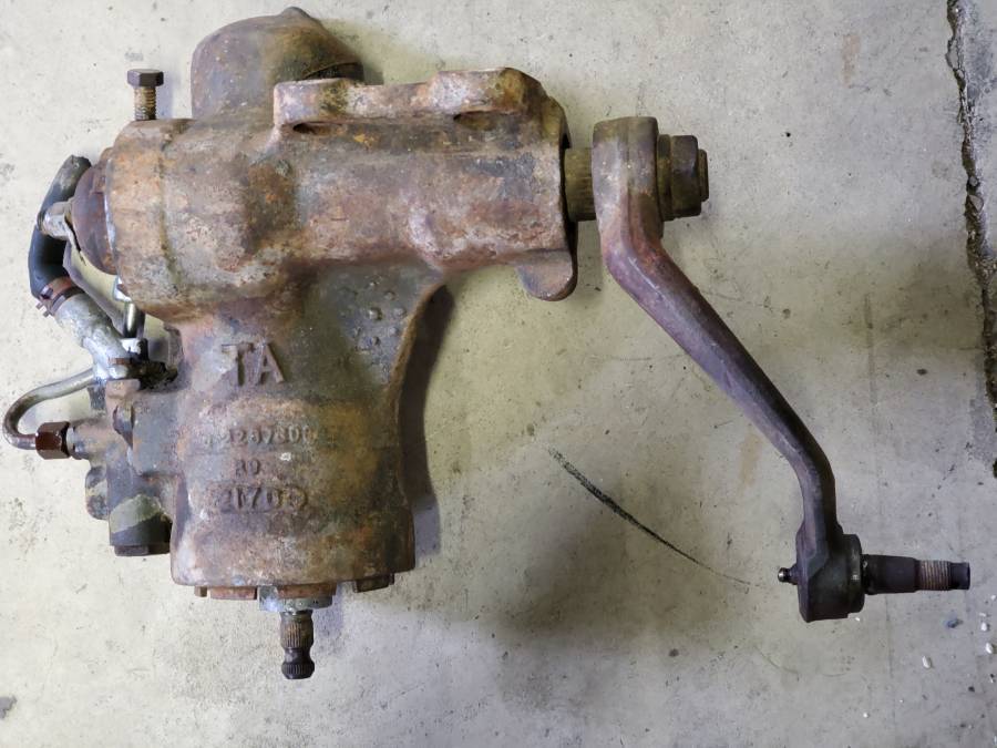

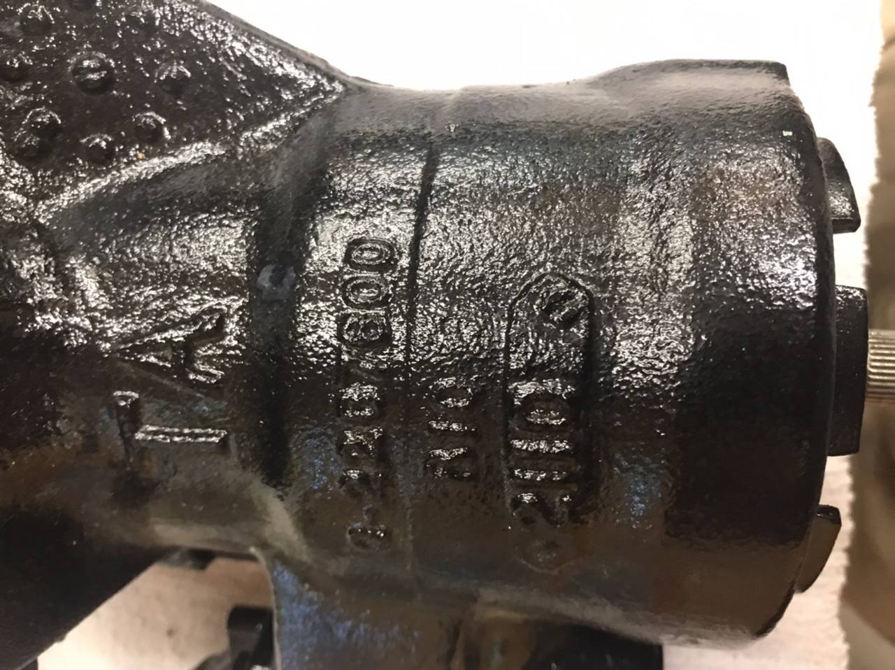

If you do a search for Mopar steering boxes with “2267282” or “2267262” you get lots of pics of what looks to be the same steering box. I think the second to last digit looks more like a “6” than an “8”. Either way, its possible you have the original steering box in your T/A.
The optional quick ratio “TA” steering box has a different casting number (2267600) and has a large “TA” cast into the body.
