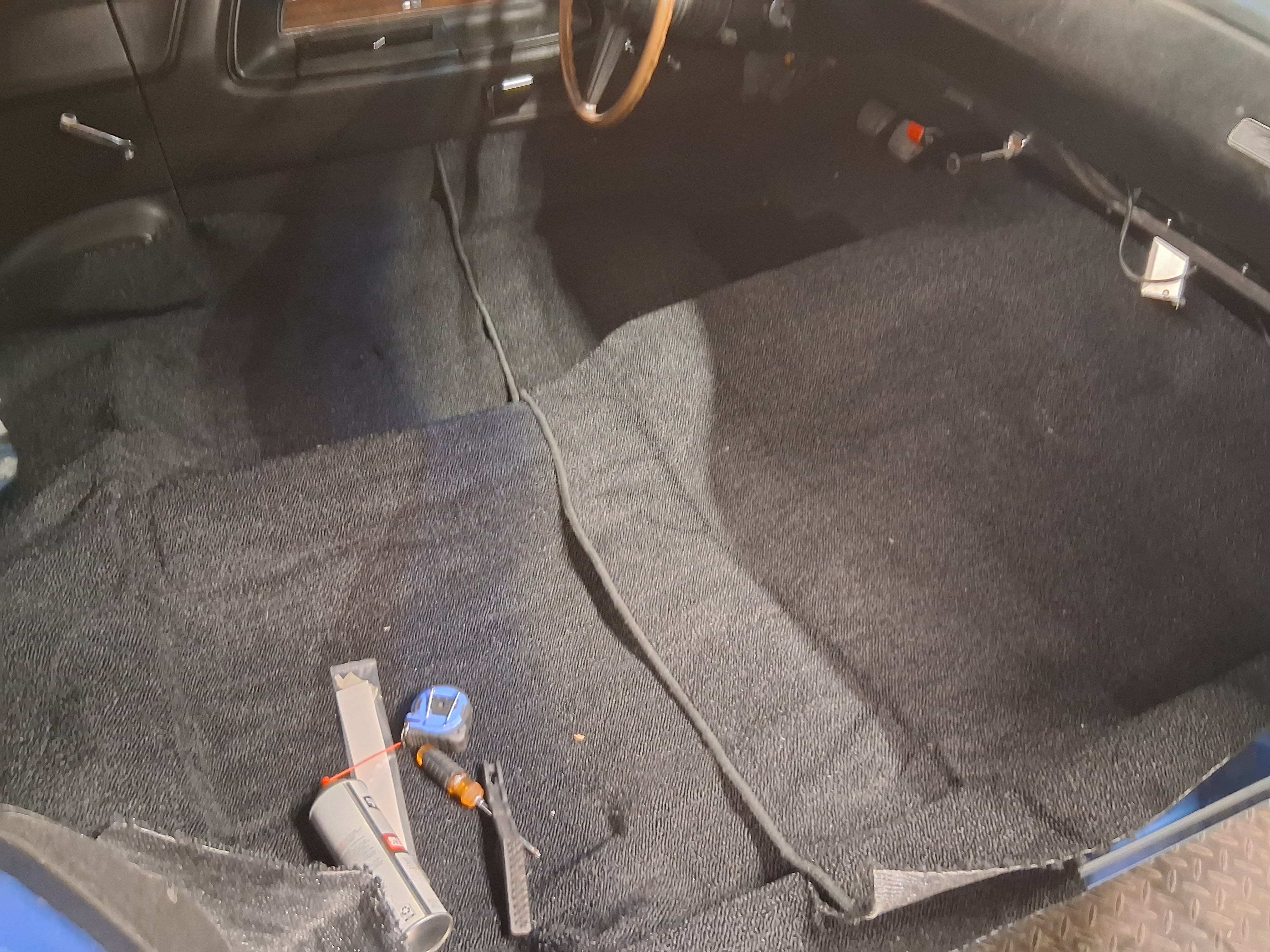

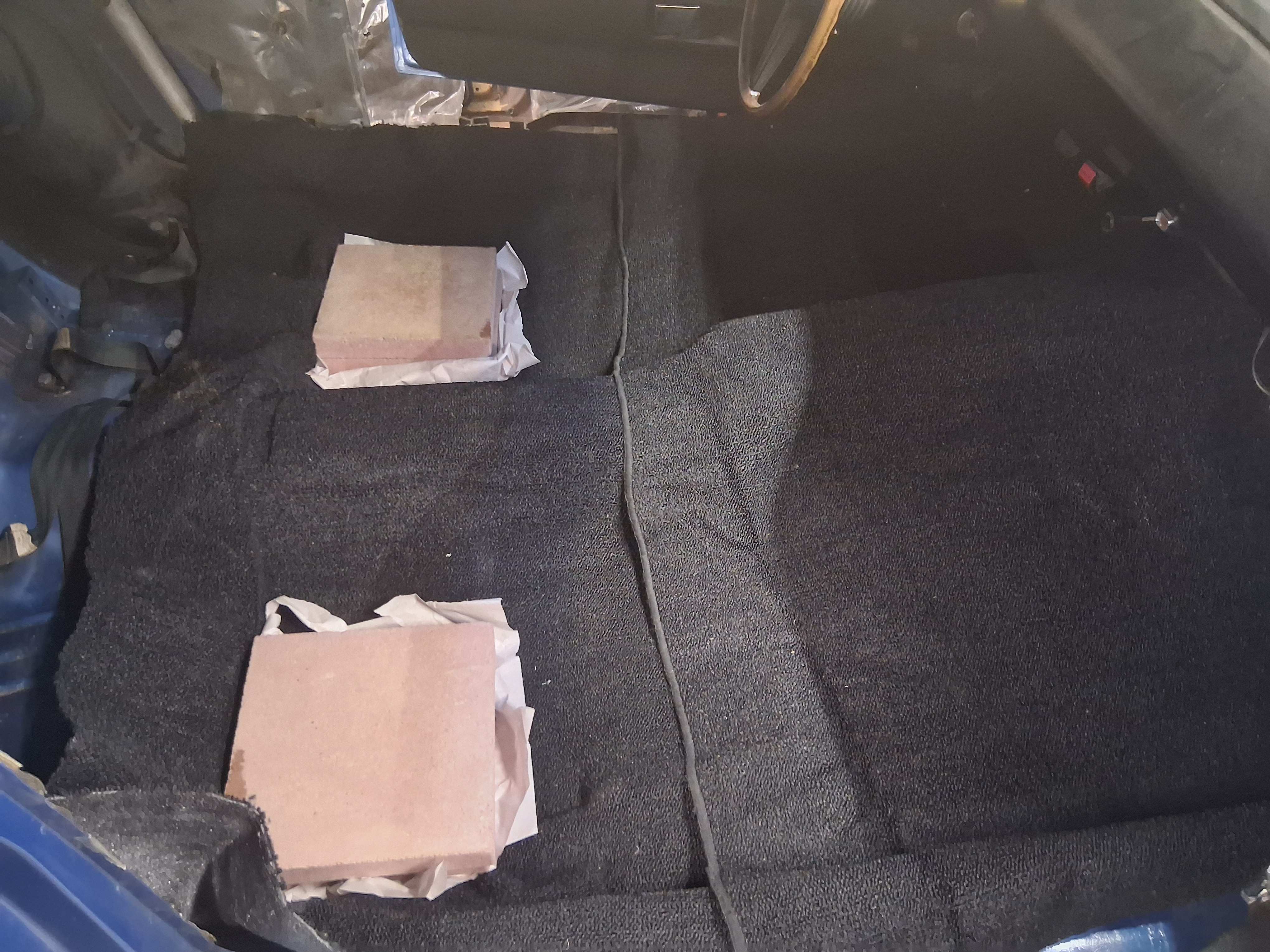

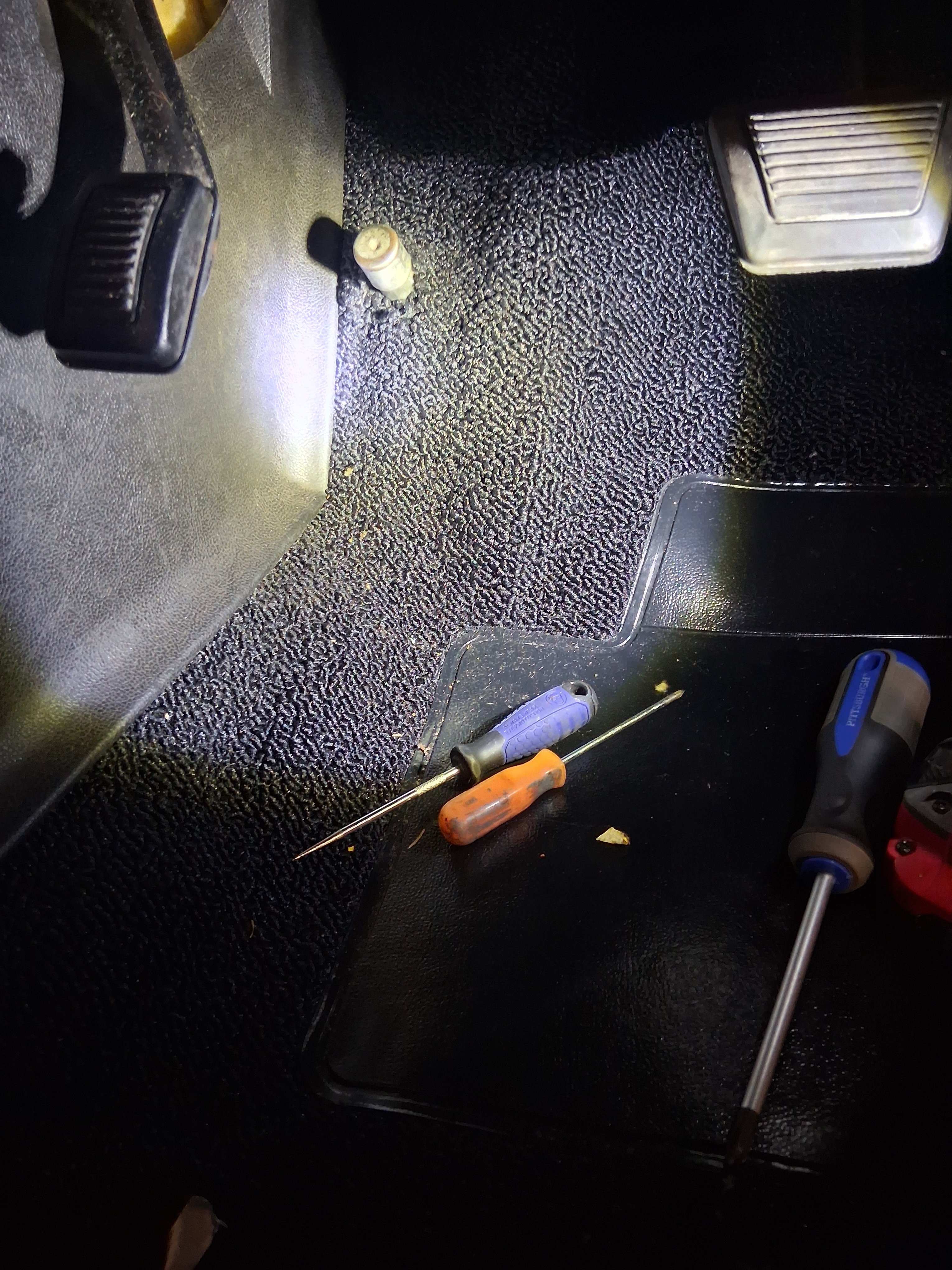

Since I already have the interior back together in the 71, I looked at the dimmer switch location in the 72. I hope this helps.I haven't got my dimmer switch mounted. New floor pans. Is there a correct place for the dimmer switch

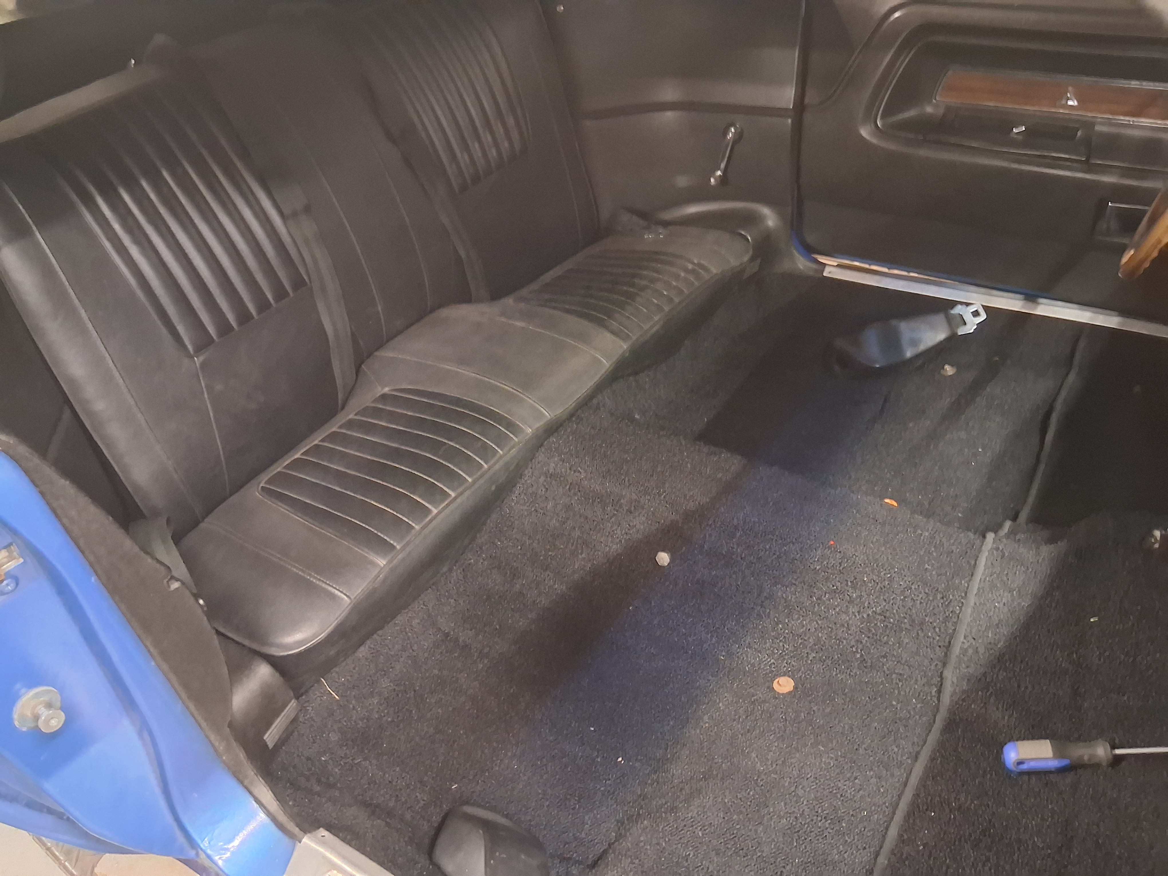

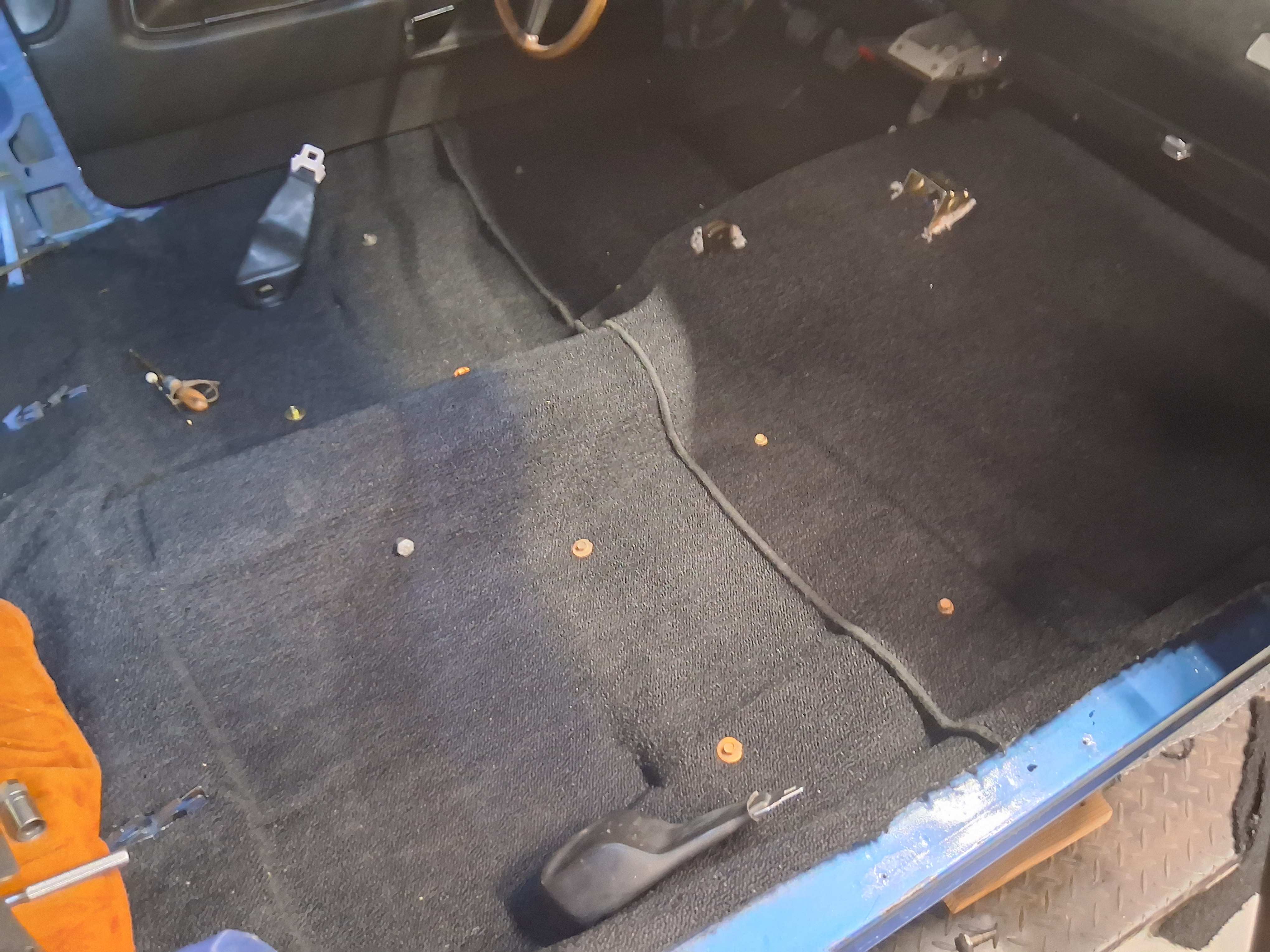

Good luck with that! I don't think you can get the sill plates on with the carpet folded over that lip. Every carpet I've seen was trimmed off flush with the top of the lip and then held in place by the sill plate.Finally, the extra material along the sides has to fold over the raised weld between the floor and rocker. I gather its better to go over that seam at least as far as the sill plate will allow before trimming it.
Can that be steamed down, or just screw the sill plate down and that takes care of it?
