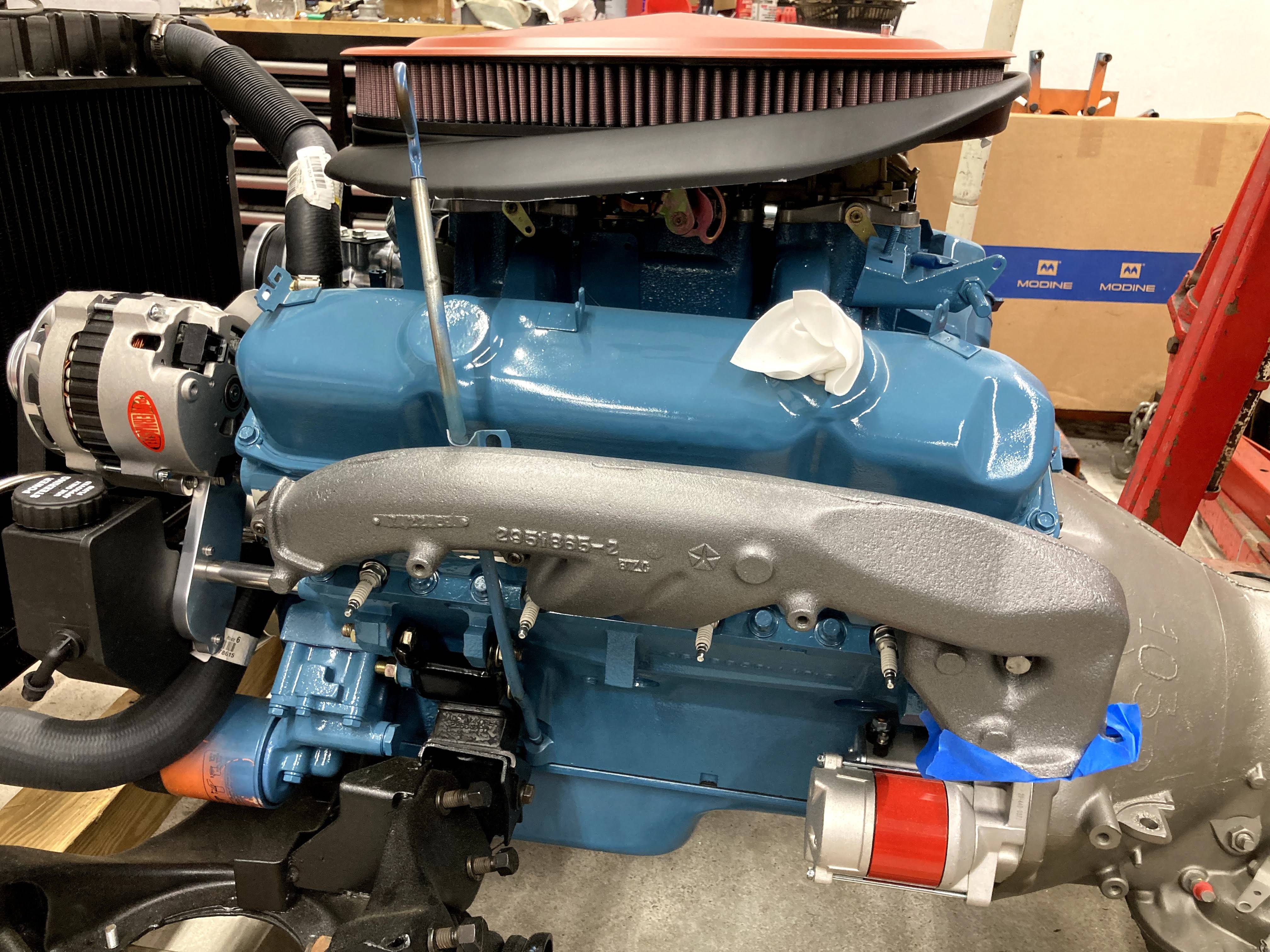

Hello,
I'm for an oil dip stick assembly for my 440 6brrl engine. The dip stick that I have came with the oil pan package but it is too long, the mount is in the wrong place and its not bent correctly. Does anyone know where to find one? It should mount to the motor mount correct? I have HP exhaust manifolds also. Should I try to re-bend it and move the mount into the correct spot?
Thank you
Mancini should have one. Yes it bolts to the motor mount. You could try and modify what you have and if that doesn't work then order the correct one. It's seems like you have to tweek them a little bit even on the correct ones.
