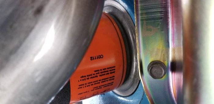

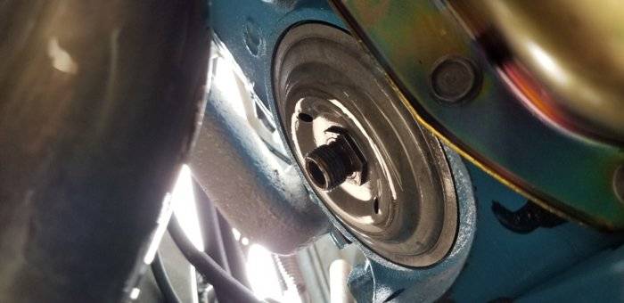

I just had my 74 360 rebuilt. I installed the engine, it runs great. At idle, it has about 80 psi oil pressure (new Autometer mech gauge). I noticed that my oil filter leaks. I changed the filter twice. The filter is hand tightened, gasket lubed. When I look at where the filter is attached, it doesn't look right. It doesn't look like I have the right filter. I'm using a Fram Ph 43. Before that I had a Wix filter. Is the oil pressure too high? Could this be causing the filter to leak? I have some pics of the oil filter. Thanks

80 is pretty high but is shouldn’t leak. Tighten the WIX filter a bit with the wrench and see what happens. Just say no to Fram filters. PH43 is a good number, it is short, and a PH8A is long, if you have room use the long one.
Does that plate on the block have a gasket behind it?

Not sure about the gasket. I'll try another Wix. Thanks

I'm a big believer in Six filters...hand tighten as much as you can and just give it a little more with a filter wrench...I have never had leaks.
