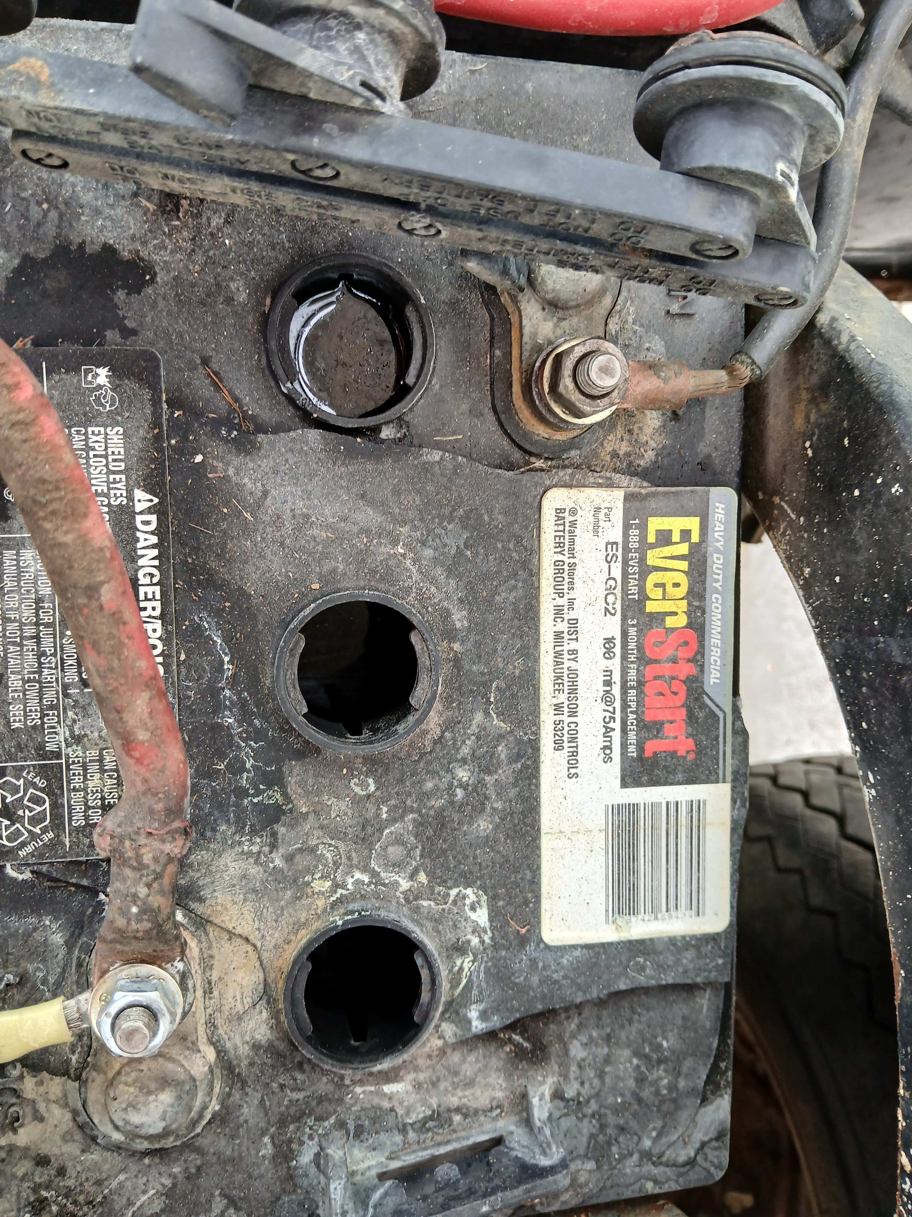

Just to recap my recent problems and posts. I’ve had some wiring harness issues. I think I have them fixed to the point where I can drive my car. Once my harness issues were resolved the battery had died so I left it on a trickle charge for a few days my car started right up drove it and had no issues.
I haven’t used my car since then (maybe a month or so now). I was going to take it out today but the battery was dead again, so I left it on a trickle charge for a few hours when i returned home turned the key still basically dead. I removed the trickle charger and hooked up my battery starter/charger set it 12V/200 Amp engine start. When I turned the key it instantly made a loud pop and blew one of the caps off the battery! Why did this happen? Is my battery junk? I know my underwear is! 🤣
Ive had the battery a few years now and has been fine no issues Duralast battery And yes the leads on the charger were hooked up correctly. I’m basically paranoid to drive my car much less even try to start it now. Im now keeping a fire extinguisher in the truck next time I take it out which is probably a good idea regardless.

Might have been overcharging it.
I had that happen several times while driving, hood was off.
Turns out my voltage regulator was bad and delivering 16V to battery.

lead-acid batteries give off fumes that must be vented, and these batteries have a vent. If this vent is plugged (perhaps by a small plastic cap during shelf storage, transport, shipping) then as the battery charges/discharges, those fumes (typically hydrogen gas, flammable, think Hindenburg) could build enough pressure to pop them caps off.
This happened to me with the battery replacement in a Mercedes. This vent was capped (presumably for shipping) and I didn't notice it, or think it an issue until I found the caps lifted off after a week of driving. I pulled off the tiny red plastic cap from the smallish barbed fitting on the side.
Find that vent and make sure it's open. Other batteries may simply have an opening, somewhere along the seam where the battery lid is attached to the battery box.

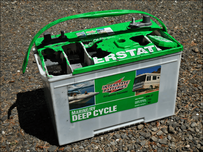

Here's a picture of the usual damage from an internal explosion of hydrogen. Ignition occurs and then continues to the other cells which also have a buildup of hydrogen. The term "maintenance free" really only applies to sealed batteries.
Nothing is "maintenance free". Set and forget it and this is what happens. Low electrolyte and charging or over use is what causes this.

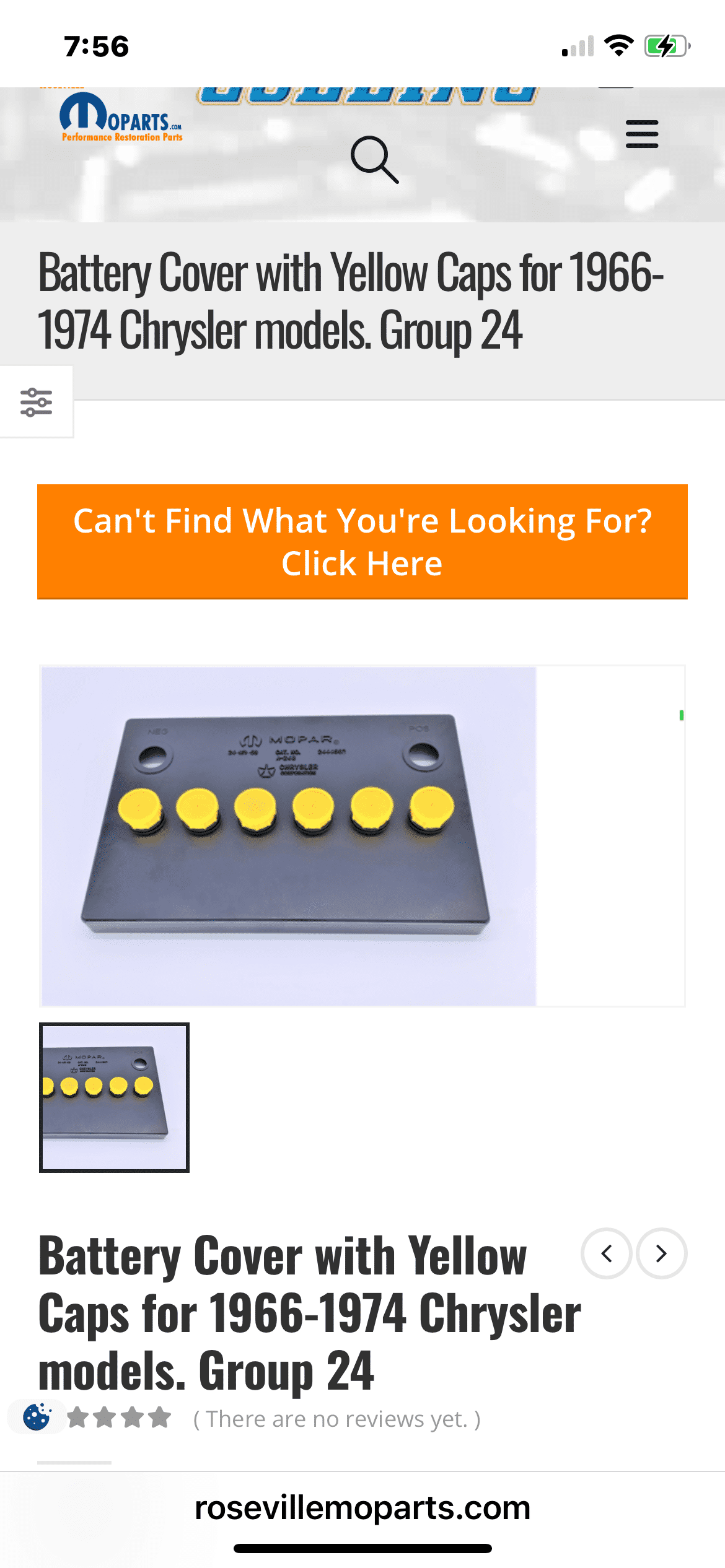

Any opinions on these battery covers? I found this over at Roseville Moparts while searching batteries after my charging mishap. I like the original factory look it’s $75 more or less, so a little on the pricey side to me for a chunk of plastic but obviously way cheaper than a retro style battery. Which I can no longer seem to find searching the web.
But now that I’ve been educated on battery vents potentially being blocked and seeing firsthand what can happen when a battery cap blows off. I’m not sure if this cover is a good idea or not? Any thoughts on these are appreciated.

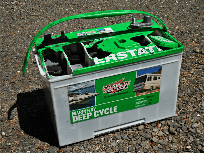

Howdy wowza now that is a POP, my pop was a weenie one

It was actually the cap near the positive side of the battery that blew off. The other one stayed on
