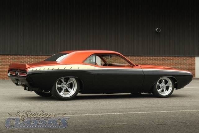

Here's my paint scheme.

Welcome from Arkansas! Can’t wait to see it come together. Cool paint scheme too.
