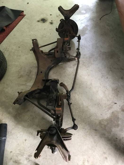

Yes I'm interested too here's my 70rt broke down and currently trying figure out a rebuild kit to buy. Does PST/James offer the full rebuild kit for this car? I wanted to keep the original brakes but I am going to be running the 17inch year ones I already have so I have plenty of room under to upgrade disc brake size. It's a 383 front the factory but I would also think if I ever put in a monster motor in the future the factory single piston brakes just wouldn't be good enough. Let me know what disc brake setups you would recommend James at PST thanks.
fk5aar
Dec 2, 2015
476
103
Sorry forgot to include pics
