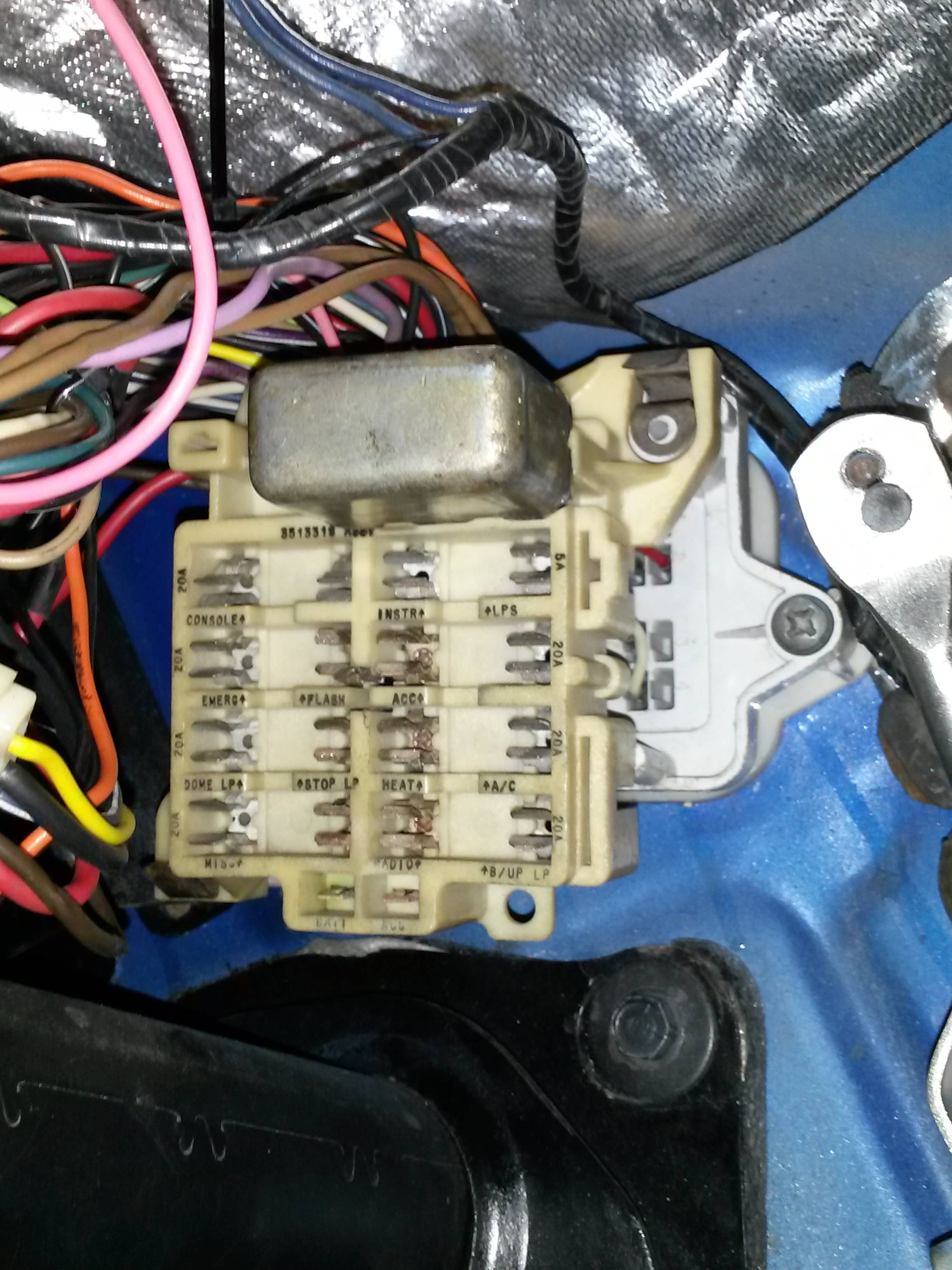

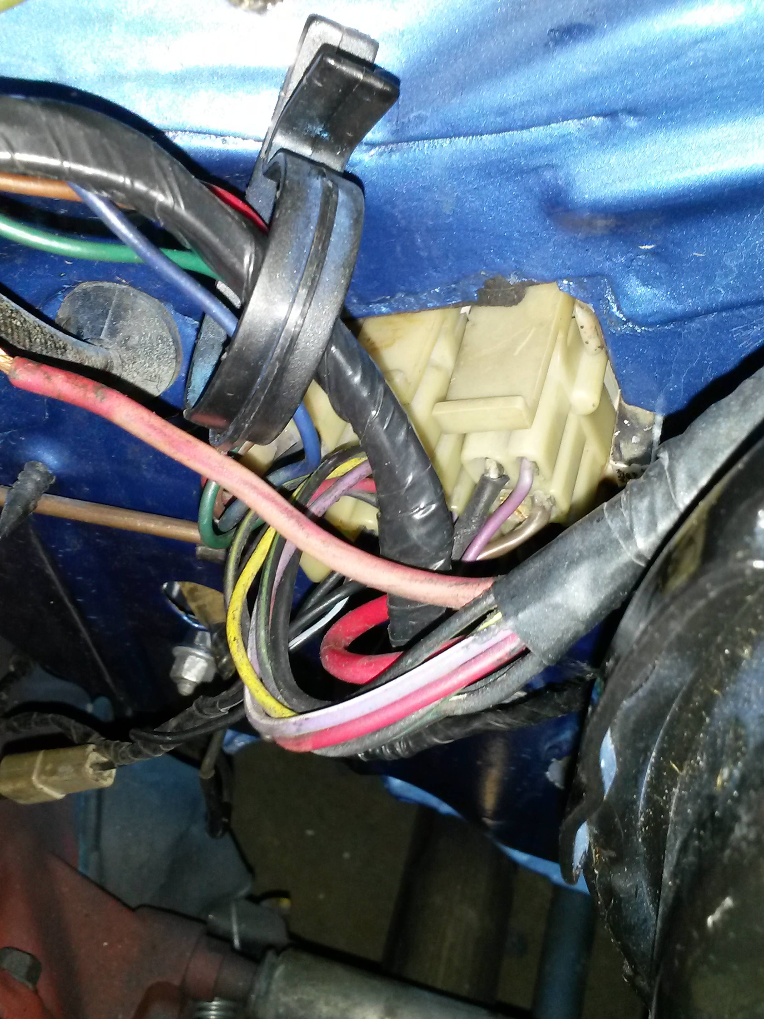

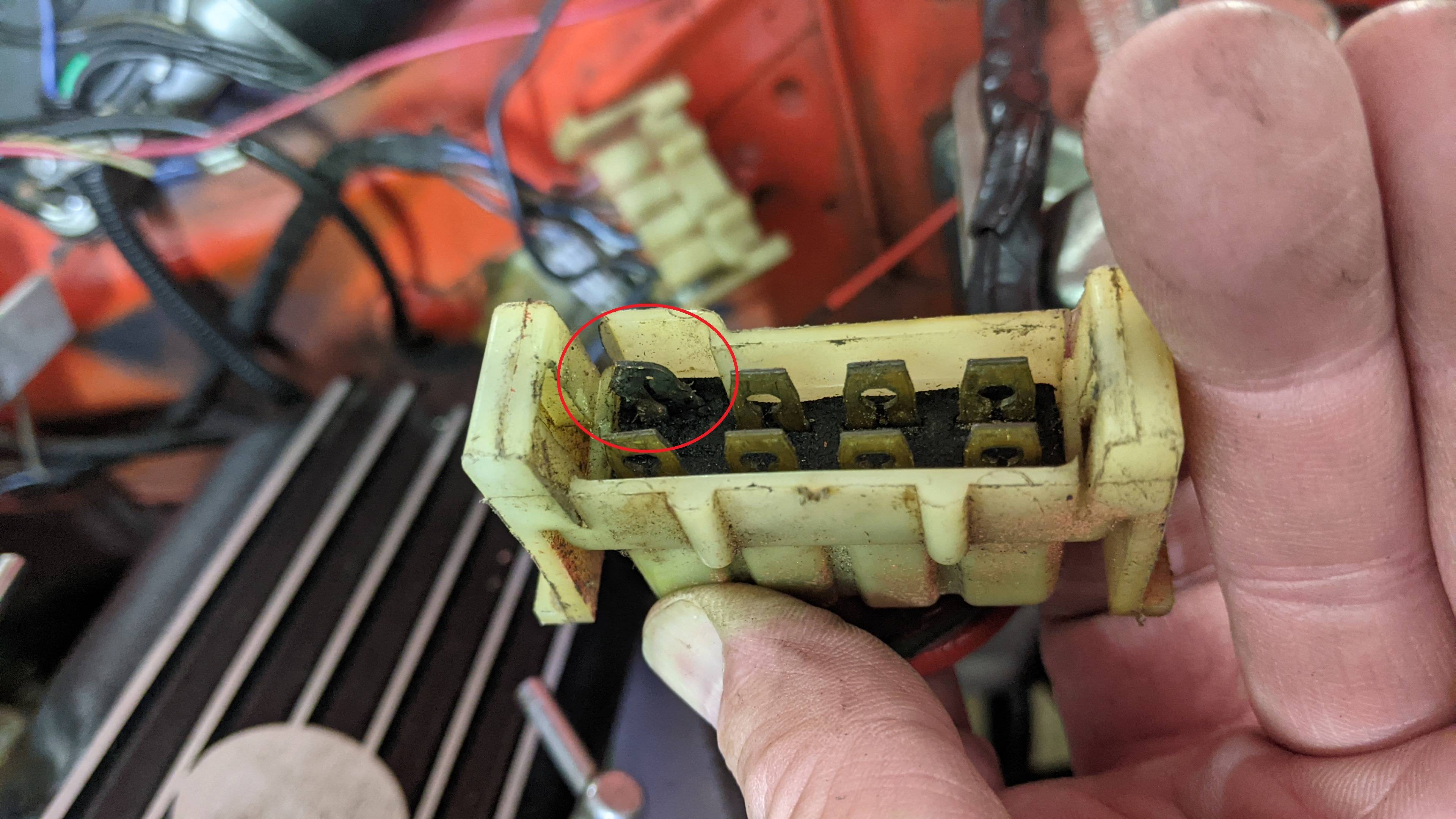

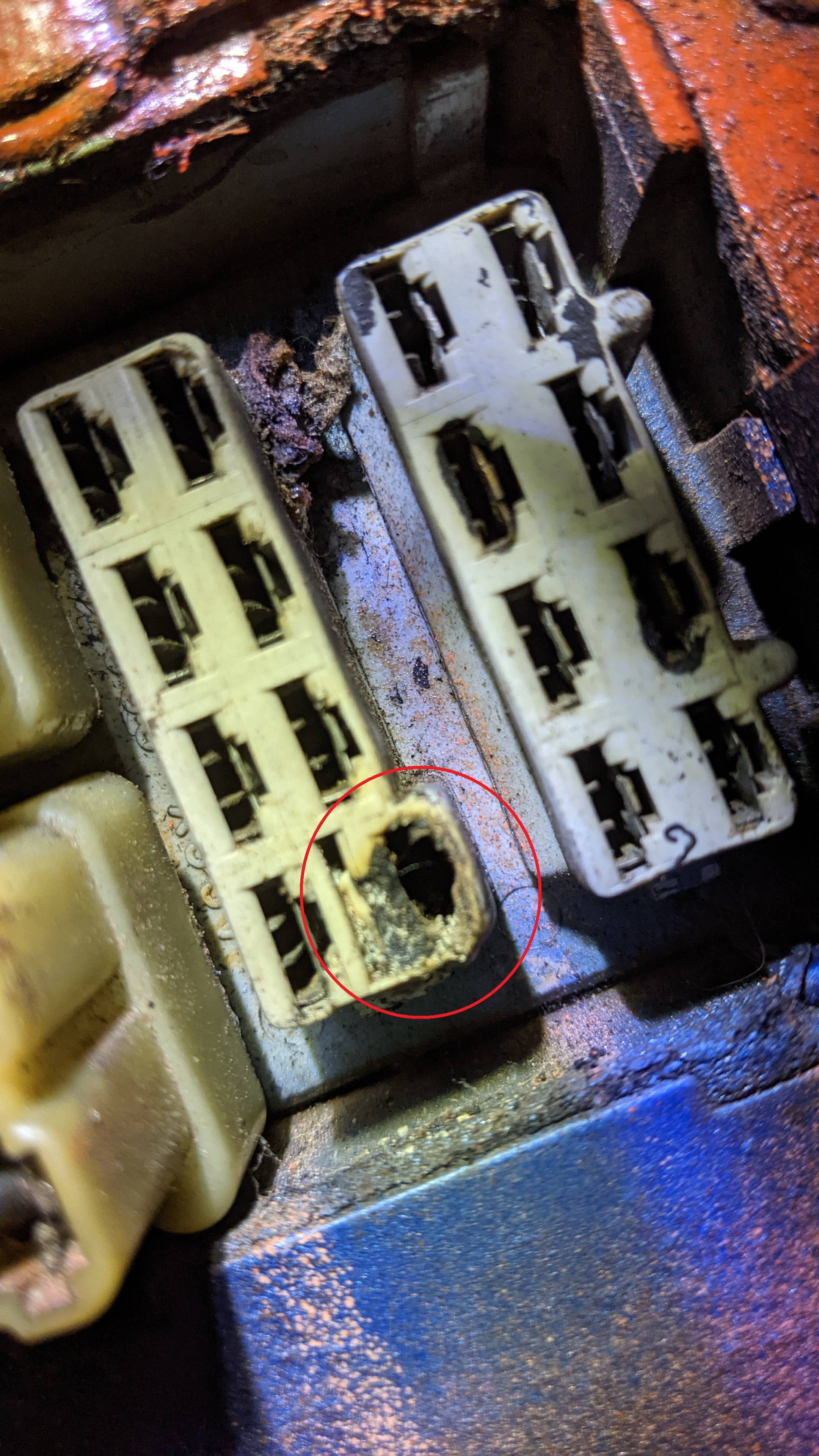

One Terminal Melted in Firewall Junction Block

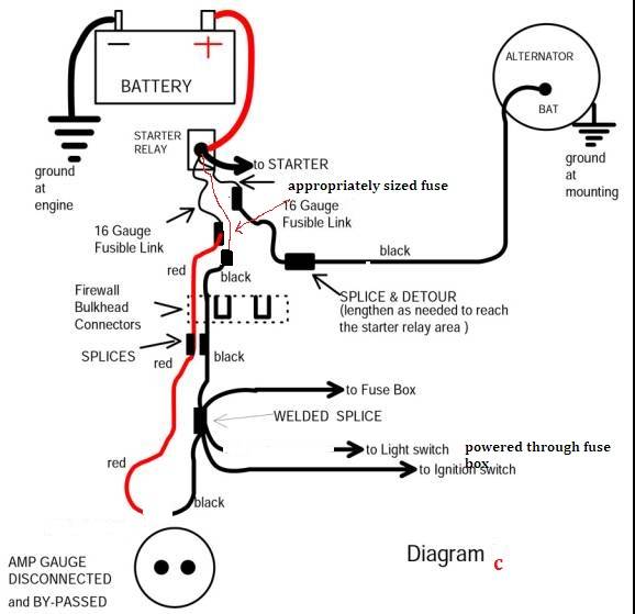

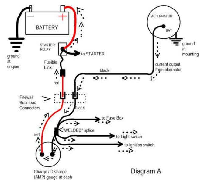

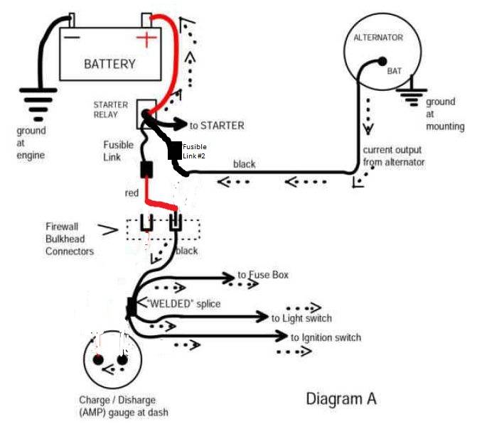

Having the understanding of the prior info. I said earlier in the post : may put an additional power block by battery. would depend on choice of headlight relay circuit and other accessories adding. this would be an option. fuse alternator as per alternator rating and diagram. Mount close to battery or close to or on back of alternator. consider heat.

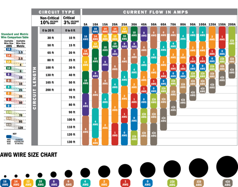

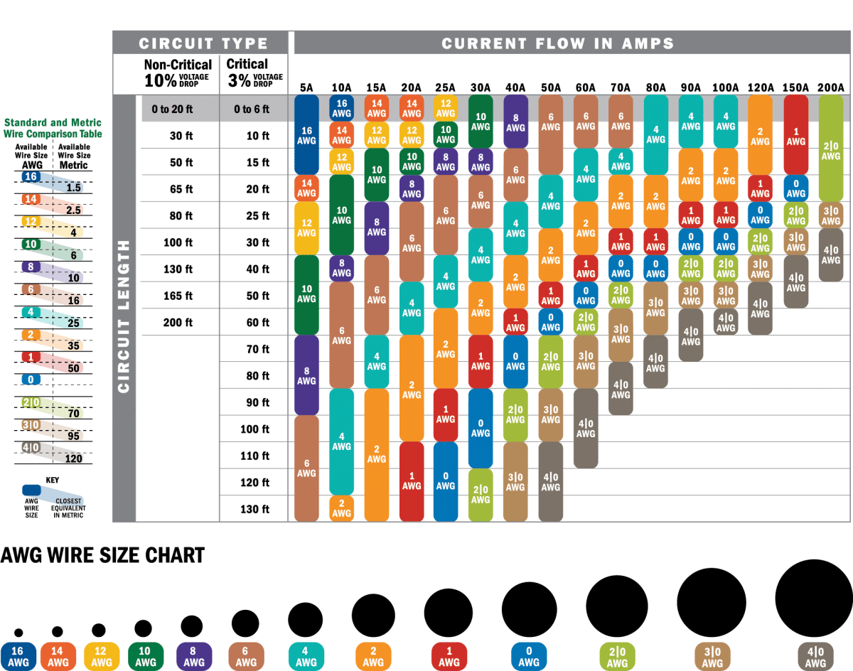

The chart below shows 12AWG is yellow in the chart. voltage drop not to relevant for very short runs. the connection are realy the bad point the don't carry the load even when new.
That's a really interesting chart - what is the source? I'd be curious to know how they rate 18 AWG as that is used a lot in automotive. Also curious they rate 12 and 14 AWG equivalent at 15 and 20 Amp - my reference is typically industrial control ratings (spent some time there) and house wiring (done lots of that) and there 12 AWG is typically 20A and 14 AWG is 15A rated (but these are bundled cable or raceway ratings - not open air).
And Agree 100% on the connections - I've had connector issues in my wife's 2013 T&C air bag system already couple times - and yes on the Cuda I soldered and cleaned every pin - replaced or not.
It's off the internet, It has to be true! A/C and D/C are calculated different. the chart below is how it is done.that you should understand. A/C and D/C generate the eddy current in a different way as it travels through the wire. In short if I said that right. also you would know about de rating,grouping of conductors. stranded and solid conductor are different. Every application is different but the same. I also have done house wiring (done lots of that since I was 12 with father) power plant,switch yard and control yards of power plants,sewer plant .water tretment plants,steel mills.hospitals,universities,railroad,airports,pitt port authority,dams bridges,paper mill where the paper is made for fake money.mines .had surface mining papers.industrial control ,RS VIEW 32 controls.and there are others. OK I'm getting tiered thinking of all that. the avatar I use is a power plant I work at last. unbeknownst to me It's like death you don't know when it will be! As of now It was the last place I worked. next job was a Navy base and there was a shooting. then came covid 19. I was requested to at work at flight 93.It was an honor and privilege too.

Problems start to happen when grounds get loose or dirty. Connections become corroded, loose etc... This is what causes high resistance in the wiring which in turn causes them to heat up and eventually fail.

YES, as moparleo said:"You can always upgrade beyond factory specs. But it should be at least in the same condition as when the car was new." or better.That's why I say bypass the original charging system and other high current loads. Install correct fuses.Or it's just a matter of personal preference. Yes one more thing you can check the wires and insulation like Magna fluxing or dye check. It's called a megger, A megger uses high voltage to check the wires and insulation.It's electrical test equipment and other types,or a meter. you don't need it for this just common sense and experance.

Basic grounds and connections are at the root of most electrical problems on automobiles. Clean connections equal lower resistance.
Lower resistance equals better and lower temperature current flow. Lower temps And this applies to almost everything mechanical equals lower stresses and component failures.
Keep it clean, tight, sealed. Not rocket science. Not hard to do with common tools and skills.
So yes moparleo, the point of this thread was my burnt connection through the firewall connector block. All the other wiring my my dash harness appears to be solid and in good shape. So I am not putting a "band aide" on the wiring. I am working through the exact wiring improvement you suggested at the beginning of this tread. BUT I need to work through this at my speed and my capability. None of you would want anyone to blindly alter something in the wiring, get hurt or torch the car. I appreciate the dialogue and perspectives from everyone, which is amazing in this hi-tech world that we can have this great conversation from different locations around the country in just a few days because we share a love for Mopar, cars and making them better.
