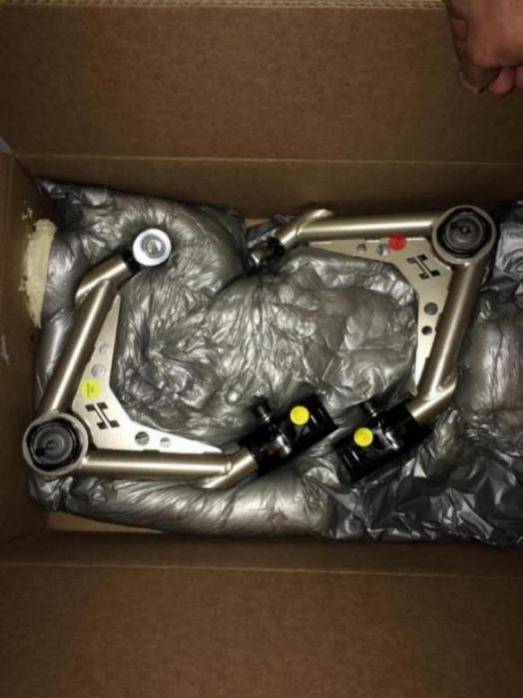

Well I ordered the Hotchkis TVS today. Should come in this week.
Since I have steering slop I think I'm going to get a Napa reman steering box.
Also will probably go ahead and order the Viking shocks now available.

Oh and got the TVS system in to but ups forgot my leafs at the facility and said they will be delivered tomorrow.
Looks gorgeous though.

Teaser pleaser?
