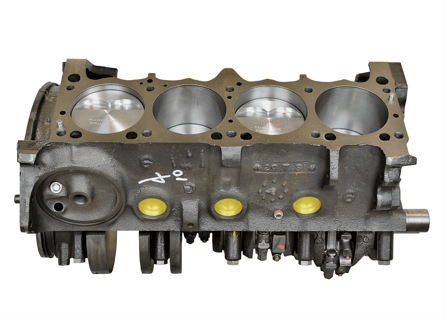

I picked up a 408 stroker Magnum short block for future use from Summit. All rebuilt with internal balance components and ready to add the top end. Paid $2600. A forged crank version is available for $300 more. It bolts up to my 727 A trans and k frame and can be used with a variety of head/valve train components. An easy modern motor install!

Pic of the 408 stroker small block I picked up!
What cam is going in it? The way things are going $2600 is a steal. a set of head and that seems like a good cheap build. any kind of motor from a salvage yard they want you arm.
