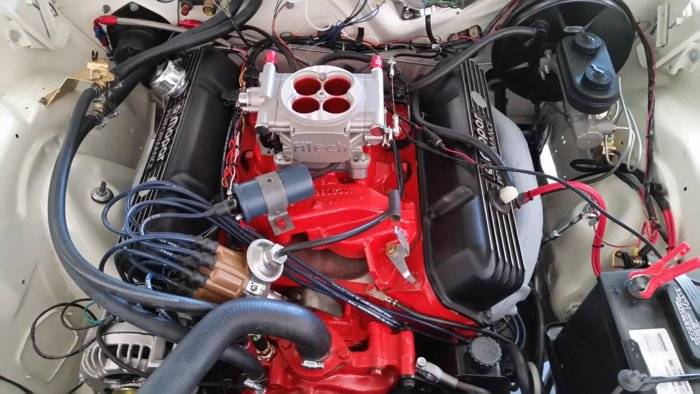

I have my 833OD setup mounted to a very stock 383 with a Fitach 3003 system fuel injection. I get 18 mpg at 70 mph. My car performs just the way I want it to perform. It is no race car.
