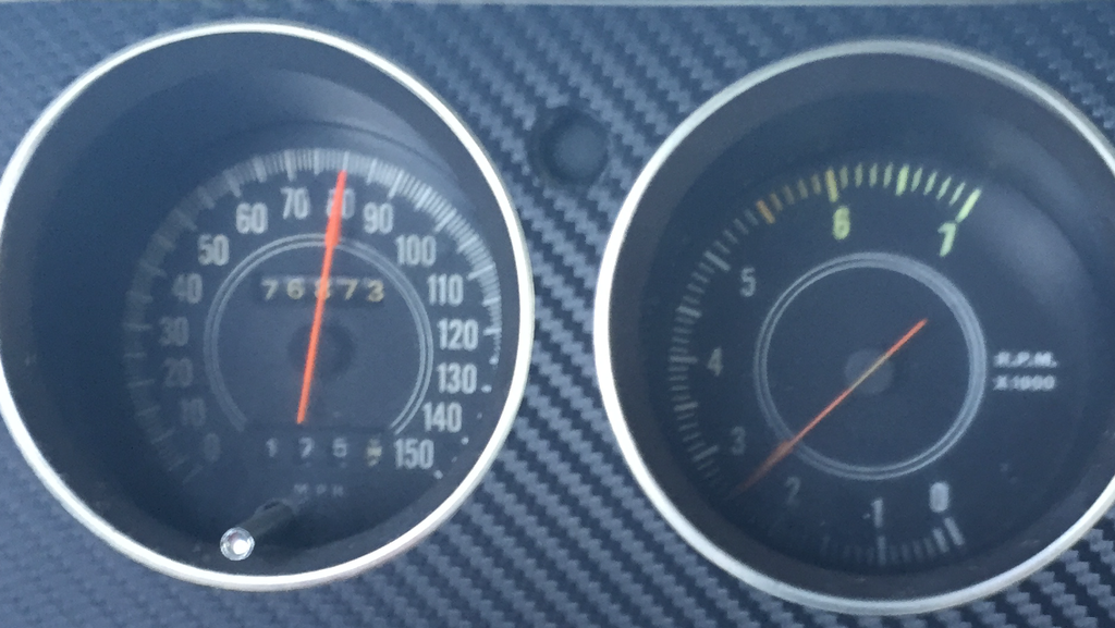

I have a 8 3/4 with a 3.23 gear and a 360 engine, stock, 727 trans, no headers. At 60 mph it revs at about 2900 rpm. To reduce the rpms, should I go to 2.76 gears or convert to a overdrive unit? I want to make this my daily driver but with the price of gas these days, I'm not sure. I drive mostly freeways. Thanks

https://postimages.org/][/url]
