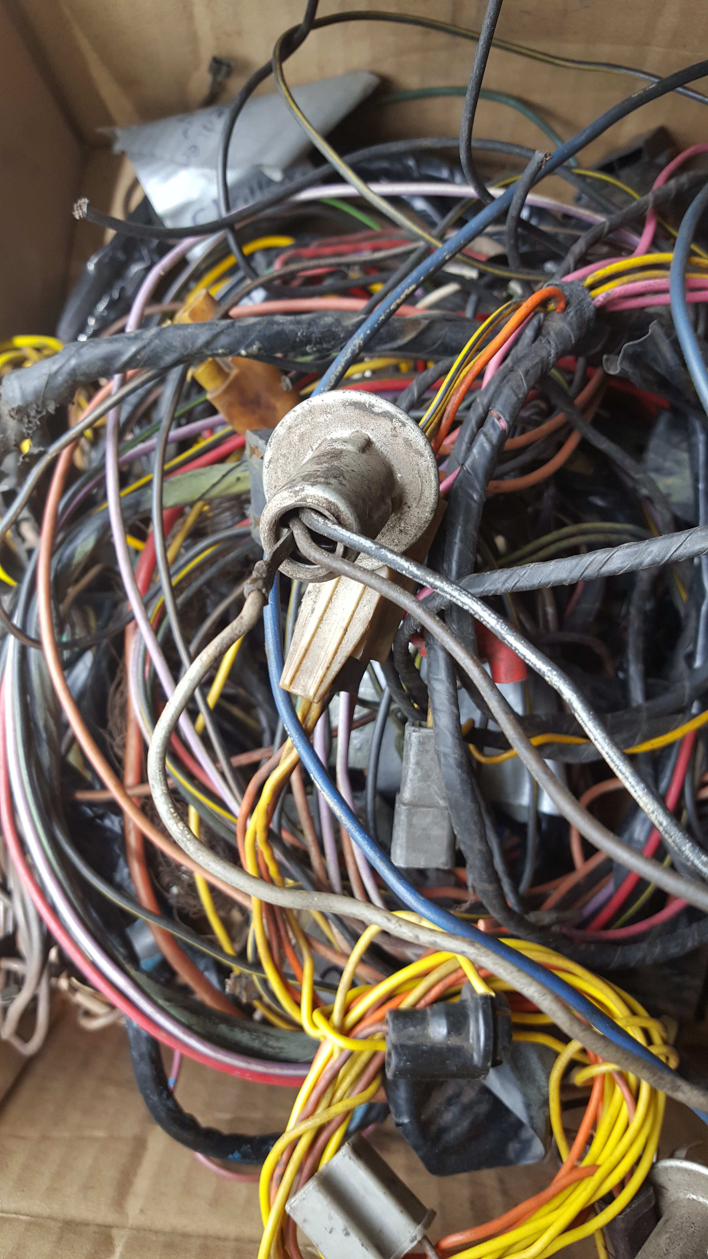

Is this what it looks like? That's a 1157 socket.
