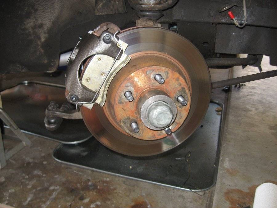

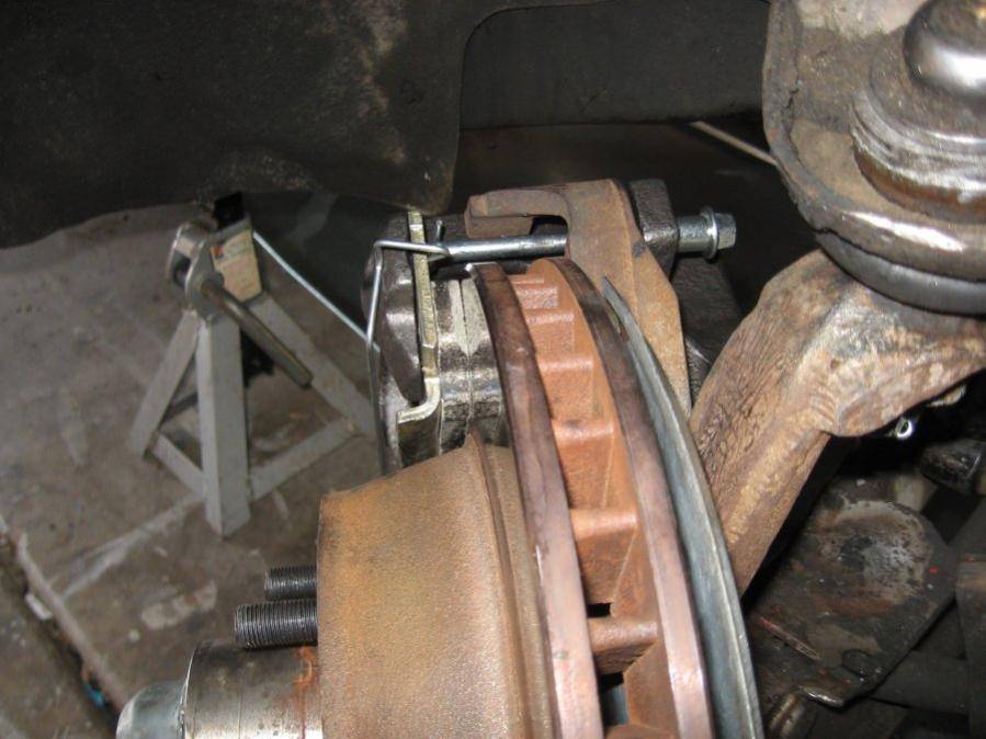

It's an anti-rattle clip. I got one too when I did my brakes. I had to find pictures to know how it mounts.

Thanks to you guys for your replies and the pics. They show me exactly what I need. No new bolts came with kit, 4 large bushings and 4 small and clips were the only metal part in kit. I might put these clips on. I drag race this car and my reaction times weren't correct. Have line loc hooked to trans brake and brakes were sticking. Put in new bushings and greased caliper contact points. Will have to wait till next season to try it out.
