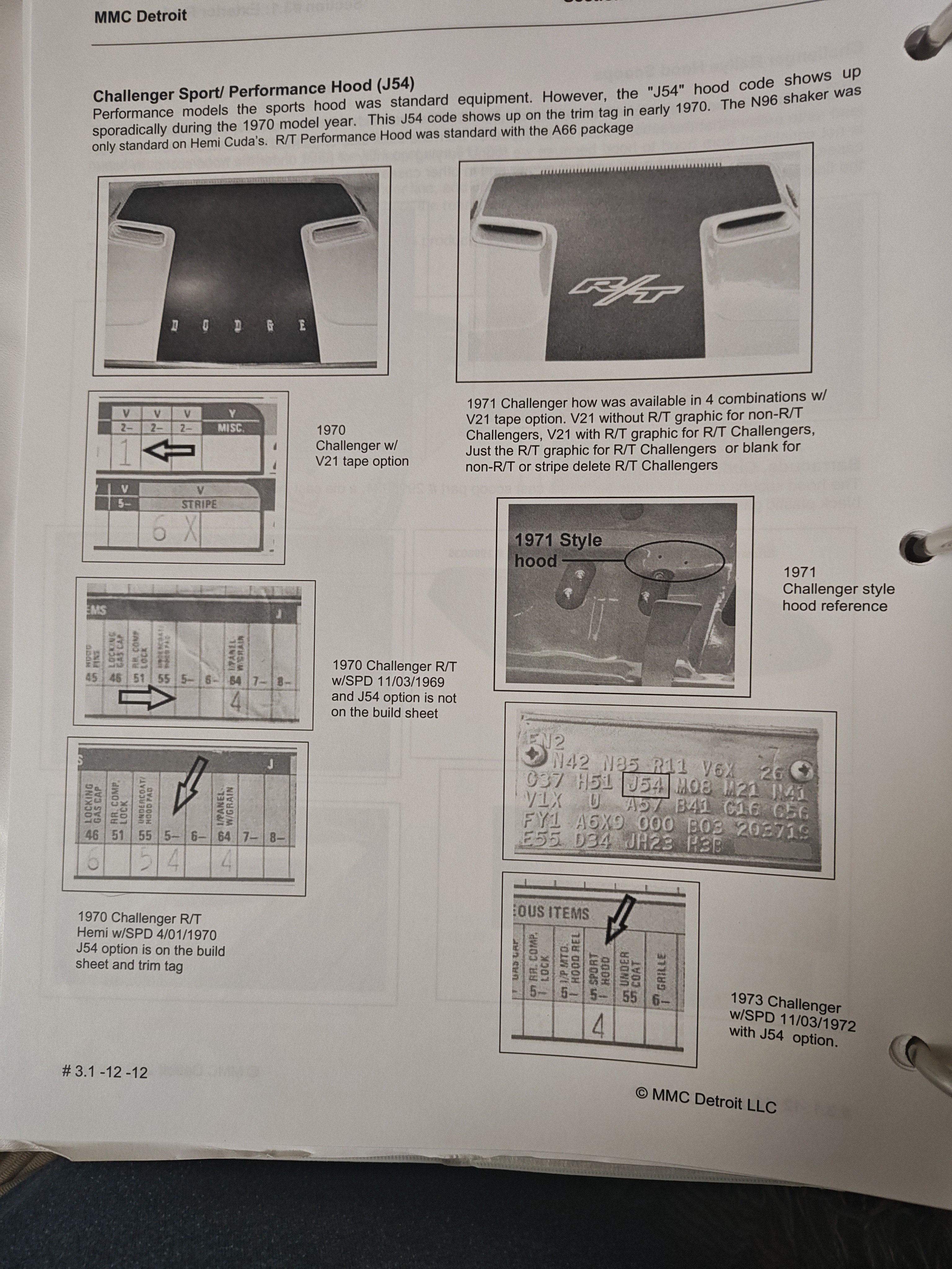

How would I confirm whether my car came with the blackout power bulge on the sport hood? Options on the fender tag listed below. Have not found a broadcast sheet. Most of remaining options are interior or drive train related.
A57- Rallye
V6X- Black Traverse Stripe
M08- Simulated Fender Louvers
M21- Drip Rail Molding
M28- Wide Sill Molding
J54- Sport Hood
V1X- Black Vinyl Roof
Y3- Light Gold
A6XW- Black/ White Interior
A57- Rallye
J54- Sport Hood
Y3- Light Gold
