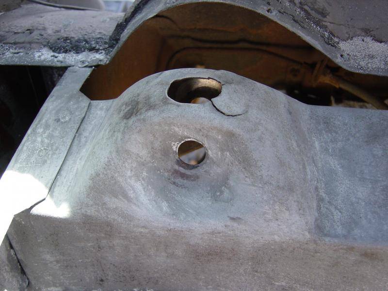

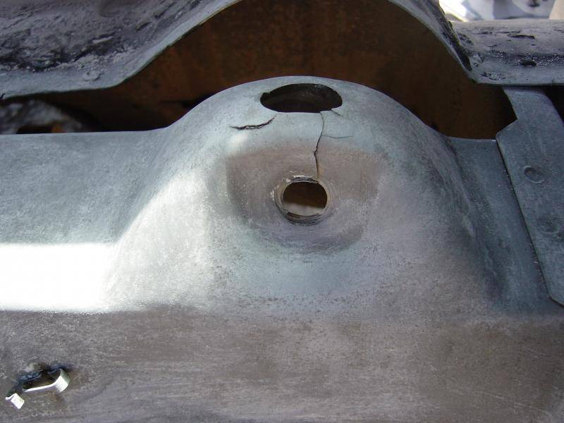

Rear shock mounts, air shocks, warning.
My 71 Challenger (91,000 original miles) had air shocks on it...when I replaced the trunk pan I found the upper shock mounts were cracked. This is the left and right side shock mounts, under the trunk pan. Look at how thin the metal is! It is not strong enough to support the weight of the car. I had to weld these up with some extra reinforcements... If you get under the car you should be able to feel around the top of the mount for cracks, or pry out the body plugs and look inside.
