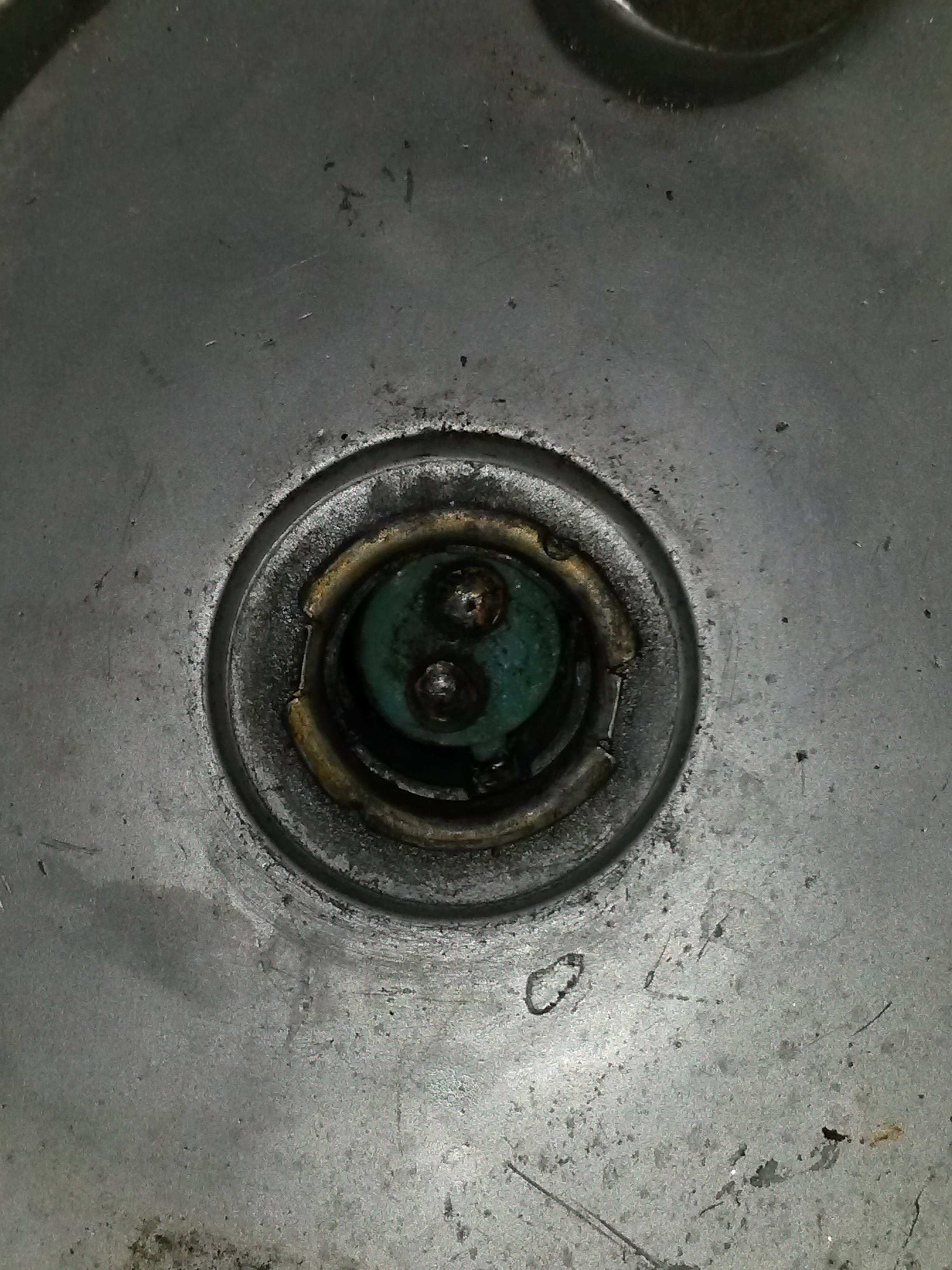

The housings front & rear ground through the body , if the ground is not good it can go through the light , so I would make sure the light housing is grounded properly or add a good ground to the housing / body
Thank you. I'll check that out. It's in the most convenient place:).

The above info is good info. The possession that I came across end up being more than one problem. You have to use a designing eye to make judgment of the problem. Needs more diagnoses to see if there is more than one problem. As mine ended up being the socket was grounding at times and the turn signal switch was going bad.The plastic insulator was cracked is what caused my issue, Phantom ground. Cause and effect?
