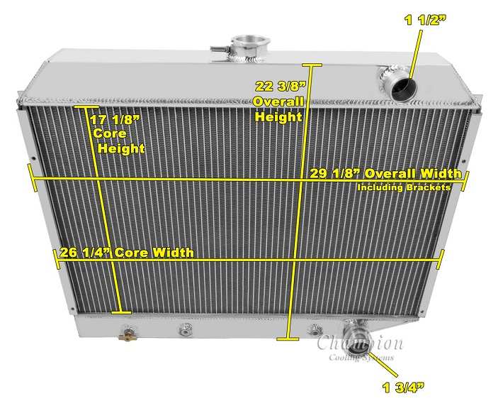

Anyone have part numbers for radiator hoses, top and bottom for a 5.7 swap?

That was a good idea using the 2016 challenger radiator, wish I had thought of something like that. I used a champion radiator with passenger side inlet and outlet. Also what exhaust manifolds or headers did you use? Same question about did stick tube.

I am using a be cool that I had with a 440. Just found one for the top passenger side in a pile of used ones at the shop. Getting a bottom hose from a grand maque that will connect to the bottom drivers side on the radiator. It's long but I didn't have to buy a radiator and fans.
If you're using an aftermarket radiator with passenger side inlet/outlet, I have the hoses below in my swap notes. Im not there yet to know if these work, so buyer beware.
Upper: Napa 9535, Gates 22940, Gates 20923 (each should have one end 1-1/2 and the other 1-3/4)
Lower: Napa 8920, Dayco 70445, Gates 20609, Gates 23036 (each should be 1-3/4 on both ends)
If you try them, let us know what works...
