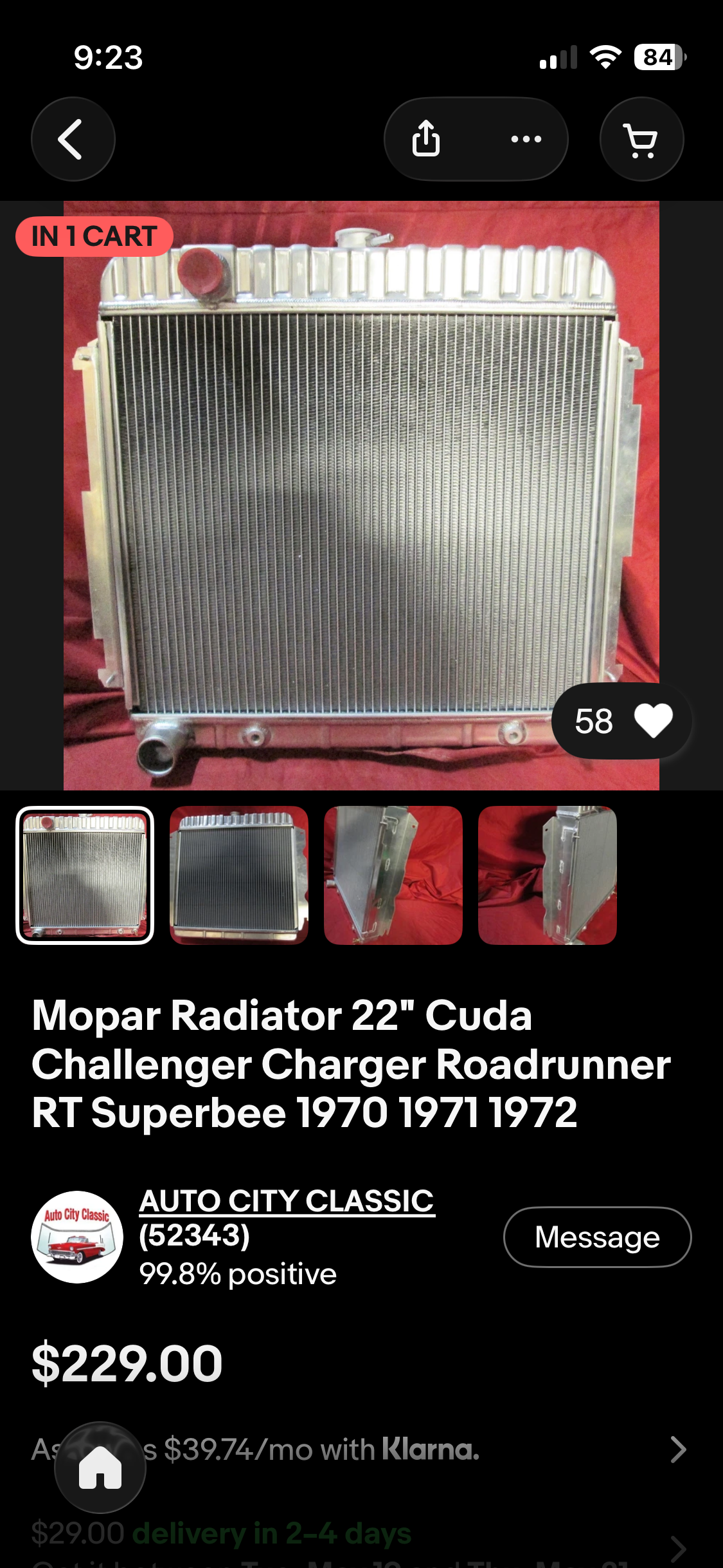

It all depends on your preference for whether or not you want it to stay stock with numbers and such. If not then modern aluminum is much better. It will cost much more to get an OEM re-cored. Not many places even do it anymore. Kind of a lost art. I got an aluminum on eBay that is stamped to look like a stock unit. The car runs cooler than it ever has

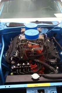

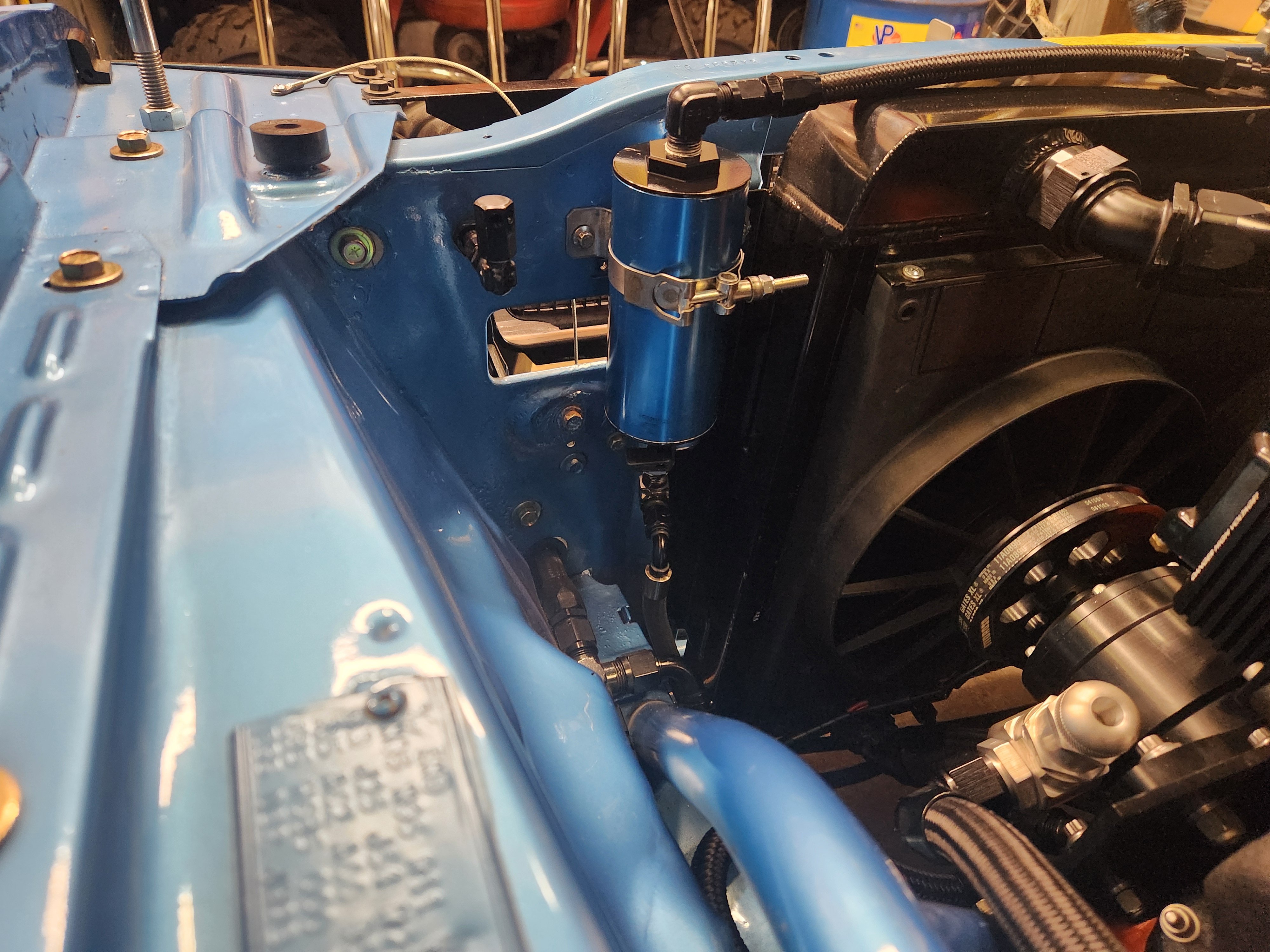

I have a custom built aluminum radiator with dual electric fans and a shroud on my blue Challenger. It runs cooler with more than double the horsepower than all of my other more stock-ish built cars with stock brass radiators and clutch fans.
@6PKRTSE you realize with your blue Challenger you're kinda in a class/world all by yourself, right? 🙂
Why is that? It is just a nice cruiser. I drive it just like everyone else drives there cars. But, thank you though. It was a long journey of labor of love building it.
