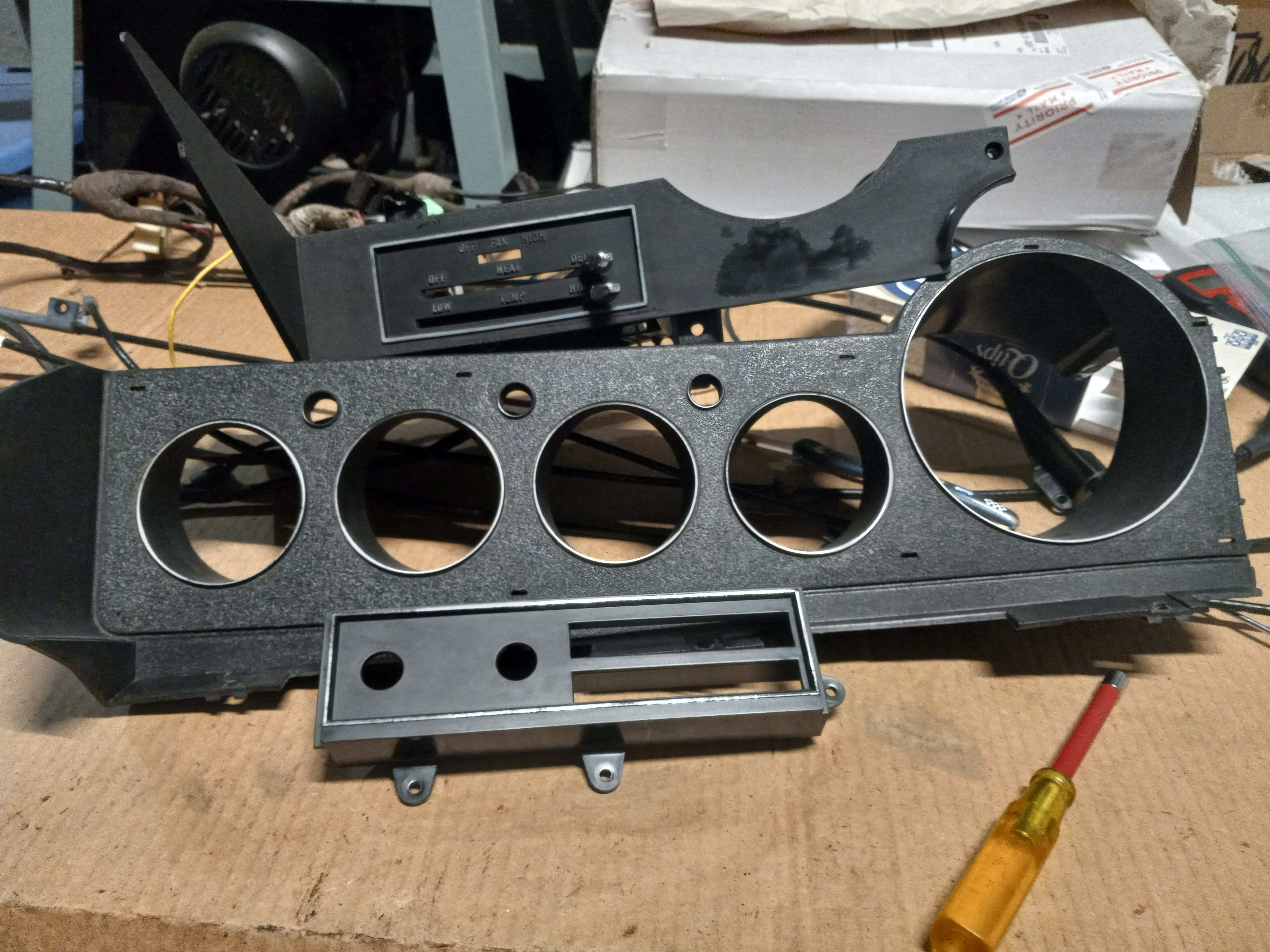

Anyone know the best way to paint the raised lettering on dash panels. Thanks

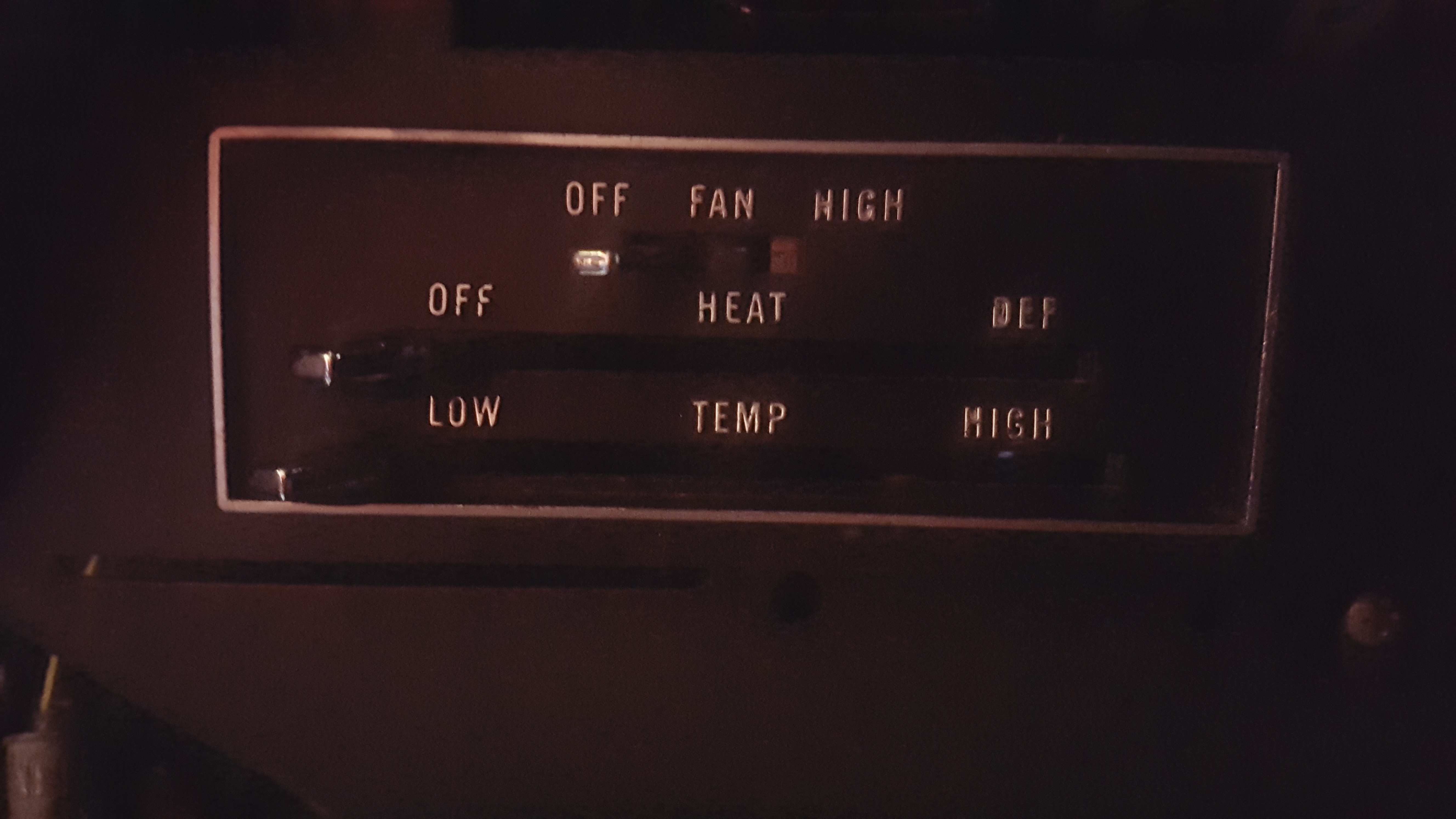

If you always had a problem color between the line you might not want to try it. No really it's not that hard. Just get the tip to dampen with paint and go over with light touch. Don't depress the tip while going over the raised area. You will be a master before you know it.

Wow, that looks great! Next week should get the paint pen. Got time to practice.
