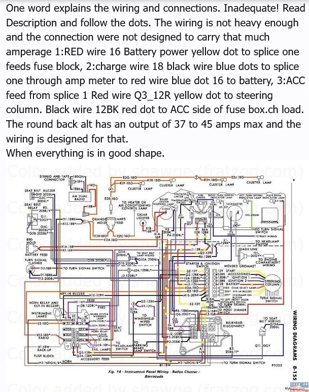

There is a little more to this. Read over the below diagram and understand and you will have a good comprehension of the major problem of the wiring. From the bulkhead connector to the amp gauge. (Myself I would do something else. ALT bypass) Follow the dotted path.
Other than that check all others for good clean and tight connections. Inspect all the connections and the end of the wire for brittleness. Same for the under steering column plug sometimes there is an issue there.
Mine has the original harness. I cleaned up and inspected the harness. Redid a few bulkhead connectors and plug connectors.
Did an ALT Bypass, headlight relay circuit (Yeah check you foot dimmer sw too.) And put a volt gauge in. The amp gauge would be ok if you want to keep it. Just reroute the Batt and ALt feeds with a heaver feed. Removing or rerouting the high current loads is the key.
As
EW1BH27 mentioned you will have to change or add a few circuits.​
