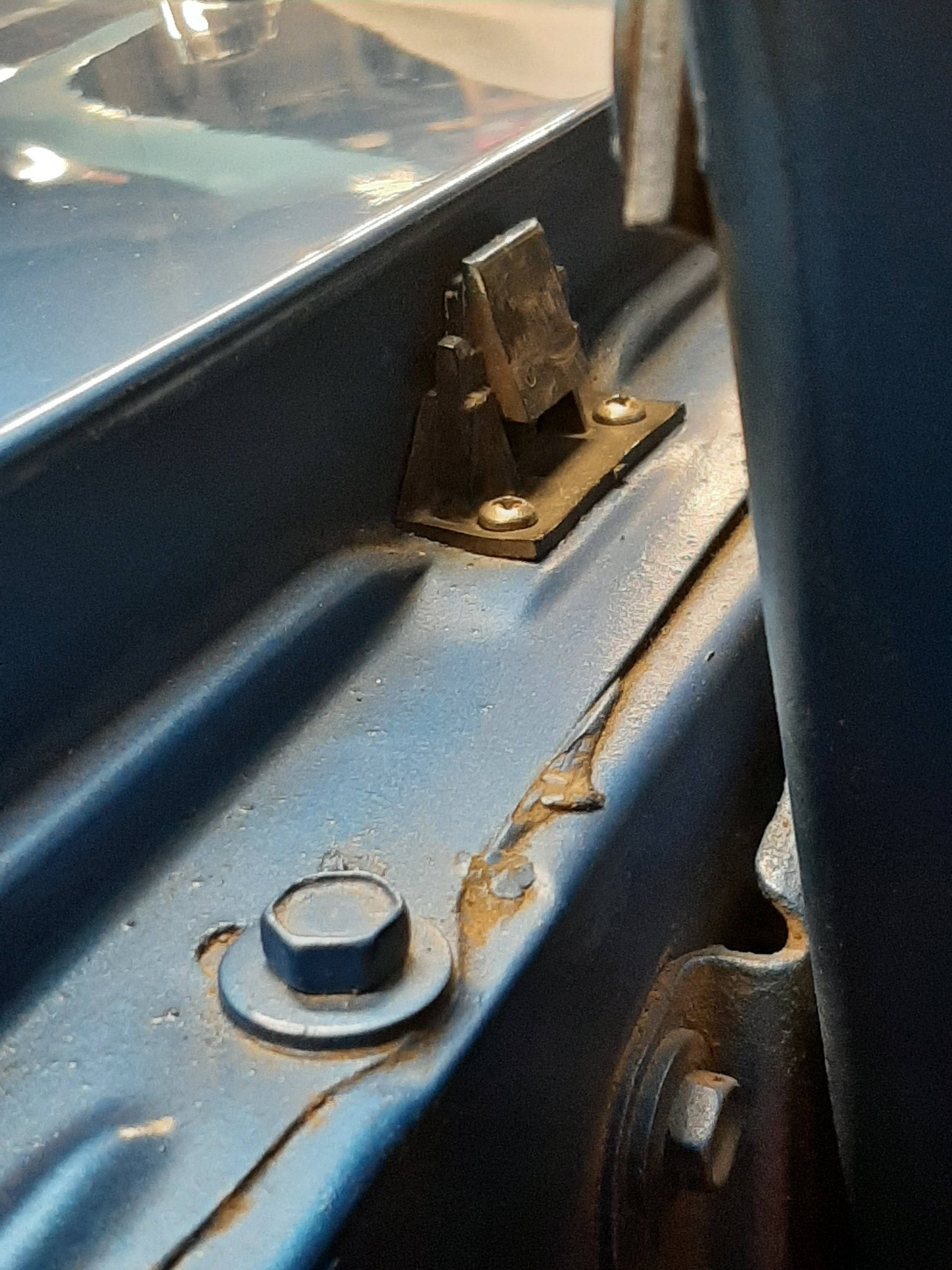

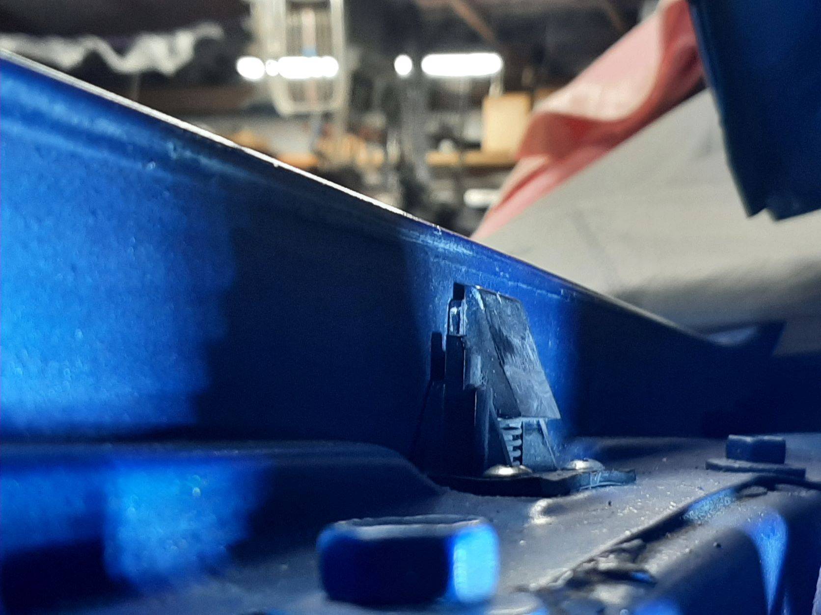

Yes, they are there and the wedges are spring loaded. I also looked at the hood where it should contact the wedges and the paint is undisturbed, like it's not even touching the wedge. Maybe I'll shim the wedge closer to the hood.
The new reproduction wedges are slightly different than originals. I've compared them and there is a difference. As you said, maybe shimming them up slightly will allow contact and help with the shaking problem.
Terry W.
Hi Terry; how about rolling two 1/4" balls of putty and place them on the wedge then close the hood to check how much the hood contacts the wedge.Question is, how much contact should there be? Completely compressed or partially ? Thanks again. Shebacat
Look at my photo and you can see where the hood contacts the wedge and you can see where the dirt is wiped off in back of wedge slot. About 1-1/2 coils down from top of spring. I'd guess wedge should be at least down 1/8 to 1/4".
