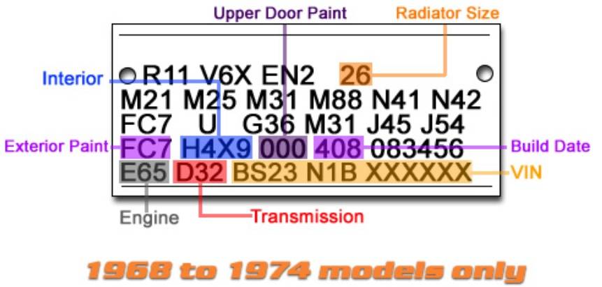

Hi everyone , does anyone know how to determine the build date of my 74 barracuda BH23G4B226212 thank you for any help
MoparCarGuy
Jun 28, 2020
505
388

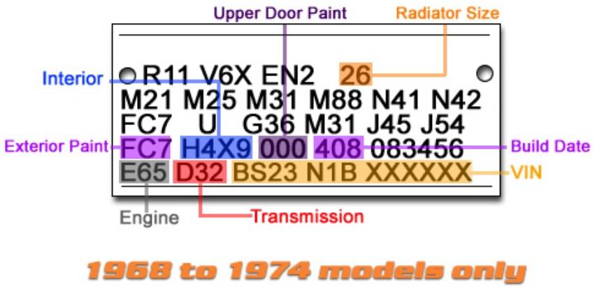

This will help you find it on the fender tag (on driver's side inner fender area). Three characters with first character equaling month (8=AUG, 9=SEP, A=OCT, B=NOV, C=DEC, 1=JAN and so on) and next two numerals equalling the day of the month. This is officially called the Scheduled Production Date or SPD but many say the Build Date. It is a scheduled production date, not the exact day of assembly line completion which can be off by many days or even a few weeks.
Post your fender tag and we can comment further on your car's specifics.

I collect fender tag pictures posted on FEBO, E-Bodies.org, and the rest of the InterWebs. Many other members here do the same.
My collection focuses on 70-71, some 72, and very few 73-74 Barracudas and Challengers.
I checked your BH23G4B226212 against the limited number of 1974 tags I have and could only bracket your VIN to between B02 (02November tag BS23G4B191665) and 207 (07February tag BS23L4B324981).
Hopefully, others can get somewhat closer to the possible build month.

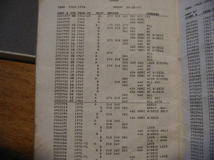

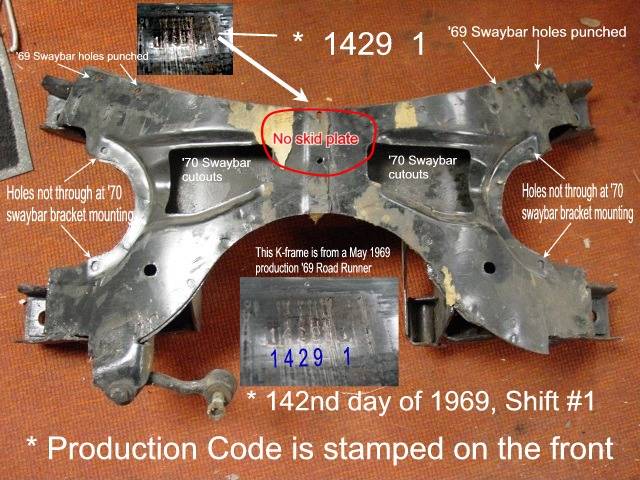

Here is a tidbit of info from an other member. an example of date coding to look for.
Jun 12, 2022

Just a partial list of the parts I recorded dates from!
1970 Challenger A66 Convertible
Scheduled Build date A06= Oct 6, 1969 Monday
Brake caliper bracket RT
267-9 = Sept. 24, 1969 Wed
Brake caliper bracket Lft 279-9 = Oct 6, 1969 Mon
Collapse Spare L/9 9~17 = Sept 17, 1969 Wed
Control Arm Lower Rt 921 & 274 274 day 1969 = Oct 1, 1969 Wed
Differential (yellow stencil assembly date) 295 = Oct 22, 1969 Wed
Glass lft rear (non tint) 2699 = Sept 26,1969 Fri
K Frame # 2962012 2939-1 = Oct 20, 1969 sft 1 Mon
Radiator #2998974 2359 = Aug 23, 1969 Sat
Radio Speaker # 2894778 2939 = Oct 20, 1969 Mon
Rugs JP Stevens 1667FX8 = Oct 11, 1969 Sat
Window lft rear L-9 9\17 5.5 = Sept 9, 1969 Tues
Delivery Date North Plainfield Dodge = Nov 17, 1969
