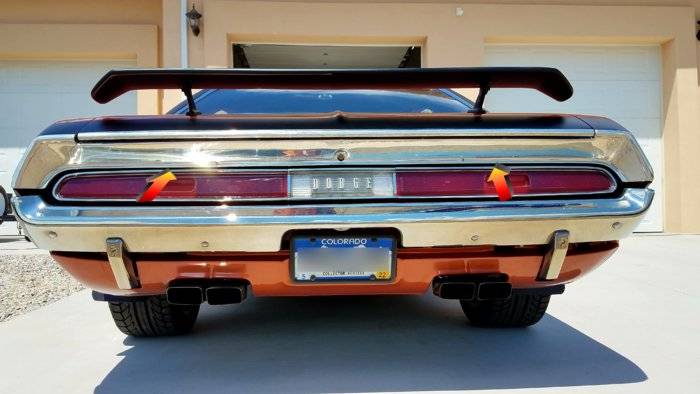

Well I finally have a moment, in life, to take a breath and stay home and close to my Challenger for a week or two. I am in the process (still) to wrap up replacing the taillights and taking a long hard look at this rear brite panel in the photo. This panel has a few small scratches on it and could stand a little professional metal buffing. The only thing of it is, I don't like taking caution and throwing it into the wind. Just in case there is a Murphy Moment, I like to know if there is a replacement out there...somewhere.
This has led to an exhaustive amount of research resulting in nothing. I am convinced, I have been pushing all the wrong buttons, in my search and have been calling it something other than the correct item. So help me out and please tell me what the heck this panel is called and where I might be able to find a replacement...

SE tail panel, they came from the factory with argent paint on them. 1970 only I think.

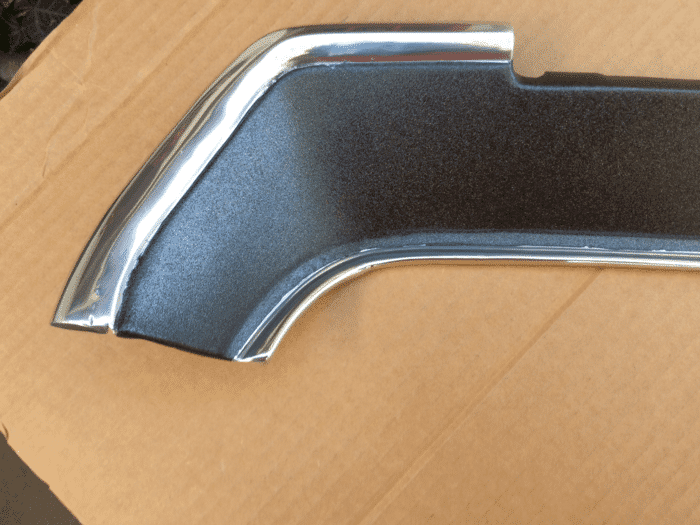

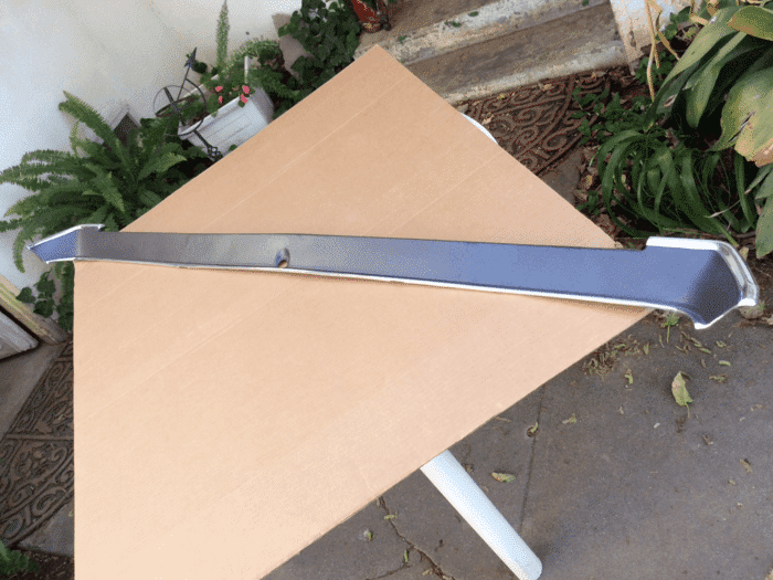

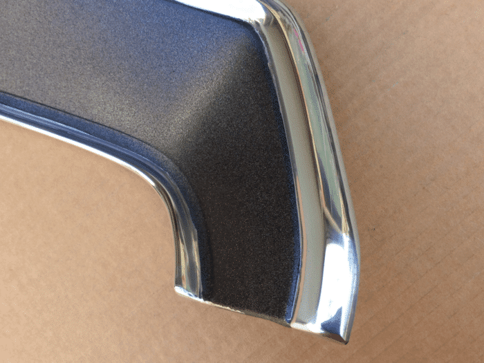

Wedg2go.........a lot of the replies you got here on info about your rear finish panel, is good info. It is a ‘70 Challenger SE/WSS only coded A63 on your fender tag (of course that doesnt mean that it could not be ordered or put on the vehicle by a purchasing buyer or a dealer). Part of the SE/WSS trim package, I have seen them polished out like yours and painted an organsol black, but normally a dark Astro tone gray. My own ‘70 Slant6 Challenger is in WSS trim and has this option, the dark gray finish. They can be pricey if found on line, as you’ve been told. The pics are my extra one,for an example. This OEM piece was professionally restored.

The whole panel was hard anodized originally and the inner section painted over that. You can't buff it.
