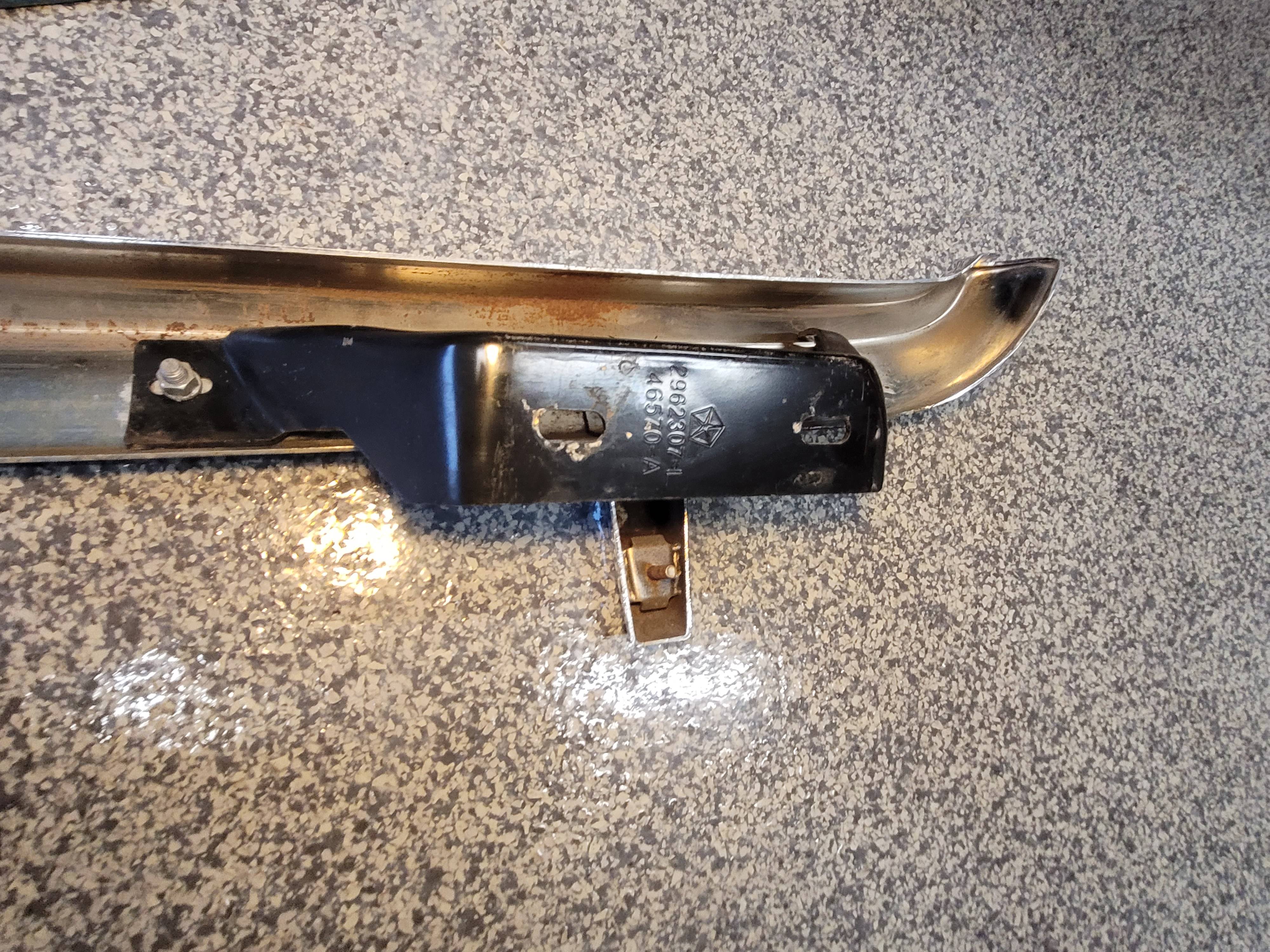

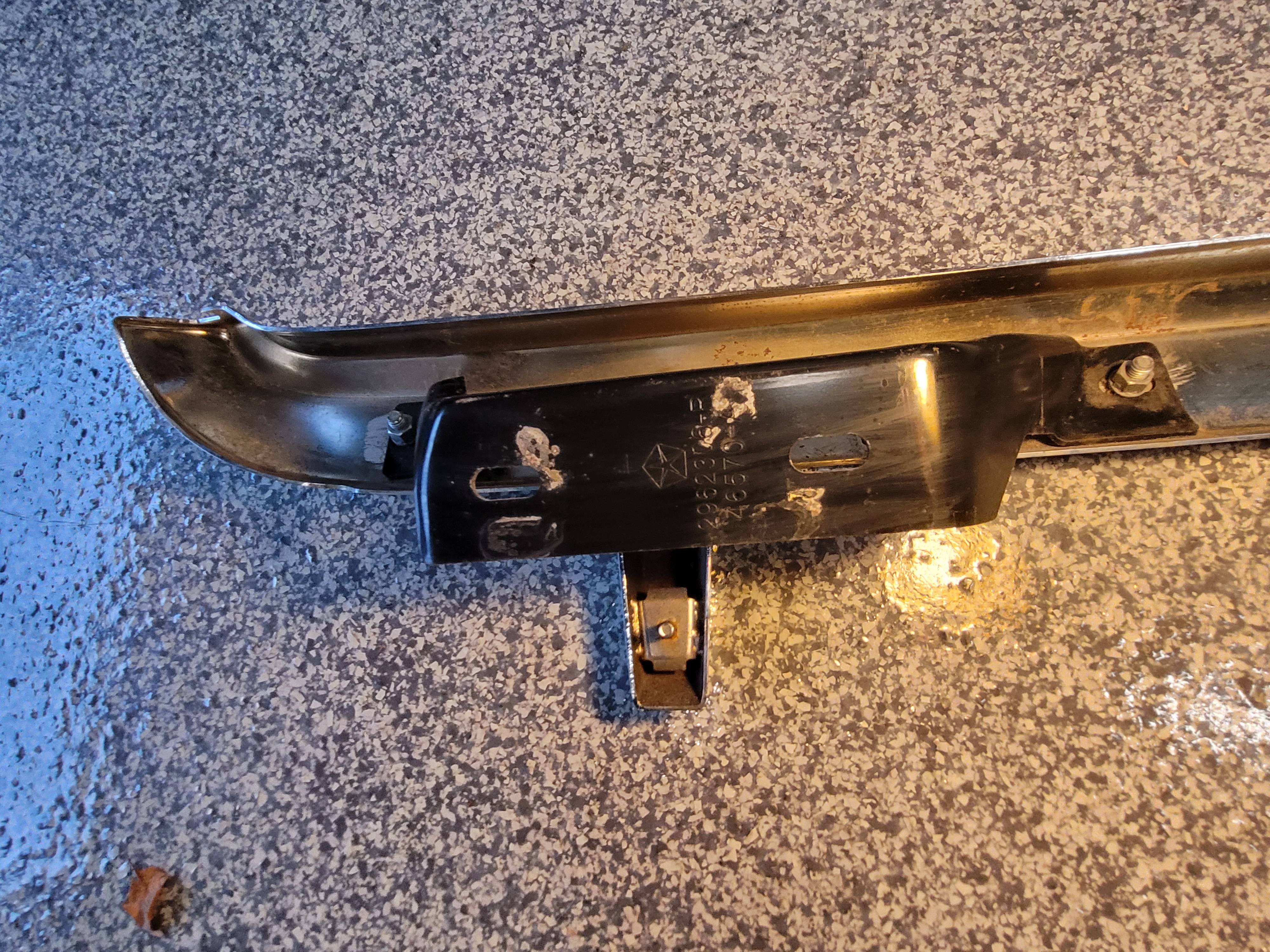

Jul 3, 2026 #1 G gran coupe john Well-Known Member Joined Aug 15, 2023 Messages 931 Reaction score 277 Location Ohio Having issues installing the bumper guards for my 71 gran coupe. Anyone got a pic how the bumper guard brackets are installed.

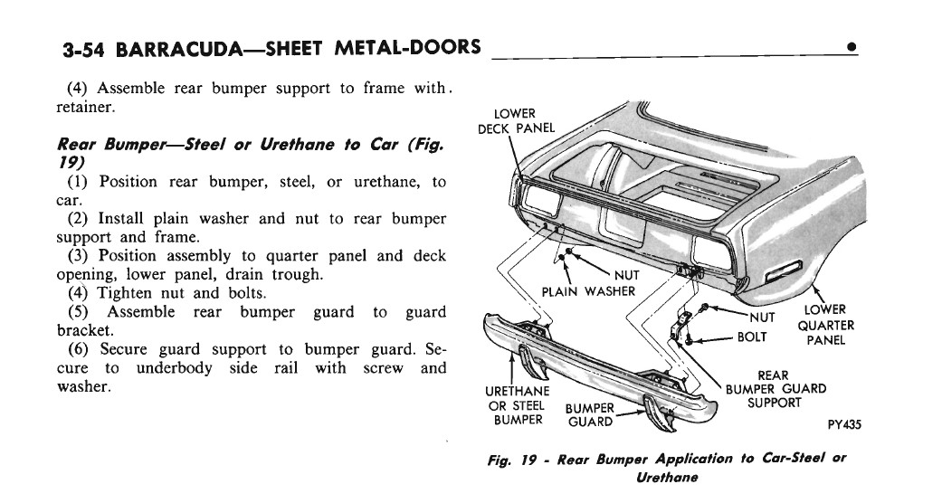

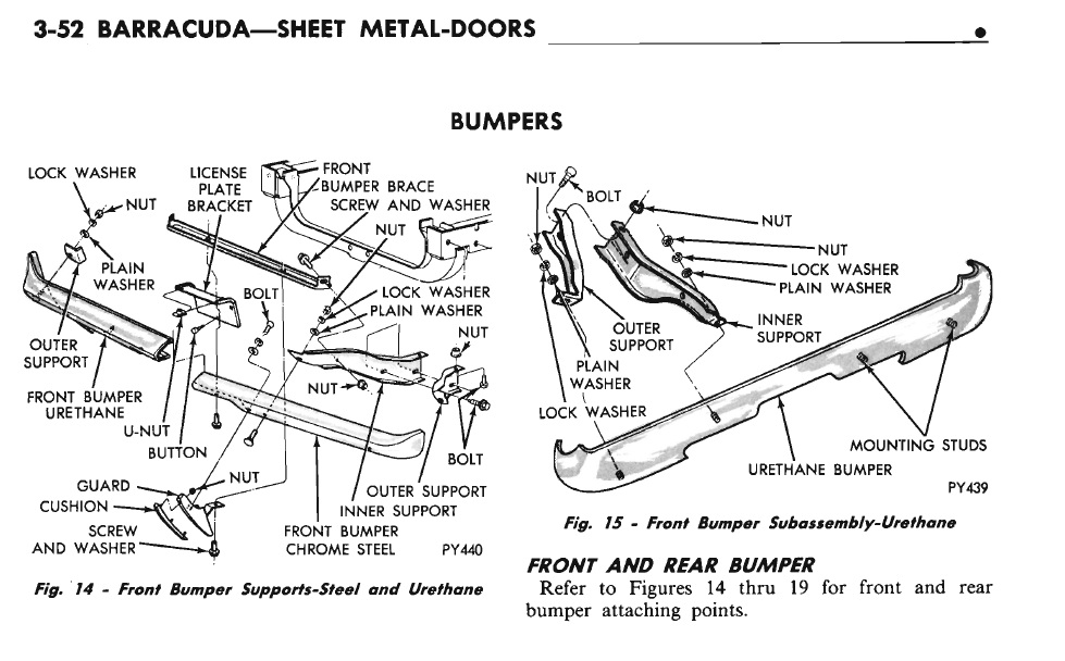

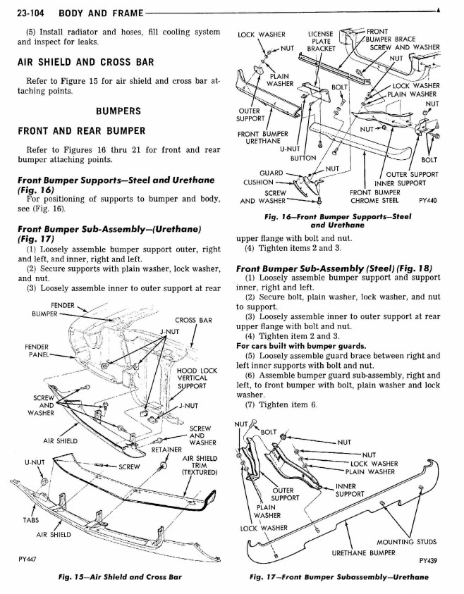

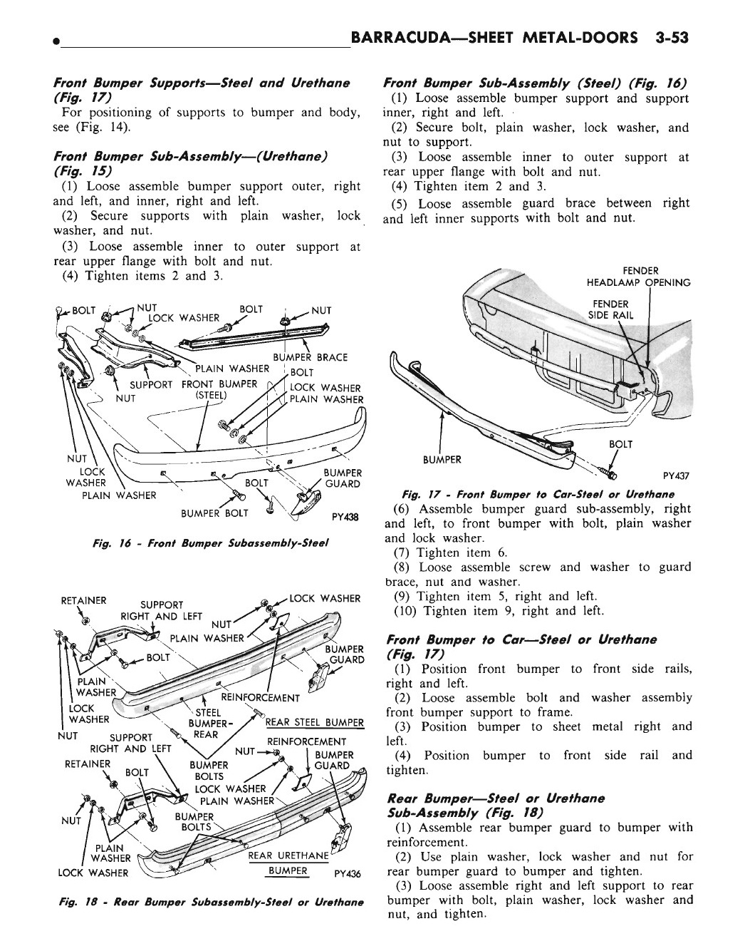

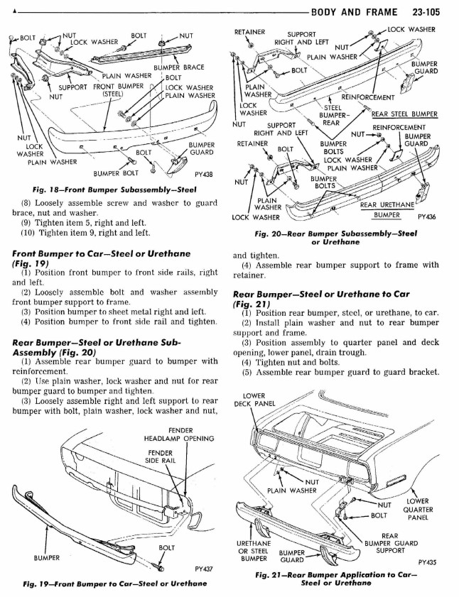

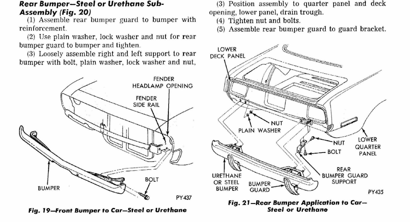

Jul 4, 2026 #2 MoparCarGuy Well-Known Member Joined Jun 28, 2020 Messages 1,068 Reaction score 1,048 The 1970 Service Manual has diagrams. 1971 may be similar. Check the 1971 Plymouth Service Manual to find out. LINK to Service Manuals for download 1970 diagrams below.
Jul 4, 2026 #3 MoparCarGuy Well-Known Member Joined Jun 28, 2020 Messages 1,068 Reaction score 1,048 Extracts from the 1971 Plymouth Body Service Manual (pp3-52 thru 3-54).
Jul 5, 2026 #4 G gran coupe john Well-Known Member Joined Aug 15, 2023 Messages 931 Reaction score 277 Location Ohio Thanks, for all the diagrams! Front was easier than I thought. Backend was a b___h. Still got it align. Thank you all for your help
