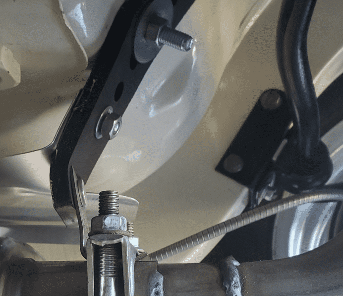

Shortly after rebuilding my car I got a clunk or rattle in the rear end. clunk or rattle sound depended on how bumpy the road was. What I found was one of the rear antisway bar bushings had walked out of the clamp. This did not happen right away, took a couple hundred miles for the bushing to migrate out. Fix was to add a shim to get more clamp up compression on the bushing.
gran coupe john
Aug 15, 2023
665
178
Ohio
The coupe has no antisway bar. Maybe that is why it rattles. Probably did come with them and never put them back on through the years?
