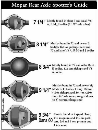

May 16, 2016 #1 S scottylack Well-Known Member Joined Sep 11, 2009 Messages 88 Reaction score 8 i have a 70 convertible. Stock. What rear would be in it. Car has never been touched!
May 16, 2016 #2 DetMatt1 Well-Known Member Joined May 13, 2009 Messages 8,132 Reaction score 2,247 Location Metro Detroit If there's no removable cover on the back it's an 8.75.
May 16, 2016 #3 S scottylack Well-Known Member Joined Sep 11, 2009 Messages 88 Reaction score 8 Thanks!
May 16, 2016 #4 S scottylack Well-Known Member Joined Sep 11, 2009 Messages 88 Reaction score 8 It would be a 7 1/4?
May 16, 2016 #5 challenger6pak Well-Known Member Joined Feb 27, 2011 Messages 4,087 Reaction score 923 8.25 most likely.
May 16, 2016 #6 S scottylack Well-Known Member Joined Sep 11, 2009 Messages 88 Reaction score 8 Ok. And 8.25 have a removable cover as well correct?
May 16, 2016 #7 challenger6pak Well-Known Member Joined Feb 27, 2011 Messages 4,087 Reaction score 923 Yes.
May 16, 2016 #8 Moparparts Well-Known Member Joined Nov 15, 2010 Messages 1,067 Reaction score 45 I had 2 different 70 Challenger convertible 6 cyl cars they both had 7 1/4 from the factory I still have the one rear here if someone needs it, it is available Last edited: May 18, 2016

May 17, 2016 #9 S scottylack Well-Known Member Joined Sep 11, 2009 Messages 88 Reaction score 8 Mine too
May 17, 2016 #10 S scottylack Well-Known Member Joined Sep 11, 2009 Messages 88 Reaction score 8 Yes mine as well
