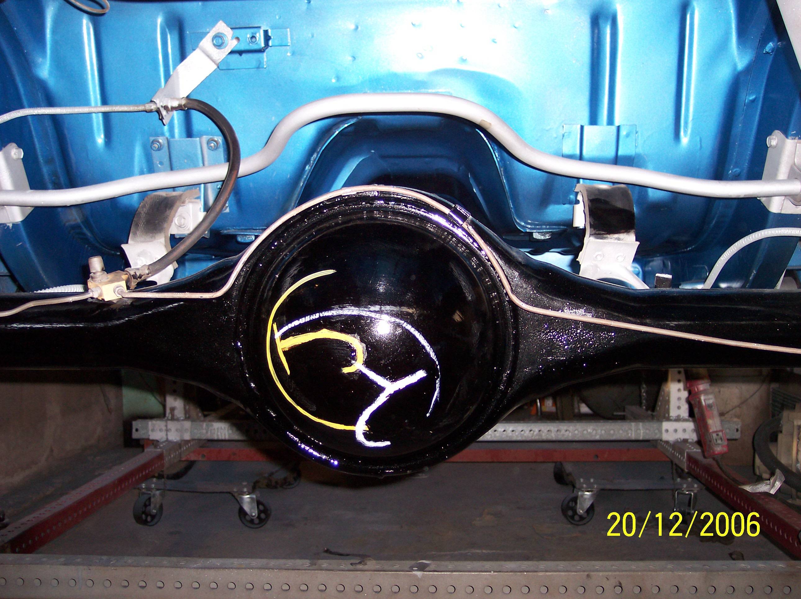

Factory rear bar was a def improvement on mine.
I got it to clear the TTI 3" pipes too. Close tho'.

Is this a factory sway bar? Thanks
That looks the same as the factory one on my '74 - not sure about diameter but the shape and mounts are same as mine were originally. I modified the bushing mounts as the original factory ones were not designed to be serviceable and I wanted to put on new bushings
