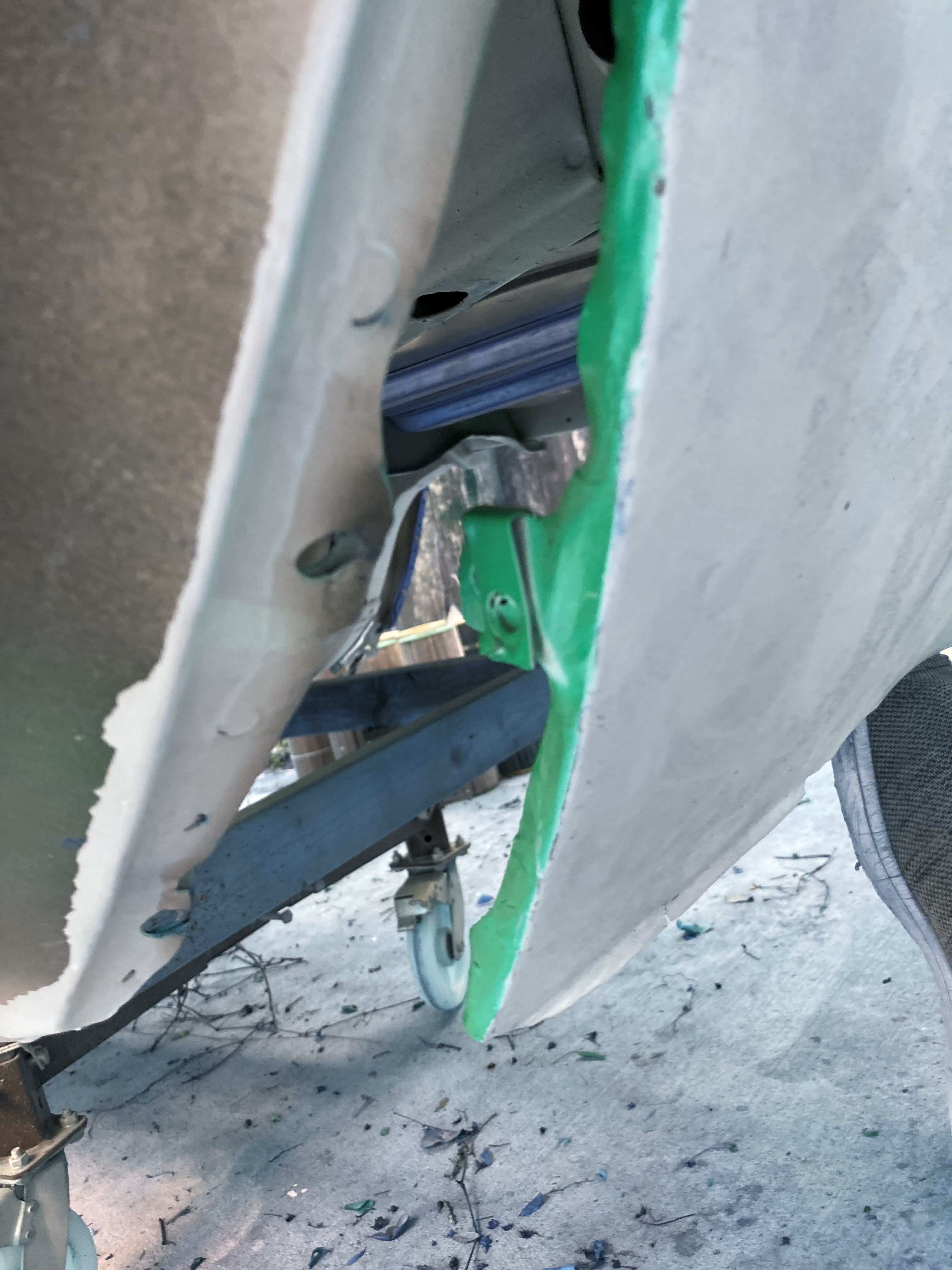

Rear Valance installation. Do I need to bend the quarter panel upwards to match the rear valance on the Cuda? Sorry about poor picture. The quarter panel is on right and valance is on the left. Looks like if I bent the quarter panel 90 degrees everything would match up.
Thanks for help.

I'm going to guess you installed a new 1/4. I removed my rear valance and remembered I had to tweak it a little for a better fit,even though it was original.
i’m doing the same deal now . new everything, as in your pic the tab on the valance has to be matched to the quarter, and yes we has to tweek them to make match …
Thanks, I just took the doors and fenders off, put back on rotisserie to seam seal and paint underneath. I also doing the tweeking of rear quarters to get valance to fit while accessibility is easy (onside).

I had new quarter skins but the valence was a touched up original (from another car) - my tweaking was mostly on the quarter and yes it needed a good bit
